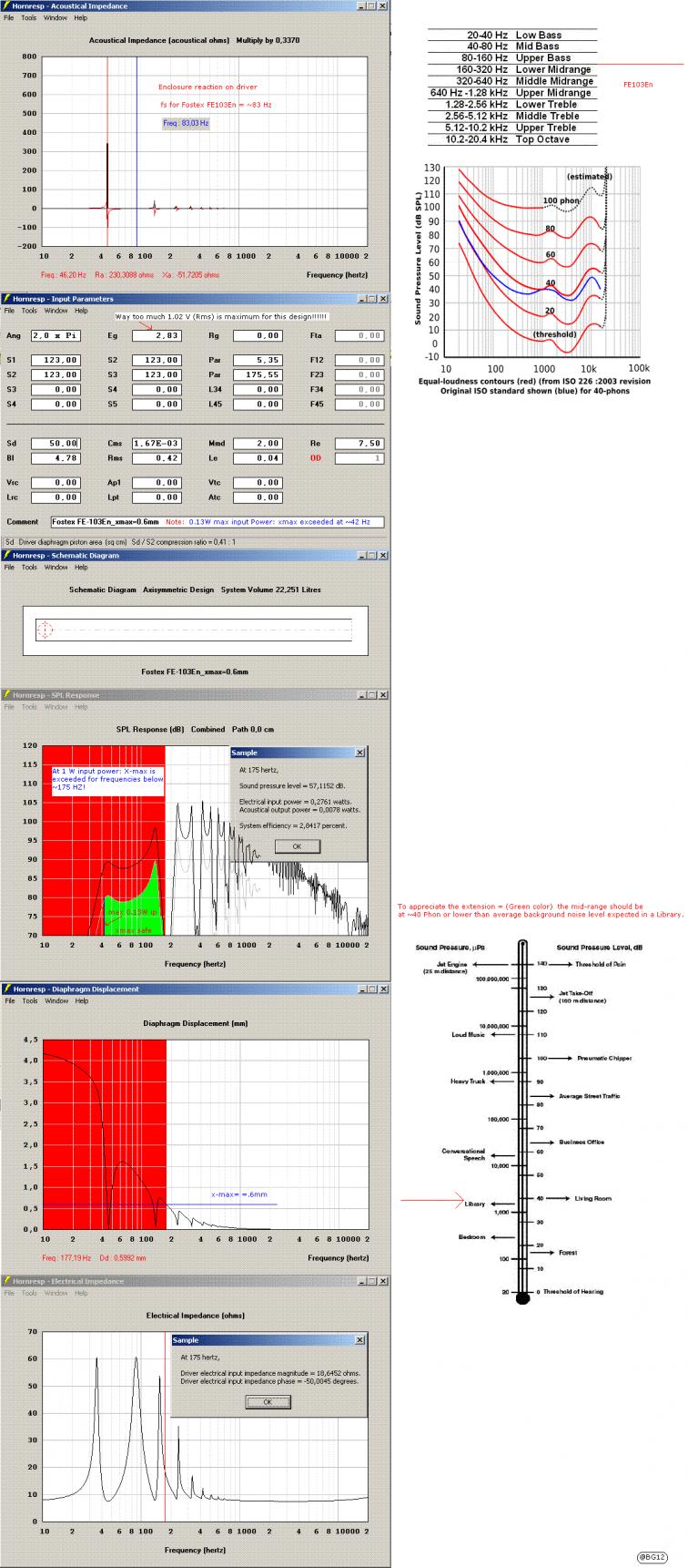

I have made an estimation of the dimensions of the Hexibase Fostex Fe103En TL and here you are (in cm):
External Height: 90-100 cm
Internal width: 12.3 cm (+- a few mm)
Actual tube cross section: 10 x 12.3 cm (S=123 cm2)
Tube length: 180 - 200 cm
Tuning frequency: 41-47 Hz
Volume (internal): 22-24.5 liters
I've spend some time before arriving at those dimensions and I'm pretty sure they are correct within those limits.

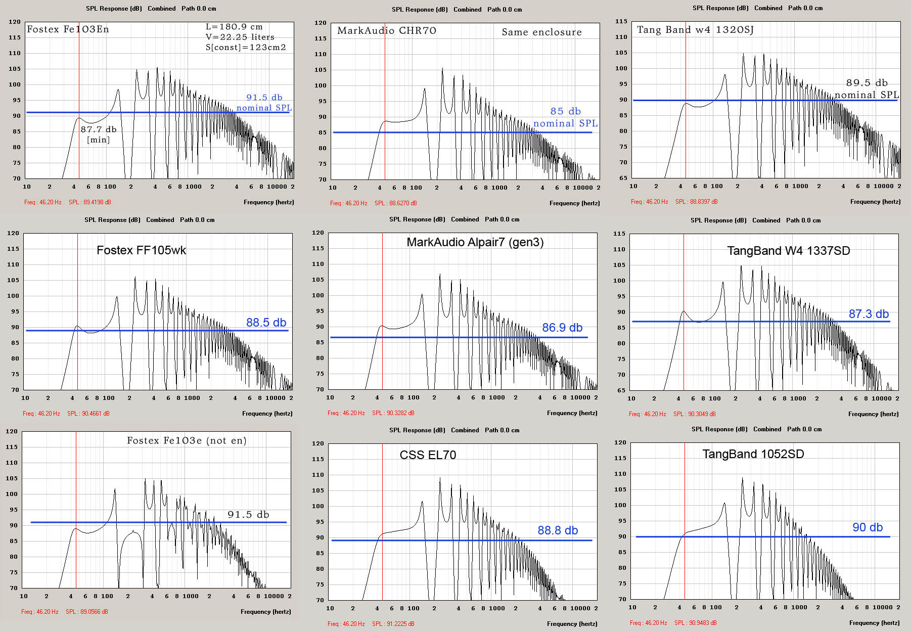

Some simulation I've done with 9 different drivers in Hornresp - the nominal SPL is the one calculated by the software not the one from the specs; all are done for the same enclosure. The general rules are these: the best drivers are those with Qts of 0.4-0.55 and Fs bellow 80hz; Vas gives you the volume of the enclosure (how big the section of the pipe must be). Large Vas can be a problem, for example TangBand W4 930SF needs an extra 10 liters to be ok because of the higher Vas.
MarkAudio CHR70 has the strongest bass and overall best behavior off all these drivers - needs a small enclosure, is cheap and good bass/Xmax, good reviews in general.
I would be curious to see how CHR70 looks in MJKws simulation for this enclosure.

I forgot to say that the enclosure I used for those sims needs some adaptation for each driver, the purpose was to show how big the difference can be between one driver and another and that Fe103en is perhaps the worst choice among drivers of it's category (price, size, quality). And another thing - the tremendous nuance of the sound in the video may be related to room modes around 50hz or some king of distortion (working under fs?) because there seem to be other sound in there too (just reverberation?), but the bass is stronger around 50hz than in the original recording.
Fe103en - Fs=83, Qts=0.33, Vas=5.95, Xmax=0.6
FF105wk - Fs=75, Qts=0.41, Vas=4.8, Xmax=1.7
Fe103e - Fs=79.5, Qts=0.36, Vas=6.9, Xmax=0.35
CHR70 - Fs=65.4, Qts=0.55, Vas=5.17, Xmax=4
Alpair7 (gen3) - Fs=70.9, Qts=0.54, Vas=4.58, Xmax=4
EL70 - Fs=64, Qts=0.55, Vas=6.1, Xmax=4.5
W4 1320SJ - Fs=75, Qts=0.35, Vas=6.41, Xmax=3
W4 1337SD - Fs=70, Qts=0.37, Vas=4.86, Xmax=3
W4 1052SD - Fs=70, Qts=0.44, Vas=7.58, Xmax=3.4

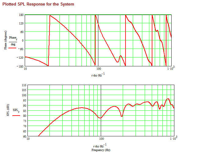

You are saying that Xmax will prevent reaching that SPL? I don't think it's that bad - Xmax is the maximum excursion available before you start having compression of the dynamics, in other words they will start to become more compressed, less powerful, but I don't think it's much off an issue, Fostexes have been known to be tolerant with this; xmech is much larger. It's not the best design in the world, you have horns for low xmax drivers, and these Fostexes aren't good at all for this design; however you can take a look at the video that started the thread and hear them in action - My Other Listening Room - YouTube
bjorno posted what i was wondering about the cone excursion. the Xmax would run out long before you got down that low, so can't imagine its going to sound that great.
so what i can gather the el70 is a far better driver to get a better output of bass and i just calculated with winisd that it will do 40.01hz at -3.8db in a 17 liters bass reflex enclosure
