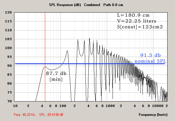

I don't have access to the M.King MathCad worksheets but I can show you what Hornresp shows in simulation. In the image there is a 46hz tuned TL which might be slightly different than the one build by Jameslc but it's the design I would chose, why? no need to go under 45 hz. But that's not the whole story... the simulation shows that you loose 2-4 db from the nominal SPL which is not good and I must add that there are other factors that may contribute to weak bass - mostly the placement of the terminus far from the floor or ceiling; in the video you can see that one of the enclosures was relatively close to the corner of the room, and both where in the immediate vicinity of the back wall (practically almost in contact - My Other Listening Room - YouTube - at 1:20). Another thing that may have an effect on the overall tonal balance is the distance to the listening position, in this case probably in bed which may be far enough to loose some of the highs, and being close to the opposing wall the bass might be stronger.
And if I got this far, here is what I thing might be a better idea: either you make a version of the enclosure with a driver offset of 0.2-0.3L and place the terminus in the back, basically you just put the driver in the back of the enclosure at 0.2 offset or move the terminus down as if it where on a chain the obtain the correct offset, or even better, design an enclosure that would for sure have enough bass, with the terminus near the floor, use expanding geometry etc. But since hexibase knows what he is doing and in both designs I showed earlier (the one in the video and this one Ok, I lied. Here are a few pics of my “almost” most recent build | MiltonBilt ) don't have expanding geometry or floor/ceiling loading it might work.
Theoretically it is thin in the lower end but then again I don't have one in my house, Jameslc has a pair, he might confirm or not what the simulations indicate.
A TABAQ style enclosure can be designed with the right tool (MJking's worksheets) that might be simple to build, column shaped, and probably with the same external dimensions as the original, but with the terminus/port where it should be.

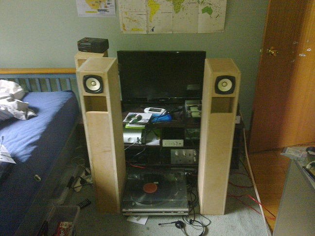

i can back up what krakatoa is saying it is very thin in the lower end from what i can judge with the human ear. i have relocated them into simular set up thats in the video with being in the corner of the room and after doing that the bass was strong but with this design there is stuff all SPL which makes it sound like it isn't much bass but after saying that i am happy with this design but i wouldn't mind getting another pair of fostex and placing them vertical on the top of the box or directly opposite the front pair just to see if it improves the bass to make it less thin then it is now
I don't like filters of any kind but people usually use baffle step compensation filters with fullrangers. I presume you haven't used any since you haven't mentioned it. Maybe that is your problem, too much sound over baffle step limit (300-700 hz region).
i presume by a baffle step compensation filters you mean sound damping material but i reacon i'm wrong anyway i did put some stuffing into the box's and it made next to no differents at this point it might be a good idea to step up in driver size in order to get more bass but that doesn't mean i'm happy with the 103en just think that more will be achieved going up in driver size
i presume by a baffle step compensation filtersyou meansound damping material
Nahh its an eletrical filter that attenuates frequencies above a certain point by 3db. When the size of the baffle is small compared to a quarter wavelength (if im not mistaken) of the reproduced frequency. At that point the sound goes from radiating into hhalf space (forward) into full space (all around) and therefore sounds quieter. To combat that you put the filter above the baffle step (that wavelenght) make the response flatter over the whole range.
Basically, the effect is boosted bass. I dont like to do this because it can cause over excursion issues, I generally try to wall or corner load the speakers to make it unnecessary or when needed add a bit of eq from my computer. It's easier and more flexible, but not everyone uses a source with adjustable eq...

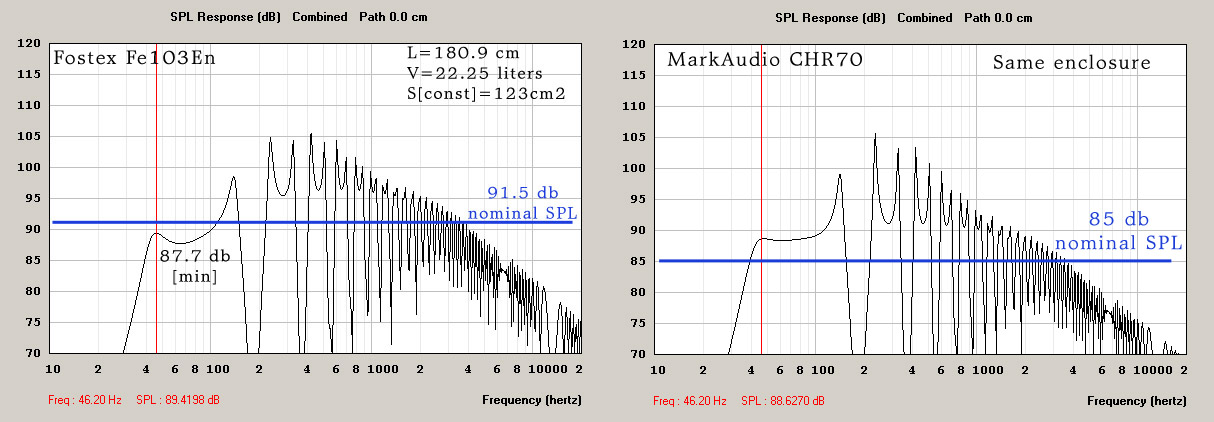

The next thing is to use a different driver that has a higher Qts, a more excursion (xmax) or lower fs - these are the reasons for which you don't have much bass. As I said before MarkAudio CHR70 looks much better for this kind of enclosure (type and deep bass extension). You trade off sensitivity (4-5db). As I can see you don't know much about the theory - Loudness and Speaker Sensitivity - diyAudio - just in case you don't know what I was taking about. And another thing, aluminium cones (CHR70) don't sound in the same way as paper cones(Fe103En).
What I'm trying to say is that you do not necessarily need a larger driver, even though a larger driver will tend to have more bass, it depends again of the enclosure and driver specs. The main problem is that you may need to build a larger (by comparison) enclosure. If you have a small room stick with small drivers and choose wisely. And since we are talking about 4 inch drivers that do bass, planet10 said about CSS EL70, somewhere around the forum, that he has never heard of anything like that in the 4" class when it comes to low end. The El70 is almost identical to CHR70.

so would it be worth getting a CSS EL70 but from what i can see the only benifit is a flatter response in the bass instead of the dip that the fostex do ? (thanks for posting that link too i'm not really right into speaker design but everyone got to start off somewhere 🙂 )
No! you get 5-6 db extra in the bass! look at the graphs at (my post) no 52, the Fostex has a loss of 2-3 db compared to nominal SPL (at which almost all the sound from the rest of the audio spectrum are) while the MarkAudio model has a gain of a few db, and it's flat down to tuning frequency. As I said before the CHR-70 will not be as loud as the Fostex (85.4<89db) but comparably it will have much more bass output.

You've used the expression "tonal balance" as if an extra few db (see graph at post no. 52, MA CHR-70) in the 50-100 hz region is what makes the balance right, is that true? you need an extra few db in relation to the nominal SPL to get the bass right?
Well, we want to have a ~flat in-room response [tonally balanced] down to as low as practical at low distortion if that's what you mean.

My question was more like "is there a common practice to pump a few extra db bellow 100hz to please the ear rather than the measurement equipment"? Obviously the flat response over the whole audio range would be the ideal but perhaps practice had something different to say.
Is there something wrong (bass is too weak) if you see 2-3db missing like in the Fostex simulation - can you fix it by placing the terminus near the floor?
