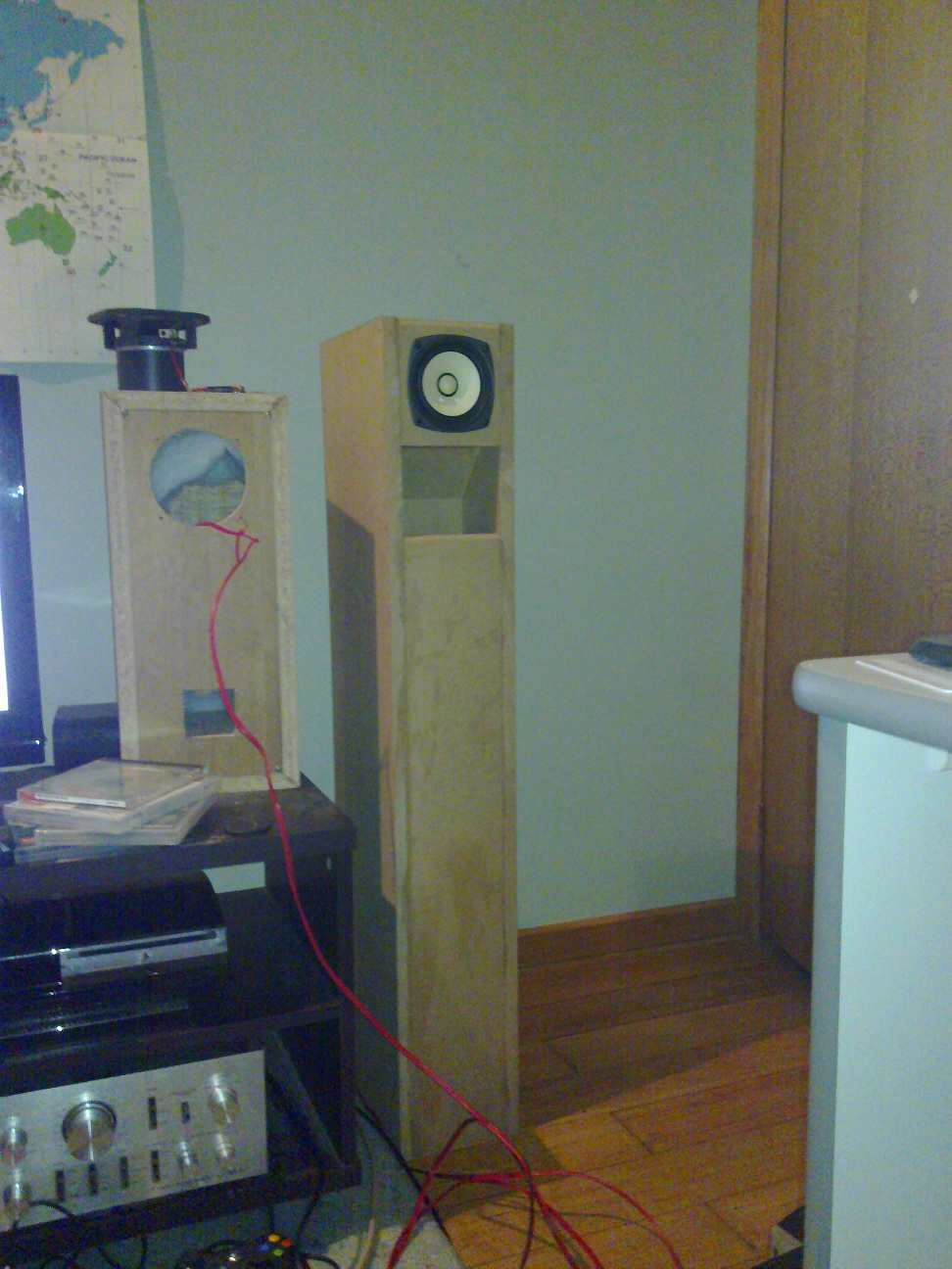

chisb you may have missed some of the posts in the thread, we are trying to establish the recipe for a TL with a 4 inch fullranger (in this case the Fe103en) that will play down to the 41-48 Hz region and make it in a convincing manner, like in the video from the original first post (My Other Listening Room - YouTube).
Jameslc will make an attempt based on estimations of the sizes done by me studying the video. I have made some experimentation with different enclosures and drivers but none had enough bass for all sorts of reasons; you need a suitable driver that can do the job and you need to use every advantage you can - larger enclosure, best placement for room gain, and I tend to believe that the mouth should be closer to the floor to gain a little more spl. The lowers the Fs the better, the larger the Xmax the better.
My concern with the volume was related to the overall size of the enclosure considering that it's for a smaller room (just trying to keep it small), and to compare with the original ~23liter estimation.

Finally got my FE103en today and i started to cut the hole for it to put in my finished transmission line and all i can say is wow! the bass in this enclosure is great (for a little driver anyway) but the only thing that is a bit annoying is it misses out some pieces of music but it doesn't seem to be a particular sound for example it would the piano in one piece and a bit of a bass guitar in another i don't know it might just be me 🙂 or because i am only running 1 speaker on stereo
WOW! You actually build it!
What's the tuning frequency, internal volume, height of the driver?
What was your first impression, the first few tens of seconds?
Are you satisfied with the bass output in strength and depth?

the tunning freq is what you provided before so 40 ish hertz and about 20 litres and about 1 meter, my first impression was that it does very well for a full range driver but i did have to turn up the bass knob on the denon to get any decent about of bass out of it but it is a very capable set up for a bedroom it seems to run well and i haven't run the video yet but will do tonight

Turning up the bass knob ... I don't like to do that, feels like cheating, plus it means it doesn't have enough bass... not good.
also means reduction in amplifier headroom, and in the case of drivers of this class, severe risk of exceeding x-max and possible damage
What about using a parametric eq (eq'ing down) to boost the bass? Does that have the same x-max problem?
I kinda think so - the driver's drive-train / compliance doesn't know / care about EQ - only that its physical excursion limit has been reached. The FE103En is rated at Fs of 83Hz and X-max .6mm. I think the best bet at getting any reasonable level of bass from a single of these per side would be some type of BLH - but not Fostex's design - those I've heard - the Buschorn Mk I would be my first guess.

i think that i have to turn up the bass on the amp because i have only got 1 enclosure built but from my experience speaker sound ten times better with 2 enclosures then one
This is totally true. In all three the speaker pairs I've built when I finished the first one and tried it out I was somewhat disappointed but as soon as I had them both running I was super impressed. I think this is mostly because of the soundstage becoming an actual soundstage and also that each speaker is doing about half as much work ie less distortion and more headroom.
