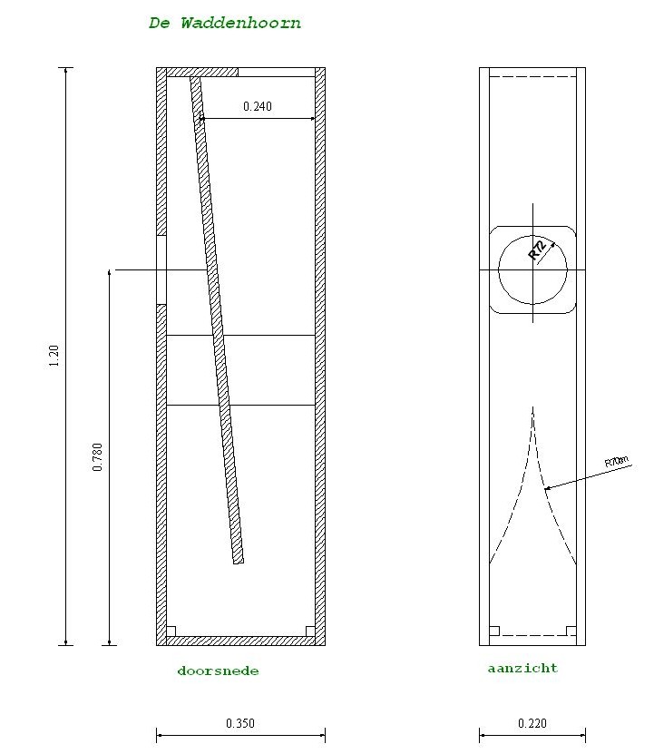

A bipole? Yes (Giovanni has done sealed bipoles, and i have a set of diy FR ref ML-TL bipoles in my living room)
or the iBIBk? also yes, JohninCR
dave
The i in iBIBk is inverted -- the intention here to both provide greater bass loading for the shorter BIB and to provide a closer to optimum driver height.
The k = Karlson slot is intended to smooth out the peaky nature of the BIB -- something i heard in the one set of BIBs i have auditioned and something i could not live with long term,
Whether it works or not is still an unkown. John says his are good, but he has not had a comparison to a "normal" BIB with the same driver.
dave

I find the iBiBk design to be very interesting. Has there been any refinement to the design presented by Planet10 in post #5?
Reflector Needed?
I wonder if the less than expected bass performance of the 126/127 BIB (and other relatively short BIBs) noted by some is in part due to the distance from the pipe/horn terminus to the ceiling. The shorter BIBs terminate a little too far from the ceiling for effective loading.
If this design has now been built, has an impedance curve been run? It just looks like the abrupt termination of the pipe would encourage resonance development, more so than in the upright BIBs. Perhaps a reflector would help. Also, a built in vertical 'v' divider like those used in the Austin horns.
Just a suggestion and a query as to the current status of the design and any feedback on how it sounds.
Bob

I've been working on a cutting list for a pair of these babys. Looks like they require two sheets of 4x8 material. If all goes well (i.e. I'm able to steel time away from the family.), I'll be next to build a pair.
Hi all - - I have built a rough pair of BIBs for the 126e, and am enjoying them in my living room with some equalization from my computer. I am now interested by the iBiBk or some variant (doctor says I need to inhale a certain amount of plywood dust each day to stay healthy).
A couple of references to the Zd, or driver position, being better in the iBiBk than in the original BiB. Was this determined using one of the spreadsheets? If so, can someone explain to me why it is better than the original published Zd of 20" or so? Just in general terms.
Also, does the BIB get any of its qualities from the fold in the middle, or is this purely a practical measure? I understand that a straight pipe for one of the bigger drivers would be impractically large, but am wondering about the idea of straightening out the 127" line length for the 126e. I would place a 45 degree jog just above the driver to shorten the vertical height to within a foot or so of the ceiling. This would also push the driver out into the room, while leaving the pipe mouth pushed against the wall.

ilewis33 said:A couple of references to the Zd, or driver position, being better in the iBiBk than in the original BiB. Was this determined using one of the spreadsheets? If so, can someone explain to me why it is better than the original published Zd of 20" or so?
To keep the driver at a reasonable height in the non-inverted orientation, a 2nd best choise for Zd is chosen. in the iBIBk the inverted orientation allowed Scott to choose a better driver location.
The fold is useful at helping to keep HF out of the mouth output.
dave
