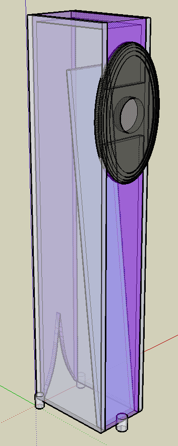

And speaking of BIBs... i just finished a set of drawings for my twist on an FE126/FE127 BIB.
[/B]
Dave, your twist looks great! Much more practical (to me) than the traditional BiB enclosure.
Do you have a modelled FR for the enclosure?
GG said:Do you have a modelled FR for the enclosure?
It is the standard FE126/127 63 in^2 BIB, inverted with the addition of the K-Slot... oh and the driver moved to more optimal position. Scott could generate a FR of it without the slot. I think i heard that MJK may be considering the k-slot. The hope here is that it reduces the Q of the resonance and smooths out the ripple a bit.

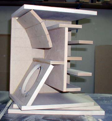

I might offer a word of warning to anyone thinking of cutting a k slot into a horn cabinet.
It might not be the case for every design, but I tried this on the dalek's, by cutting a diamond shaped hole in the back panels, calculated to open in conjunction with the original angled mouths, so that the opening began at 7/8 length. The result was less than satisfactory, so I glued the pieces back in again. I was indeed trying to flatten LF response (which it certainly helped), but the muddy blurred sound that resulted was worse than the uneven response. The whole attraction of the horn's impact instantaneously vanished.
Don't get hung up on flat response, as trying to achieve it could ruin a nice sounding speaker.
I am now thinking that after that experiment that a very sharp termination is best (at least for my tastes).

The first version of these ran FE167E's and the current versions run FE166E's. There is only 1/4 inch wool felt linning the rear line. The current versions also have different tapers on the coupler section. They will not make bass like a BIB but they can be run full range depending upon your taste in music. They do benefit from the addition of a good set of subs.

I'd really like to see your sketchup of the iBIBk. I just don't understand the Karlson slot and can't get my minds eye around the 2D drawings. It would be interesting to fly around them if you posted them to the 3D-Warehouse site, though I don't know how to look at interior parts or make exterior parts transparent.
mrpopgun said:I'd really like to see your sketchup of the iBIBk.
I'd actually have to do a 3D 1st. Easier to start from scratch than fix what i have done already thou.
dave

Thanks for the feedback on the K-Slot. Indeed, it would be hard to fly around if it hasn't yet been 3D'd 🙂
Looking at the plans, on the side profile there is the red rectangle rising from behind the closed end of the baffle on up and is labelled "cut-Out from Karlson Slot". I don't understand this. Tracing over to the head on view, I don't see a corresponding line to indicate if this is a piece tacked on to the backside of the baffle nor corresponding lines in the wall material to make me think it is a slot cut into the side of the walls of the speaker. Also, it doesn't seem to be cut-out of the baffle itself or out of the back wall of the cabinent. I just don't know how to read this.

Pop,
That's Dave recycling the piece cut out from the K-slot. It also maintains the overall terminus CSA, although I can't really imagine it having any audible impact. Mine sound fine without it.
johninCR said:That's Dave recycling the piece cut out from the K-slot. It also maintains the overall terminus CSA, although I can't really imagine it having any audible impact. Mine sound fine without it.
It's primary purpose is to give enuff wall depth to mount the specific feet i have,
The k-Slot + the openings at the bottom on the sides & front are equal to the mouth area.
3D model (sans the k-slot piece that was confusing mtpopgun) are up in the 3D warehouse titled "iBIBk". I also just substitued cylinders intead of modeling my feet.
dave
Edit: Note: there is an extraneous line in the 3D (at the bottom of the k-slot) that should be deleted.
The Sketchup is terrific and very much illuminates what I needed to see. These inverted designes interest me, even apart from the K-Slot. Rooms with tall ceilings, or homes with little tykes who are budding basketball stars could benefit from the bottom vs top opening.
In comparing the inverted to the non-inverted, what sort of difference does the gap between the mouth and loading surface (floor or ceiling) make in the resultant sound? Does more gap (ie upright) result in a but more airy, open sound? Does less gap (ie inverted) make for a more controllable sound due to being able to tune the overall cabinent height off the floor? How does the surface of the loading plane effect the sound ie plastered ceiling vs carpeted floor?
