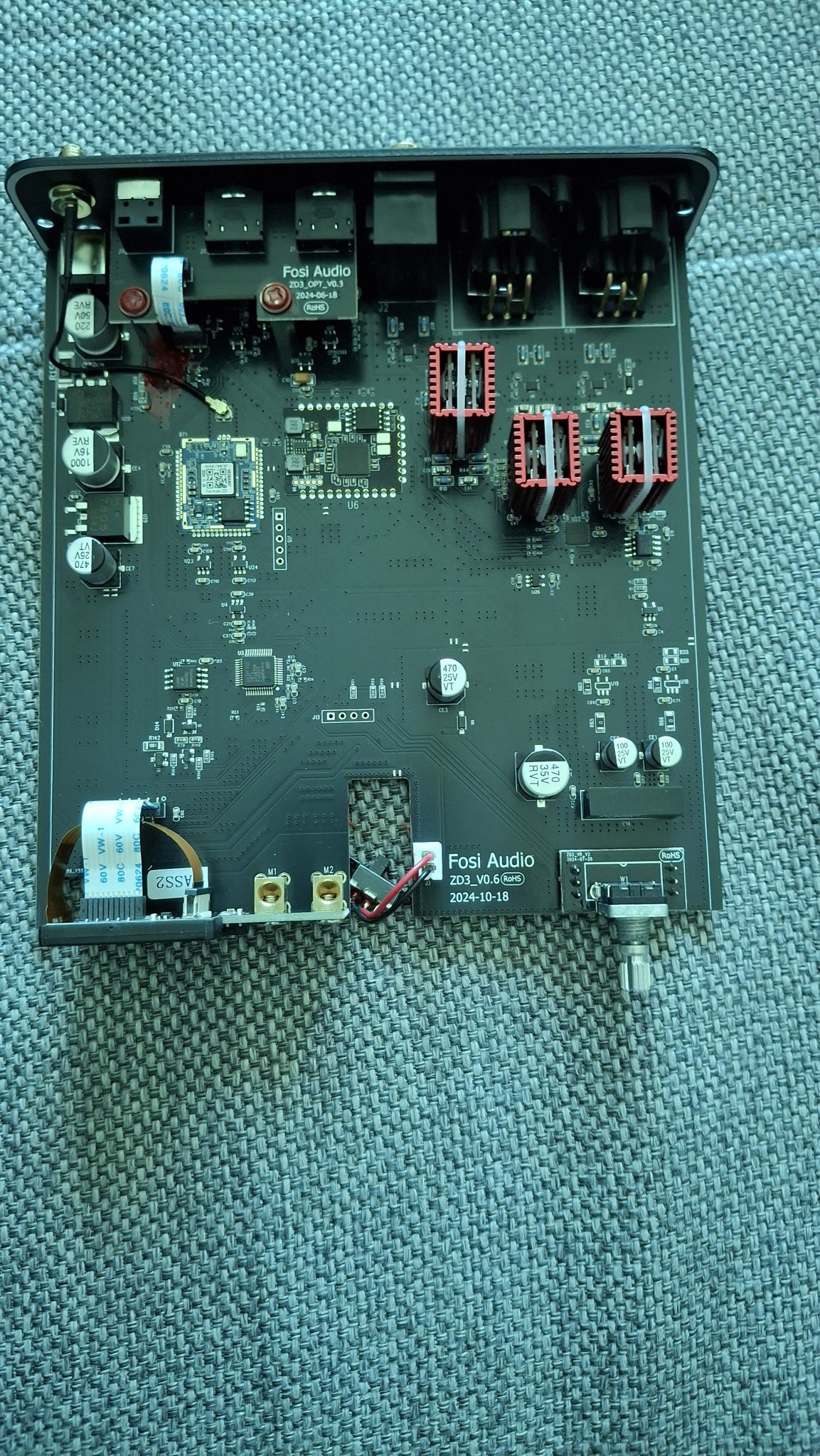

That sounds really good. I've now switched from the Fosi's XLR connectors to the Naim's DIN5 connector. The Fosi sounds really good with three Burson Audio V7 Vivid Pro duals. I can't say whether it's worth the price, but I'll try out a few recommended amplifiers again.

I have just purchased this dac and here is my plan:
I want to swap I/V (XLR) opams to sparkos ss3602 as I only use XLR outputs.
I plan on getting (making) linear PSU. Any suggestions on ready to use ones from aliexpress?
If I make one I will probably use antek transformer and lm317 regulator .
Wonder how much Amp rating psu should be?
Did anyone test what capacitors are in the feedback of the I/V circuit? If they oversize them too much it will affect open loop gain to the point where no matter which opamp is installed the sound is going to be the same. I also plan on upgrading those caps to film type but since they are SMD it will be quite a challenge.

I have a different DAC that I opamp rolled and tried opa1656, opa2134, and originally installed opa1612. Those were soic-8 packages and were pain to solder. Also tried removing feedback caps for I/V circuit but it oscillated so had to solder those back in and everything worked fine. those are smd 0603 btw 😭 😂
Dac was Sabaj A10d with ess9038q2m dac chip.
After listening to opa1656 to me it sounded too grainy with too much highs.
opa2134 was amazing and my favorite but with highs not as pronounced as I would like.
opa1612 was best in terms of balanced sound.
It will be interesting to try them in fosi zd3 - i have soic to dip adapters that i can solder those on.
But again, that cap in the feedback is potential bottleneck. I might just run a simulation in LTspice to confirm how low in value I can go without it oscillating.

looks like 1.5amps 12 Vdc for included smsp
looks like LM338 would be a better choice
