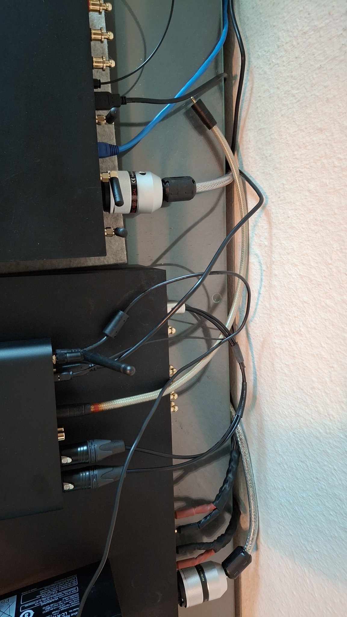

I've now connected the ZD3 to the Eversolo via USB and connected it to my Naim Nait 5si via XLR to 5-pin DIN. It doesn't sound as good. When I connect the Eversolo DMP-A6 Master Edition directly to the Naim, it sounds significantly better.

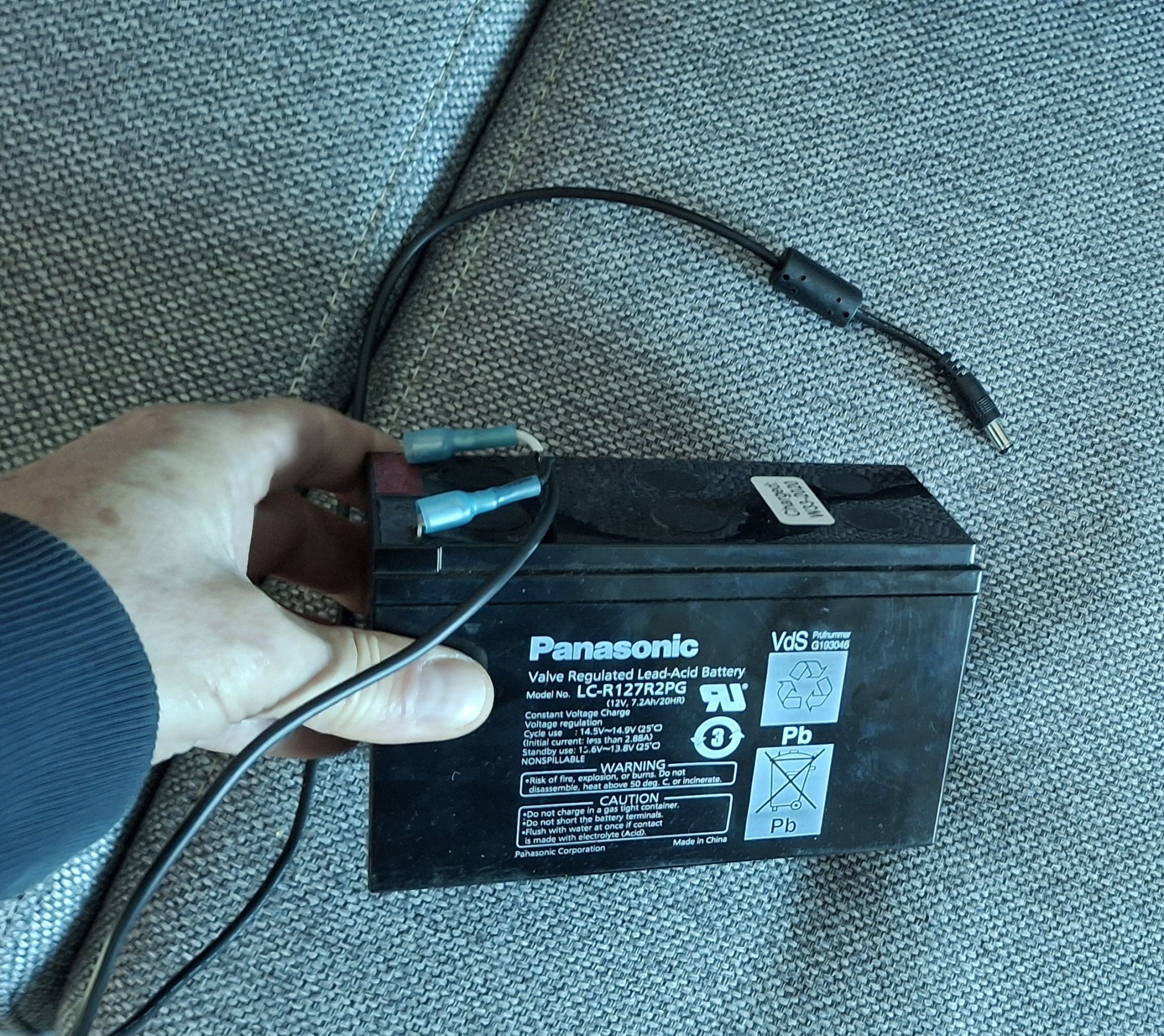

When I first saw the Fosi ZD3 DAC's back panel with 12V DC input, that's the first thing I thought to do. Everybody has 12V batteries laying around; I use those Panasonics in my UPS's.
I only WISH Chord Qutest DAC used 12V DC input. It uses 5V DC input, so I had to resort to series/paralleling a bunch of Eneloop batteries, which comes with the pain of recharging.
But the SQ improvement is definitely worth it.

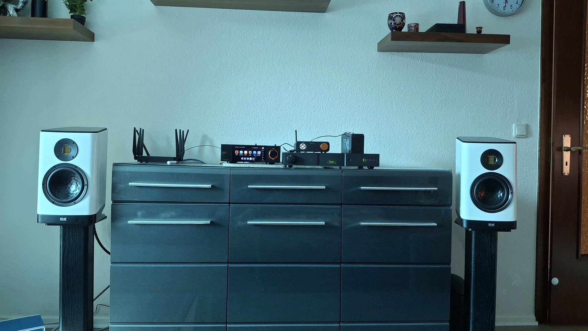

Caught my eyes: if that device on the left is a multi antenna RF device then it is way too close to the audio devices. If it is a router then it is also so close that everything can be connected with ethernet cabling to it.
The audio setup as a whole is meant. You have one of audios most hated and influential enemies (this time one with 8 tentacles) less than 30 cm away. It is recommended to place it much further away, limit RF output to 75 or even 50% in its web page (update its firmware and disable unused wireless protocols when you are there too) and use mains filtering and ferrite beads on the audio cabling. Blasting RF all over the place when you are only a few meters away with wireless devices is contra productive with best audio results in general. Some wireless devices also choke on too high transmitting levels. So adapt stuff to real life requirements, always. This may have a much higher impact than using audiophile opamps. Are such contraptions even EMI/RF proof?! please see this very good opamps features in that field:
https://www.ti.com/lit/ds/symlink/o...460&ref_url=https%3A%2F%2Fsearch.brave.com%2F
A small ethernet switch only for the audio devices connected to an ethernet port of the wireless router a few meters away also may work out OK. Audio generally does not need ultra high speeds but just good quality wired connections.

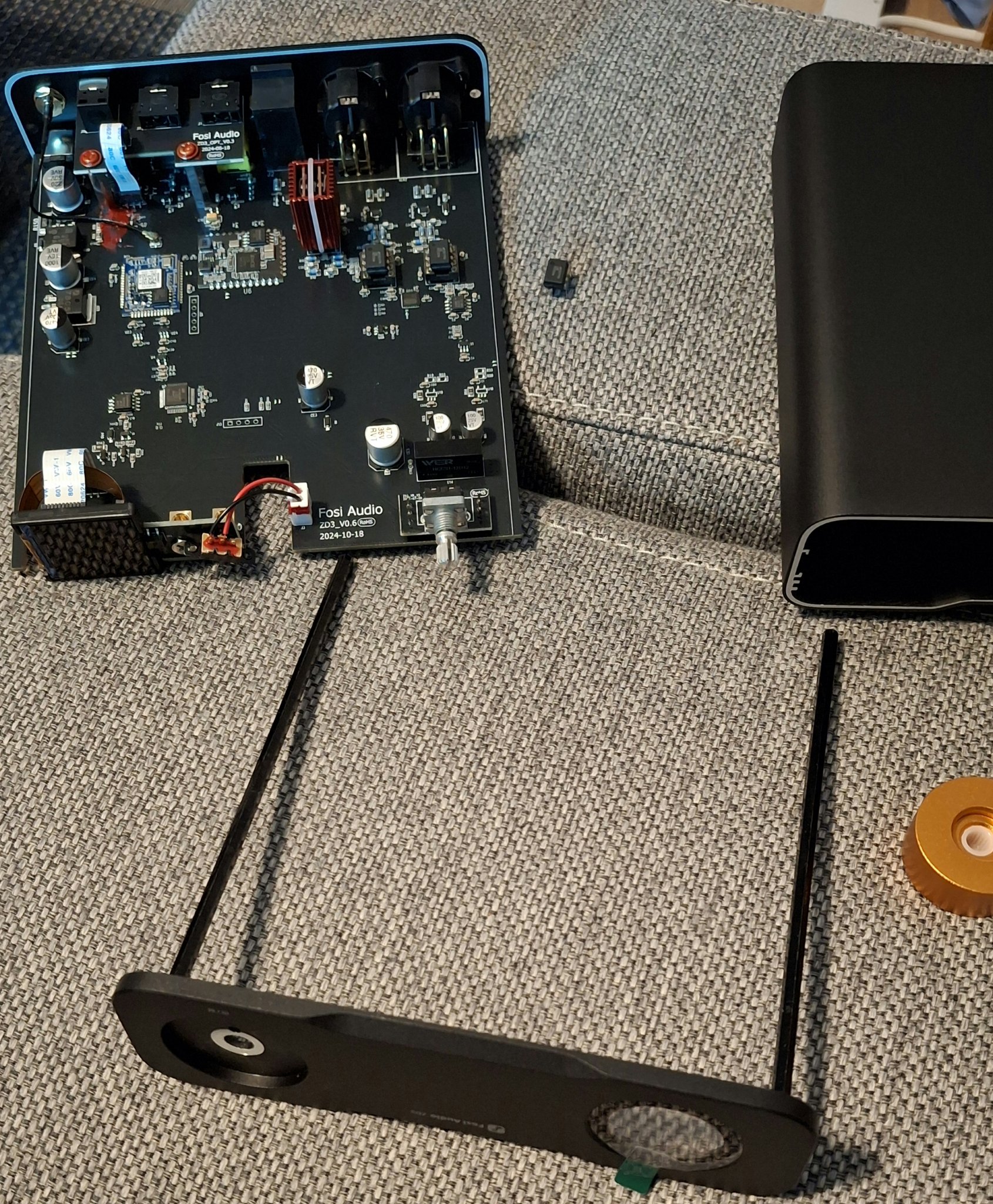

I was absolutely surprised by how the sound changed for the better. The Fosi Audio ZD3 plays like a top-class DAC.

I've been playing with opamps in my P3 preamp and Burson Swing DAC.
In the Burson family, I'm torn between the V7 Vivid and Classic. You might want to try them.
BTW, both devices are very low noise. The P3 is set up to amplify a 1.0mV cartridge and there is no noise in the system.
Just make sure the opamps are properly seated though. I had some noise issues in a previous iteration of the P3 with looser op amp sockets.

2- I too caught interest in this new unit when it was released. I am though a bit puzzled about what is said regarding OP Amp swapping. For sure changing the one that stands last in the chain when using the RCA outputs affects the sound of the RCA outputs. For sure changing the 2 OPAs that are last in the chain when using XLRs change the XLR output sound.. BUT, when you look into the diagram, it appears that (as often the case) the RCA outputs are "resulting" from the XLR outputs, so for sure swapping the 2 OPAs supposed to act ony for XLR are very likely to change also the RCA outputs sound... opens another field

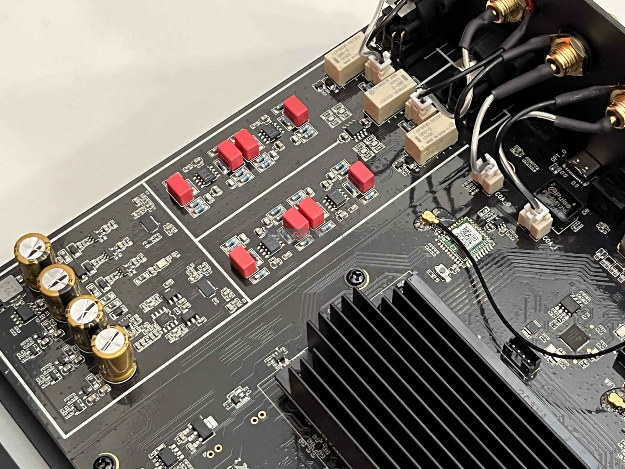

It might also have something to do with the output stage! The Eversolo has a Burr Brown OPA1612, and the ZD3 has a Texas Instruments LME 47920. They sound very warm and bloated.

- Fosi ZD3 with Burson Audio V7vivid pro dual and a lead-gel battery as power supply
