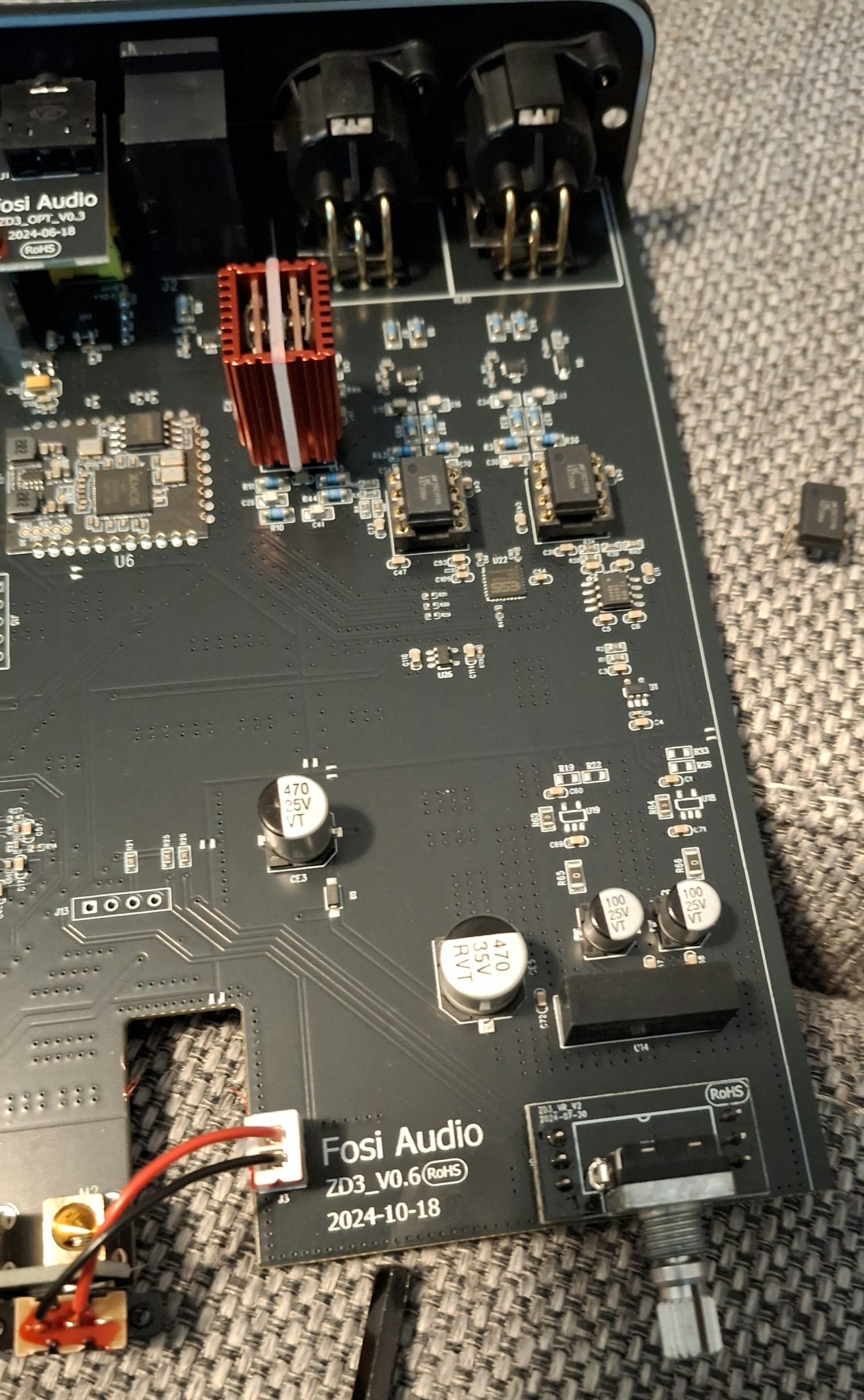

On my power amp without tone control, the ZD3 has audible background noise, but on the Naim Nait 5si, it doesn't.
Sonically, the DAC is slightly behind the Eversolo, in my opinion, but this is only due to the op-amp output in the preamp. I've now plugged in the Burson Audio V7vivid Pro dual again, and it sounds significantly better than the Eversolo without the ZD3. The included op-amp sounds very warm, but also imprecise; with the V7, it sounds almost perfect! The connected speakers are Elac Vela BS404.2
With a discrete Burson Audio OP and battery power supply, the ZD3 sounds very audiophile and, in my opinion, offers more sound quality than the DAC and output stage of the Eversolo DMP-A6 Master Edition

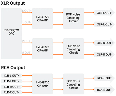

Well, don't know if "I" am right, the question is rather "is FOSI right?"... as the following scheme is what THEY advertise.
My interpretation is clearly that the sound of the RCA output has to go through 3 OPAs... but then that's me and not FOSI LOL

I wasn't familiar with these diagrams from Fosi Audio.
The pop-noise circuit is not an operational amplifier.
Each XLR output has its own dual operational amplifier, and the unbalanced RCA output, accordingly, only has a dual operational amplifier.
No. ClaudeG saw it right. Just look at what is written at the input of the RCA opamp. DACs with such specifications are meant to be used balanced.
Yep, Jean-Paul is right 🙂)
So, again...
The pop noise cancelling device has indeed nothing to do with all that and is... hopefully something different than a cheap chinese transistor (as those fail on SMSLs and Toppings as we found out, sometimes with catastrophic results - shorts and unit death) - eg. a nice transistor from a reliable manufacturer fingers X, no rocket science.
Now to what is of interest to us, the OPAs...
LME49720, one per channel, for the XLR output. Classic layout.
FROM that XLR output, Fosi deviates it (again, quite classic) to obtain the RCA output, using a third OPA (again LME49720).
So...
If you follow the entire RCA path, it goes per channel through one ("XLR OPA" plus "half of another one, the "RCA OPA"".
Bottom line: swapping one of the 3 OPAs, where ever they are, affects the RCA sound, at least one channel.
Now, you have to be carefull with OPA rolling... the OPAs in the XLR position don't do the same as the last one advertised for RCA, neither do they see the same impedances etc.
What sounds best to your ears in one position may not in another. And the required specs might be different (very likely), not even mentioning PS decoupling to the OPAs depending on what unit is used. Lucky us, some OPAs are quite tolerant regarding all these, hence possible (reasonableà) roll amping... but always best if knowing what you are doing.
No miracle, as said I looked into this unit (one the net) when it was released, a friend of mine might have needed a cheapo DAC but at the end he didn't, so I could get my hands on it LOL. But I found the unit nevertheless interesting indeed...
Amp rolling, presuming you know what you are doing, is an option. Filtering the SMPS "outboard" clearly another- very easy- one. More for advanced tweakers and ruining the warranty, playing with the PS caps and bypasses around the OPA is also something perhaps worth considering, depending on what was done already (no scheme sadly, but I presume minimum cheap SMD caps, whereas some top OPA may benefit from a better decoupling... perhaps)
Have fun!

I use a 12V lead-gel battery as my power supply. Thank you, there's no arguing with that.
It simply sounds better than any power supply.
The Burson Audio V7vivid Pro also performs very well, although it's somewhat neglected here in the forum.
I find the V7's sound to be at least a notch better than any other op-amp I've heard so far. It simply sounds more authentic and less tiring.
I'll be receiving two more V7 Vivid Pro duals soon and will install them in the ZD3 as well. I'll let you know my impressions!
