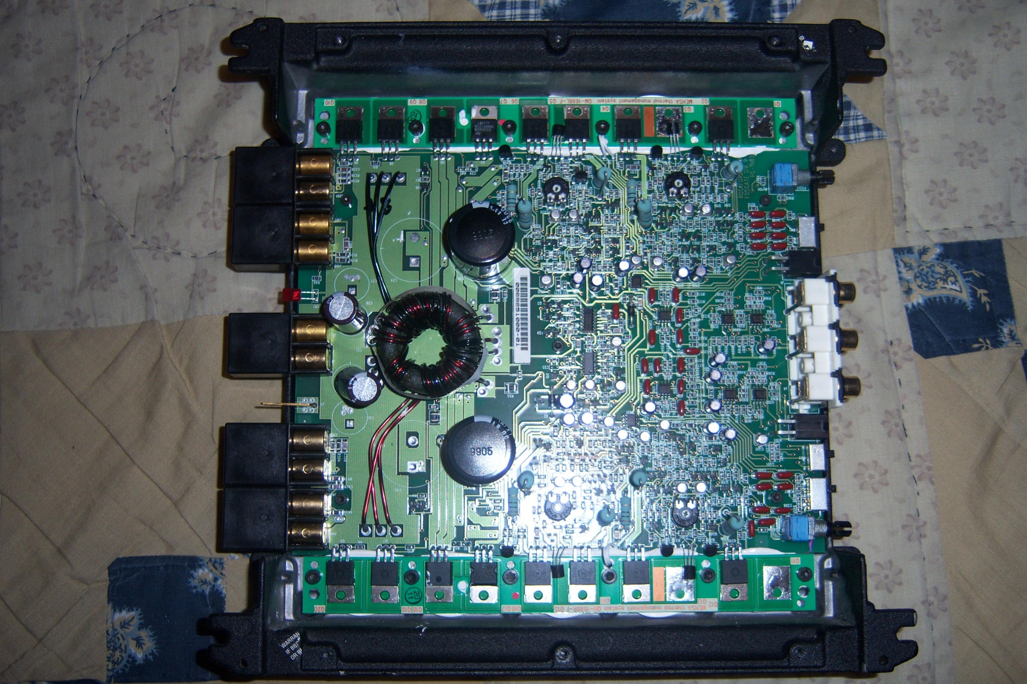

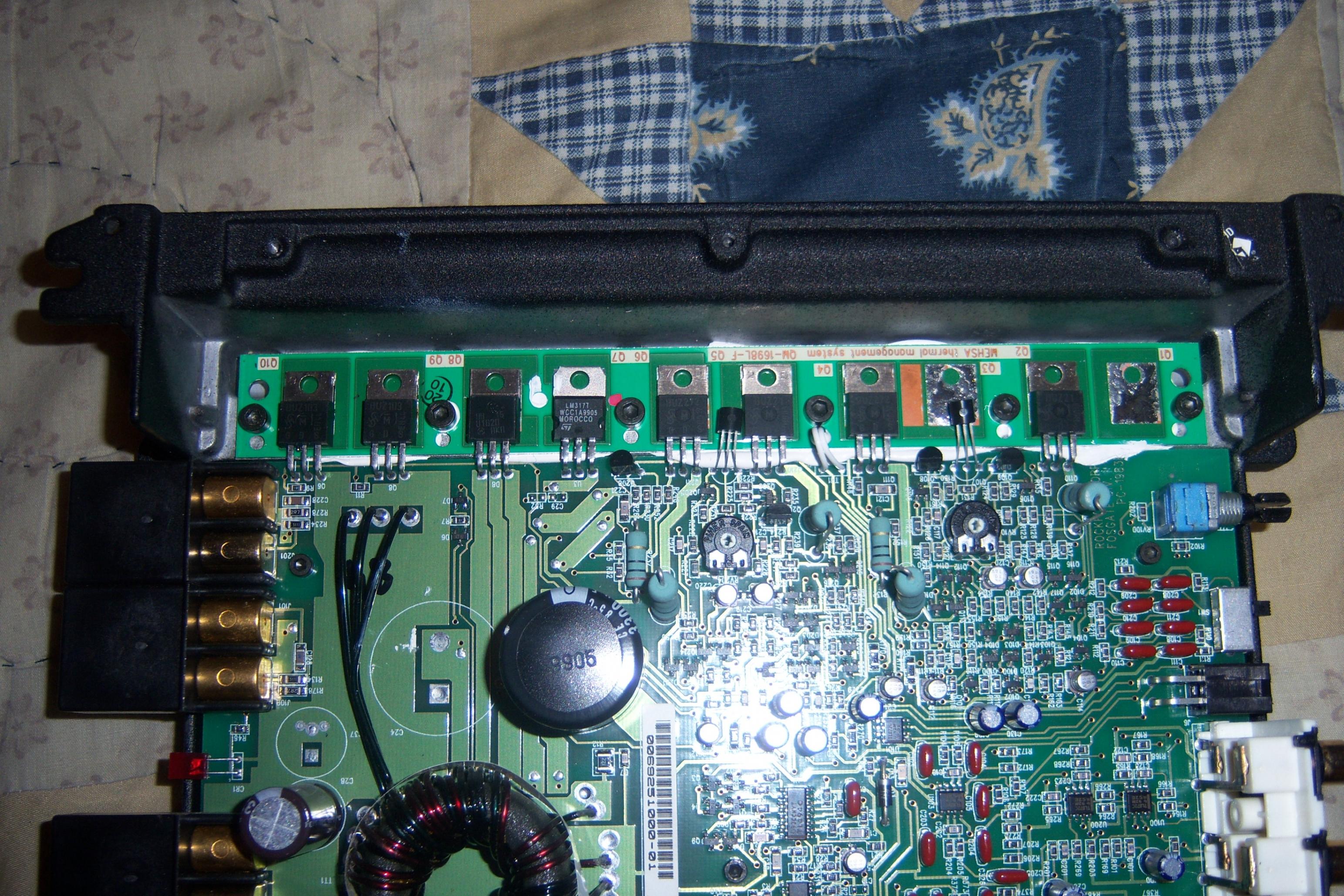

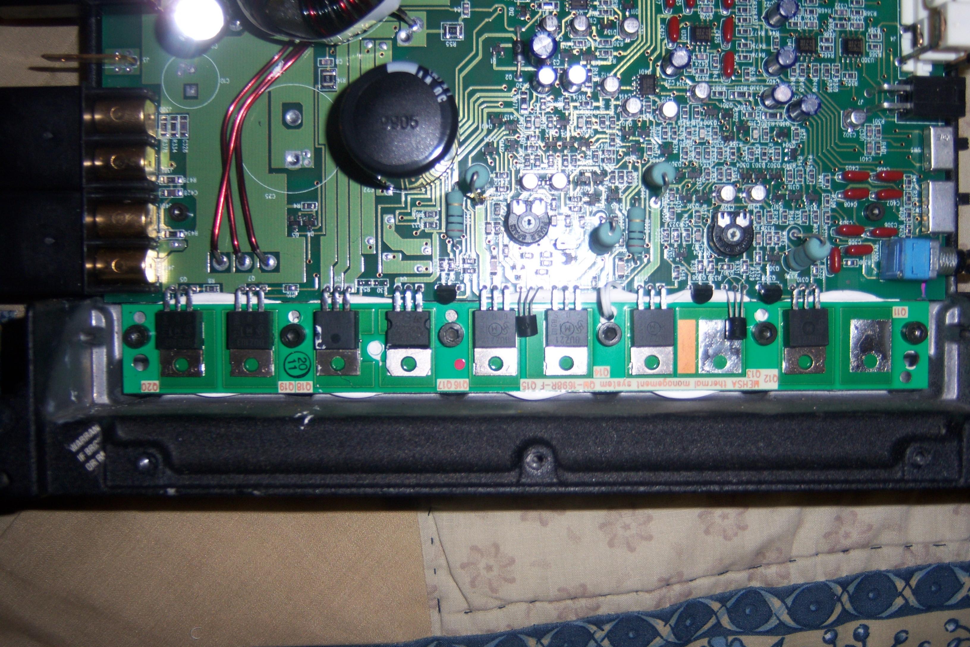

Looks like a 200.4 not a 200a4. Rockford used BUZ 21 and BUZ 272 for output transistors in the 200.4 and IRF540 and IRF9540 in the 200a4. I see in the last pic a transistor with clipped leads. Probably was shorted and blowing the fuse. Assuming they clipped it to get the amp to power on again. One side of the amp probably still works and the other side has no sound or static??? What test have you performed???

i just pulled this amp back out and still can't figure it out. today i powered it up directly with a 10a fuse and the amp would come on and pull about 5-6 amps. with all the parts in the amp the outputs in that 1 channel would still get hot and after a few seconds the cap in the zobel network got very hot. i removed it and it tested faulty, so i left it out and the amp now pulls about 2-3 amps of current. i know that if i pull either 1 of the drivers or either 1 of the fets all current draw goes away and everything runs cool.

Lift Q405 and Q406 and reinstall the other transistors that you removed. Does it still draw excessive current?

i pulled Q405 and Q406 and it seems to do better
