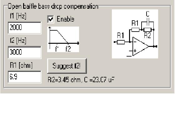

I have been scratching my head trying to figure out what is going on and then I realized that even though they look like big horns, they are still open baffle.
So, I fired up the Edge program and sure enough, it talks about a 6db roll off in the bass. the program has a bass bost comp design function so I worked with that and came up with a circuit that might work. HOWEVER, it shows what would normally be an opamp in the forum of a triangle but makes no mention anywhere of an opamp.
Can you tell me what this represents in the pix???

No, it has always been there. I am thinking it is the common OB 6db drop in bass, which the comp filter addresses. I just have to figure out if that triangle is my amp....that is what it is normally used to represent. If so, then the first resistor would go to the poss of the input of the amp and the circuit would end up at the poss of the output.....but I don't know for sure and don't want to blow anything up.
