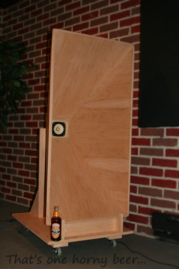

yes I understand that. I am reading the links that you recommended for the horn theory, but, hard to see an example of calculation of the same type of horn as yours. I could use the same angles and if the throat is bigger, then the horn depth will increase also. I could use a second horn after the throat with different angle, but, not having the basic knowledge (Yet) it is hard to say what it will happen in theory.
If I were doing it over again with a larger driver, I would increase the depth of the horn a tiny bit and size the throat for the driver. The flare shouldn't be that dramatically different after doing so.
I opted for a fairly rapid flare.

Your are so right. The answer for me will be try it in my auditorium and system. Did you used 45 degrees angle between the panels right ?
I am thinking to build the first prototype with thin panels for easy building.
I see that you have others kind of horns . How you compare this horn to the others ? Thx

Again, this is a difficult build in comparison to all other horns I've built.
I don't know your level of woodworking expertise, so I just give that disclaimer. Here is a link to help you calculate your bevel cut.

Thank you for share your idea.
I have good skills in construction, but not having the wood pro machines, I think that I can handle it.
This prototype sound more like a open baffle that than a box horn design?
