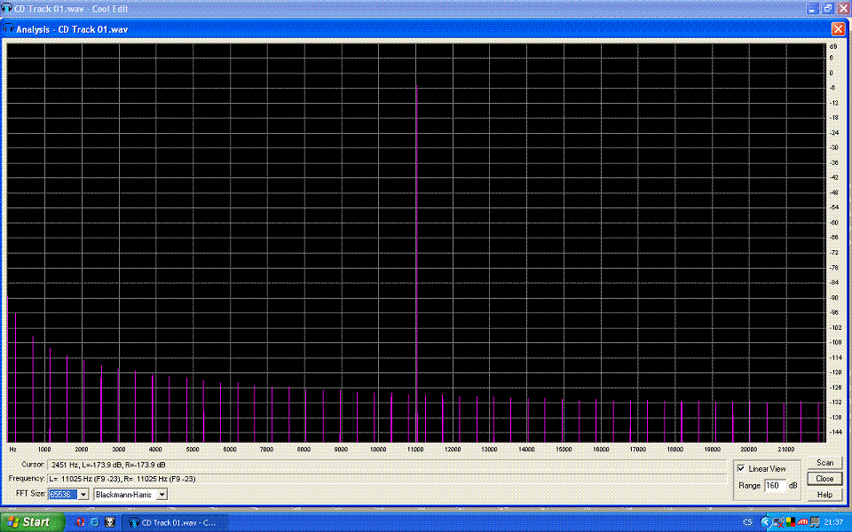

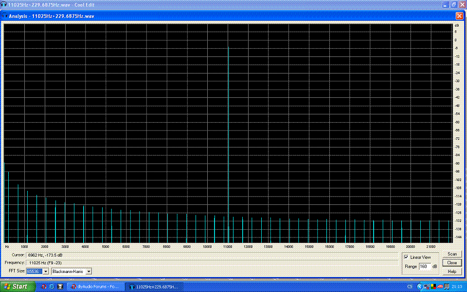

It is Julian Dunn jtest, 11025Hz -6dB sine + toggle LSB 229Hz. When I tried to rip it back from properly burnt CDs, I got different wav files. Audiograbber changed ratio between amplitude of sine and toggle, made toggle bit with higher amplitude. Also, problems with burning to CD, "skirt" around base frequency. Properly ripped by foobar and properly burnt by Nero.
The spectrum of the ripped wav should look like this:
