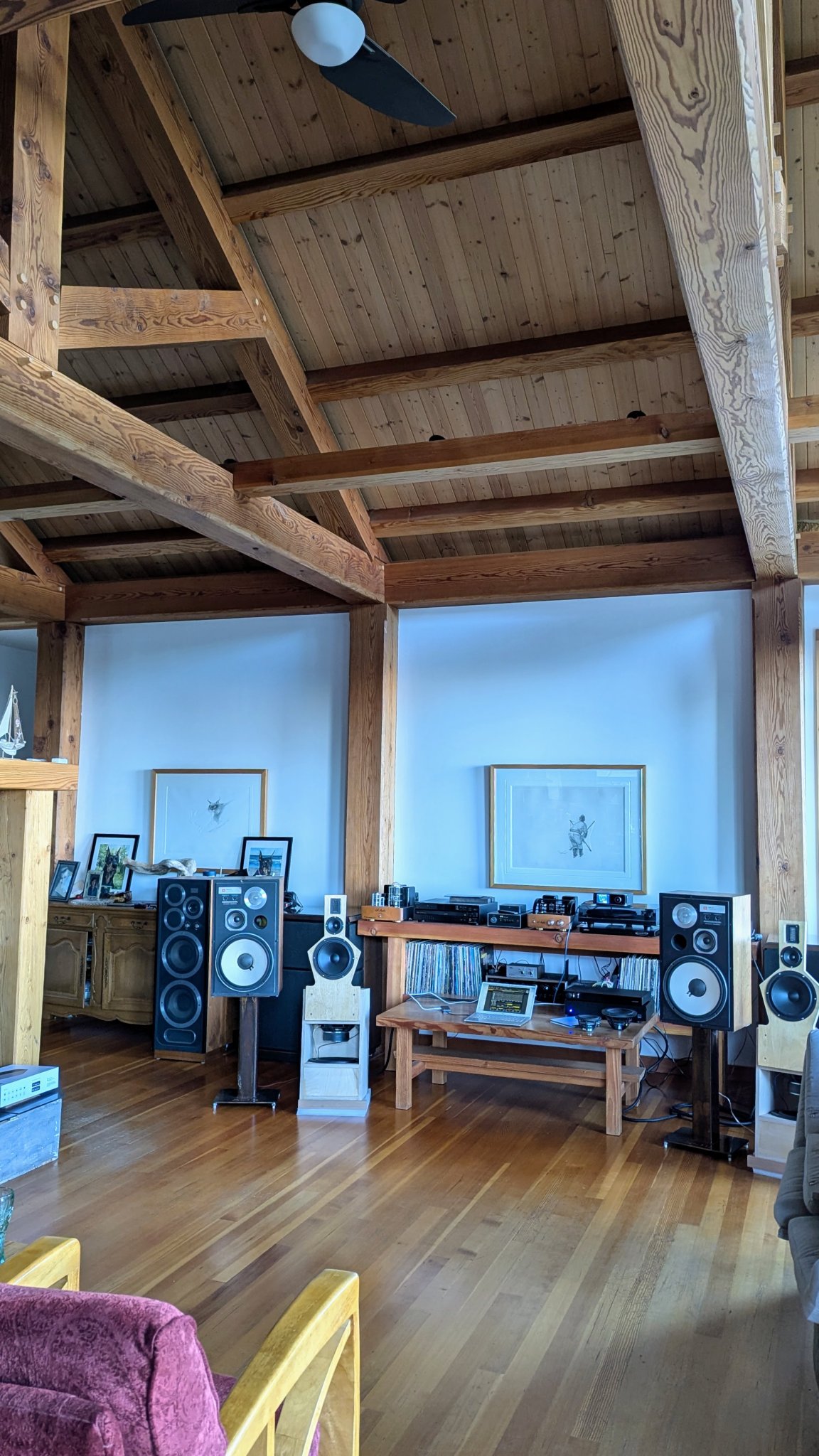

An update, 2+ months after this project began.
The plan that developed at the start was based on our assessment of the acoustics in Mark's space (highly reverberant, large volume) and listening to his current audio systems in that space. Those audio systems included mostly vintage gear: a set of tube mono amps & preamp, a Naim NAIT, a Wiim Pro streamer + JBL L112 & Electro-Voice Sentry IV speakers. The EV Sentry IV were compromised by a damaged tweeter compression driver on one speaker. Even the undamaged one by itself sounded poor to me: disjointed, kind of incoherent & loud. The JBL L112 through the NAIT sounded much better, a bit bright without any deep bass, flat (imaging wise) and in your face but still enjoyable in its own way.
But we'd heard nothing else in there.

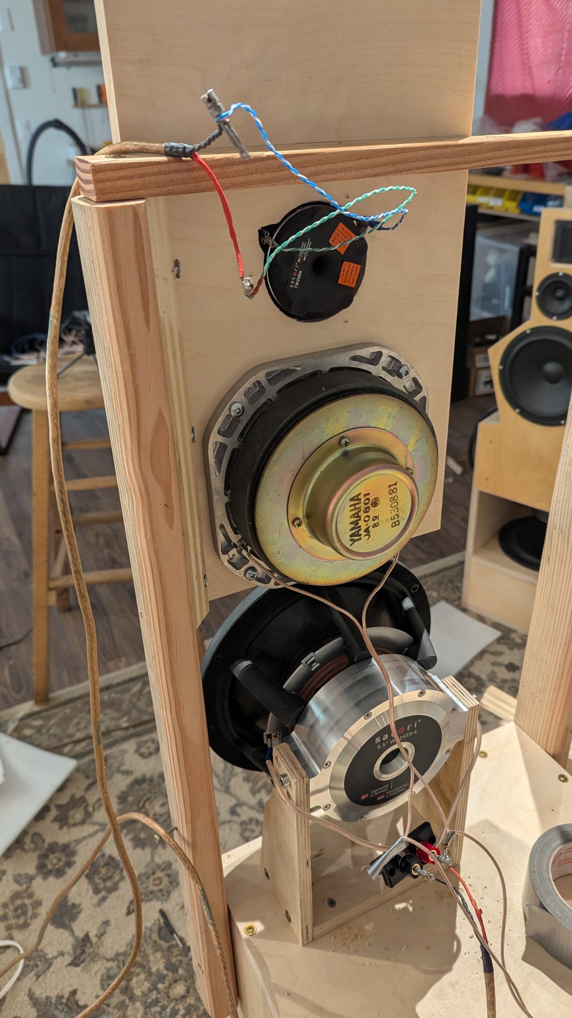

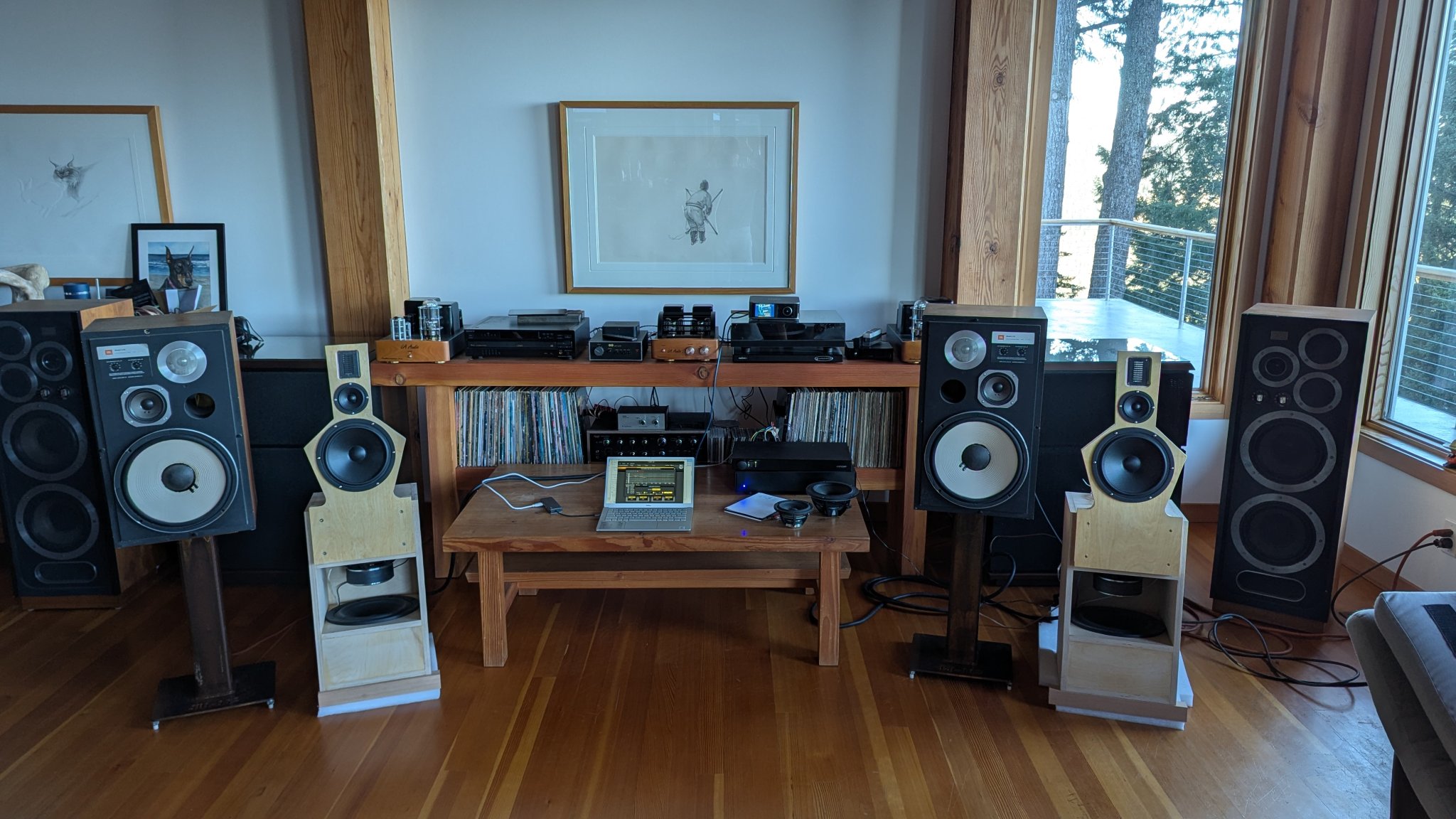

I decided it was important to do a trial run of my OB speaker system there before embarking on any specific path. I just hadn't had any experience with such a big space.
So my LX521-inspired speakers, Buckeye/Hypex NC252MP 8-ch amp, miniDSP 4x10HD with all the cabling was transferred to Mark's place & set up alongside the other gear. I brought along a laptop & UMIK to get some hard measurements of both my system as well as his in the space.
The speakers were pulled out about 4-5' from the wall, at Mark's default location for expedience.
A stack of cushions from unused chairs in the now unused summer room was laid across the floor in front of the speakers to help tame the reflections for a while. They are stacked on a sofa on the right in the above pic.
This pic shows the listening position and the vaulted ceiling.
Several conclusions were reached at the end of 3+ hours of listening, measuring, comparing & tweaking.
1. The OB system had plenty of bass, albeit not quite as well defined in my much smaller studio, with virtually flat extension to 30Hz, and down only -6dB at 25 Hz. This was without any adjustment of the PEQ & quite unexpected. In comparison to the L112s, the upper bass was also much more full bodied & authentic sounding (to us).
2. The spacious soundstage depth & size of the dipole effect was obvious & much appreciated.
3. The OB system sounded both more detailed and smoother despite being more laid back in many ways.
4. The reverb wasn't really intrusive at low & med levels (perhaps 90dB SPL) but became quite harsh and more evident as volume was increased. There may be a step-like turning point beyond which we suddenly hear the increased reverb as intrusive. It may also be the rising distortion of the system that is exacerbated by the reverb.

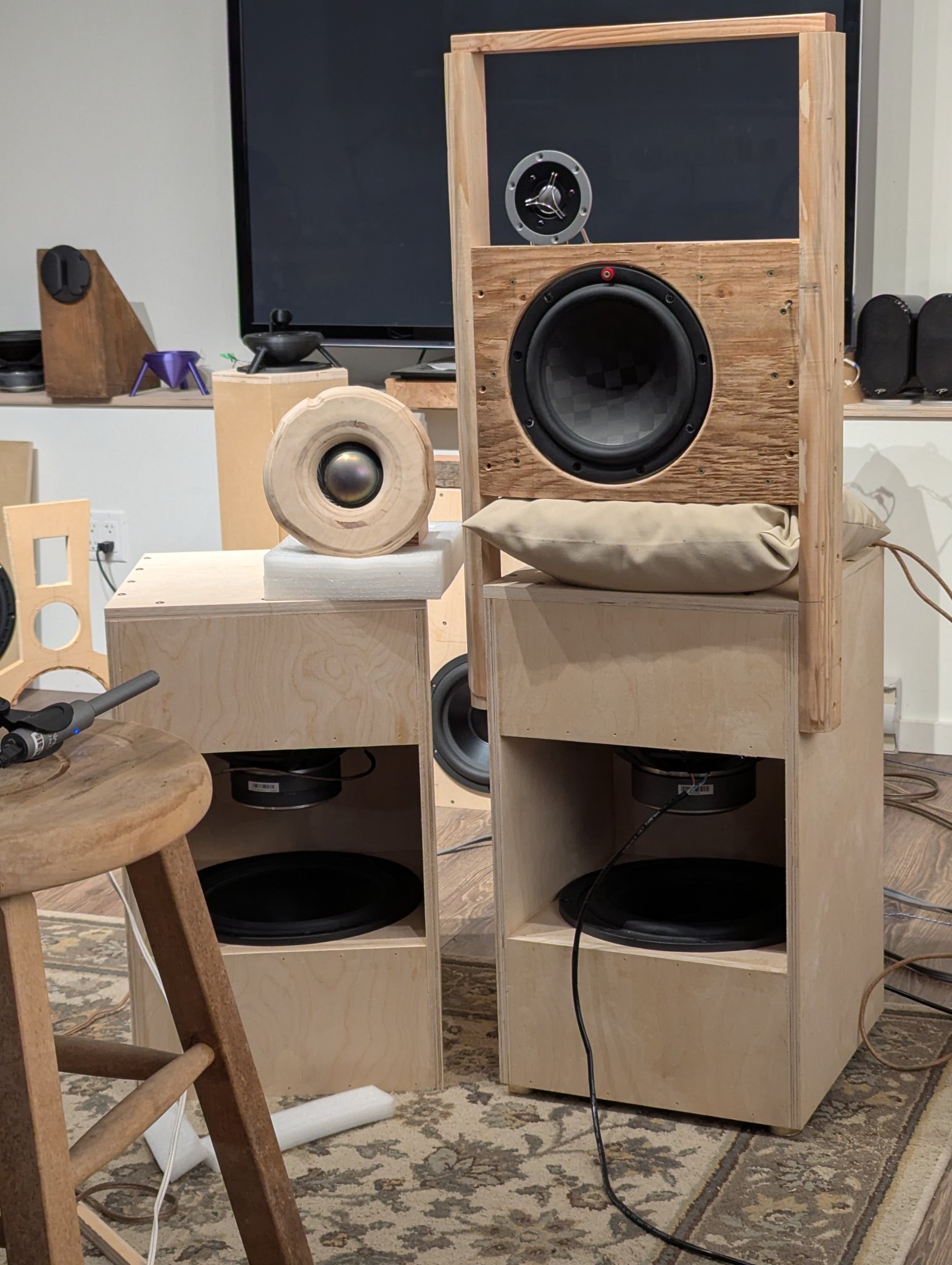

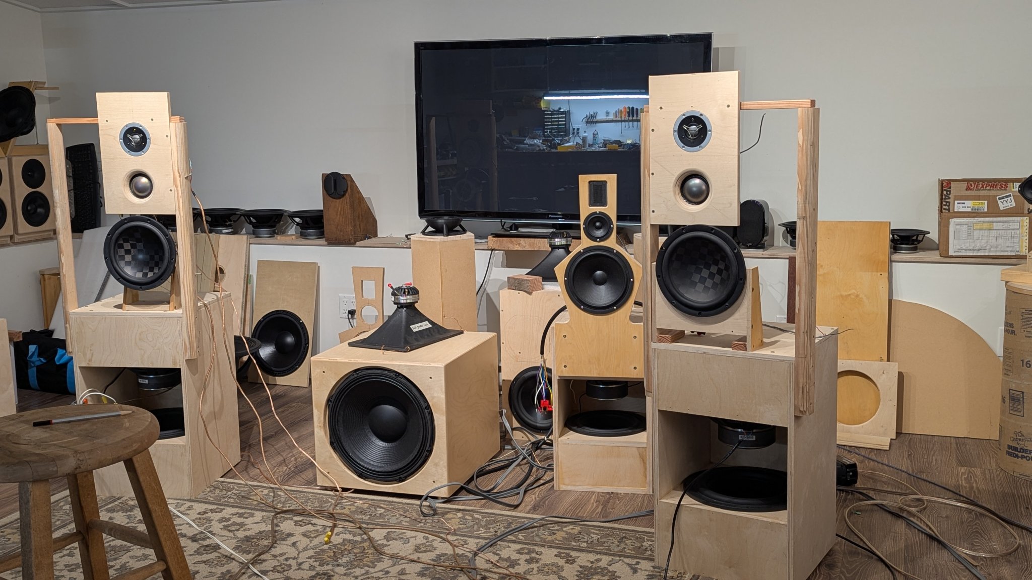

My system was left at Mark's for him to keep listening & comparing. Some days later, he expressed his desire to go full-on OB into the bass with the new system. The quality and naturalness of the bass from my system convinced him that a scaled up version would satisfy him fully.
The new config would use the same SBA SB34SWPL76-4 sub drivers chosen originally but in a dual-opposed Linkwitz W-config like my OBs.
The rest of the system would remain unchanged --

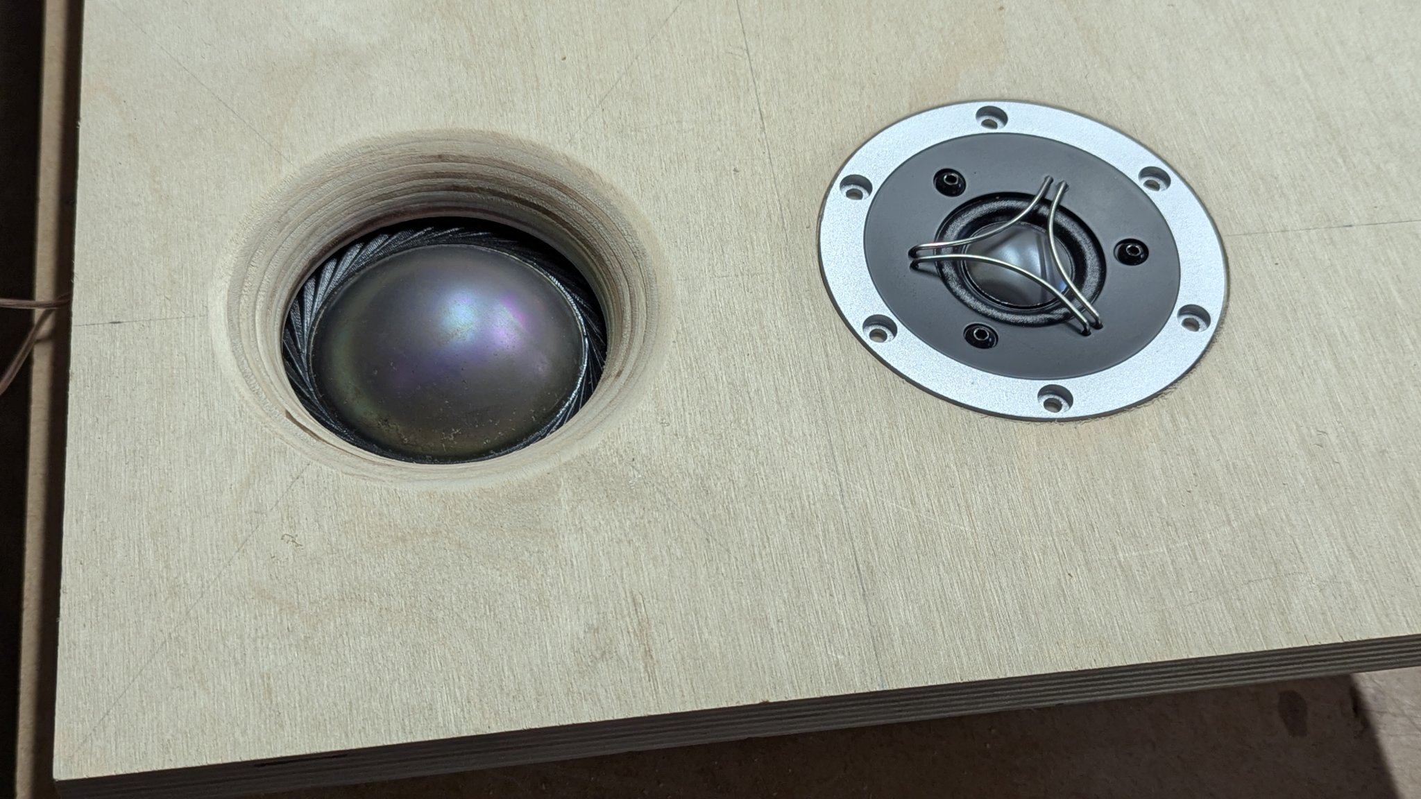

Low Mid: SBA W024TX for the mid
High Mid: Satori MW13TX
Tweeter: Aurum Cantus AST2650 with shallow waveguide on both sides.
Tweeter, if 3-way: If the WO24TX behaves well enough past 1kHz, Satori TW29TXNWG Textreme. The reviews of the Beryllium WG guide version in both Audioxpress & Hificompass state they are good as low as 1kHz, and there's no reason to believe the Textreme version would be much different. The back tweeter would be the non-waveguide version -- Satori TW29TXN, which is shallow enough not to require cosmetic adjustments for the hole which might end up having to go through the baffle board with the deeper WG tweeter.
A pair of SB Audience NERO-18SW1900D was added to the mix. These would be in sealed undersized boxes with heavy DSP to extend response down to 20Hz. 1900W, 17.5mm Xmax & 34 Hz Fs promise great SPL way down low. They would only run from 50Hz down. It's Mark's insurance for undistorted authoritative deep bass at any volume. There would be little or no detriment to the dipole effect; our hearing is too compromised down that low. The initial plan is to run each of these subs with a bridged 2x300W class-D amp from @Erica.C We might have to work out another crossover as well, depending on whether the system ends up 3 or 4 way.
MiniDSP Flex 8 for DSP crossover + Wiim Ultimate for streaming & preamp role.
Does yours have the waveguide? Hard to tell from the picture.Tweeter: Aurum Cantus AST2650 with shallow waveguide on both sides.

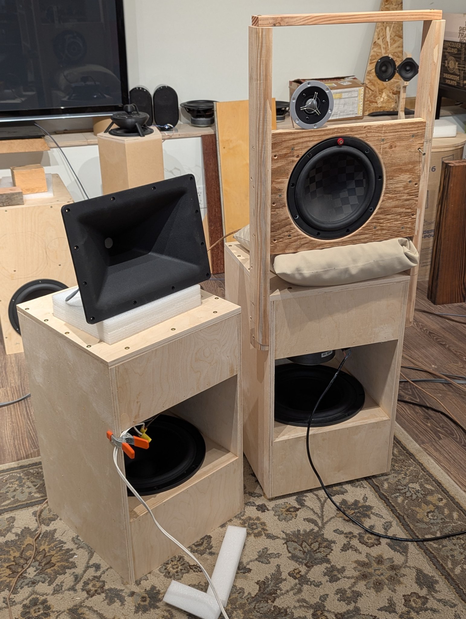

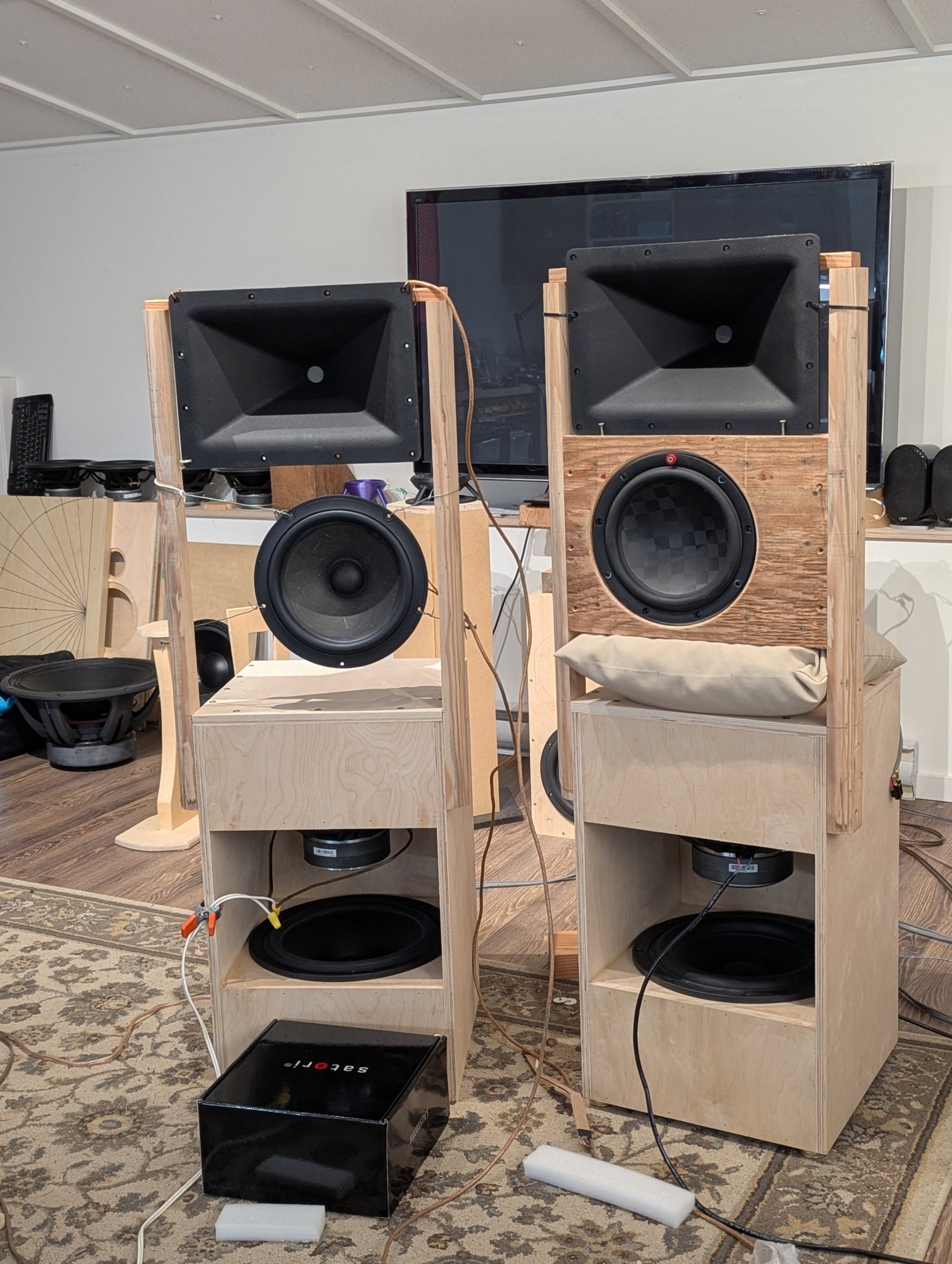

Horny developments:
I discussed this project with Mike L, an old speaker building audio enthusiast buddy. In particular the intrusion of the reverb at higher volumes & Mark & his wife's relucntance to add any significant acoustic damping to the room. Mike's immediate take was: Horns for the higher frequencies.
Horns would reduce spurious projection of higher frequencies into the cavernous room and cut down on the reverb. Mike believes the primary benefits of dipole dispersion happens from around 50Hz to maybe 600-1000Hz. The fact is that he has built multiple OB systems and experimented with numerous horns. His latest experiment is three 15" woofers in a simple OB with a 24" SEOS on top. Says it sounds fantastic.
Gave me pause. Could I get the main benefits of OB dipole + reduce reverb with a horn crossed at 1~1.5 kHz above the 9.5" Textreme driver?
This path had to be pursued.
I happen to have pairs of B&C DE250-8 & Eminence N151M 1" compression drivers along with a pair of B-52 PHRN-1014 10" x 14" 90x40 Horn that fits them. A quick test of the N151M on that horn showed it could be EQ'd for pretty flat response from 1kHz onward with quite low distortion at 100 dB SPL. So...
This B-52 horn + the above drivers might be OK down to 1kHz; need more tests for distortion at the lower frequencies.
But are the above CDs good enough? A quick hunt through Solen's catalog showed up a SB Audience in stock, with promising numbers & features: ROSSO-44CDN-PK
And someone pointed out a nice looking anodized aluminum FaitalPRO STH100 80x70 horn at PE that works down to 1.4 kHz. Shipping to Canada is insanely pricey right now, but someone I know is heading up in a week or 2 and will bring them up for me.
So the stage is set for comparison between CB + horn vs full OB at Mark's place. This means building the OB bass bins + w/ pairs of tops for the upper frequencies. They only need to be functional, not beautiful so it's not that much of a hardship.
We'll see which works best here.

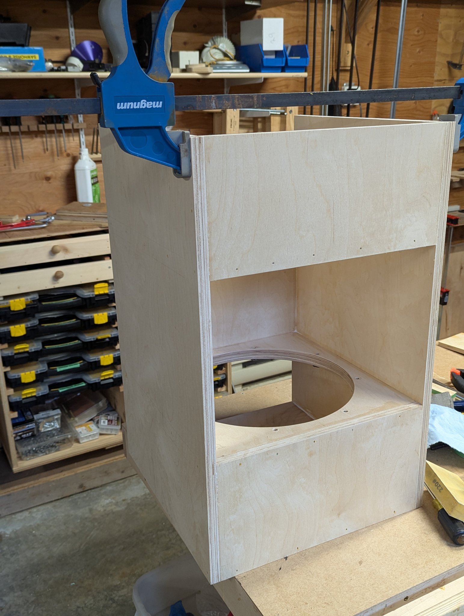

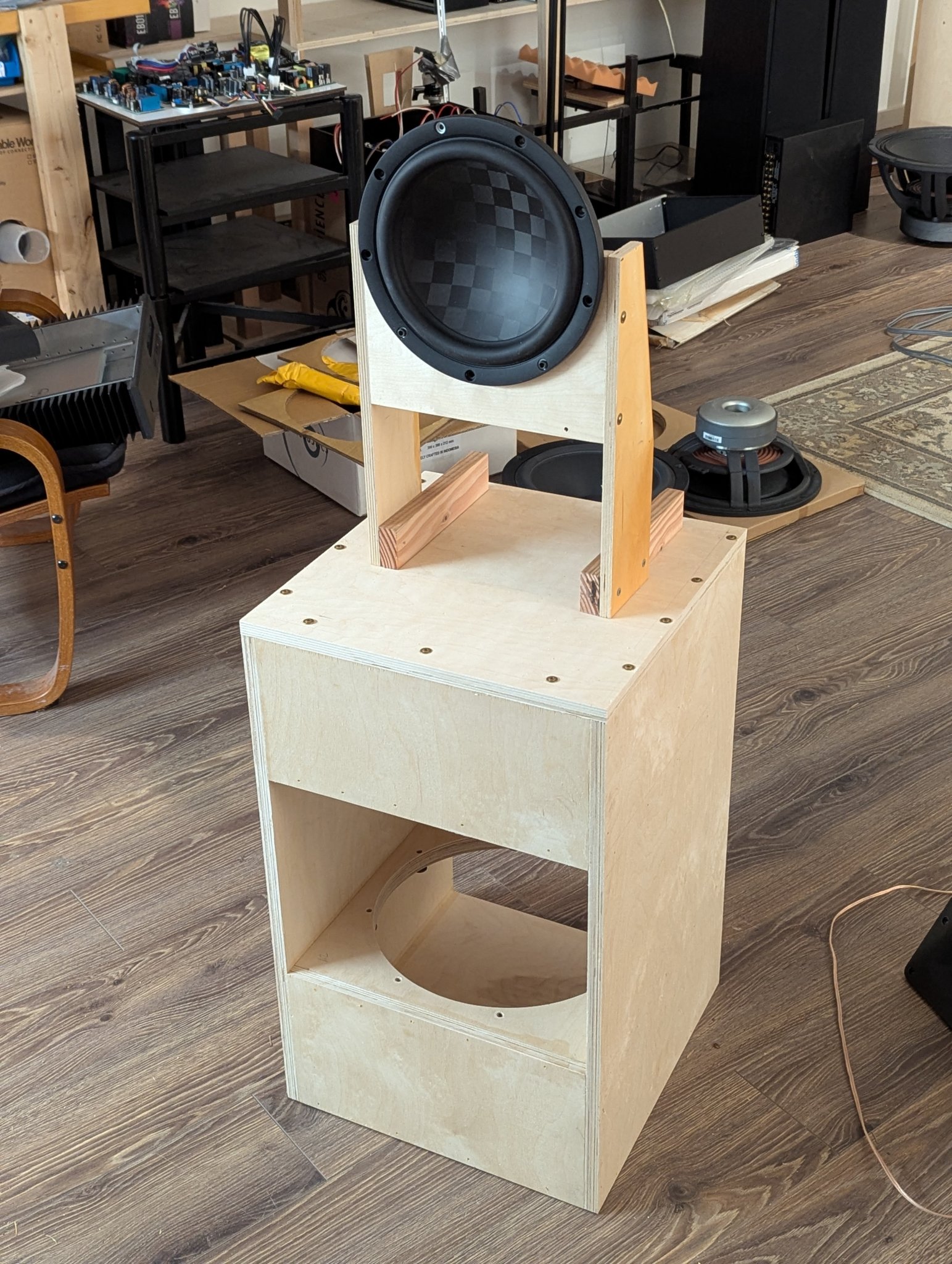

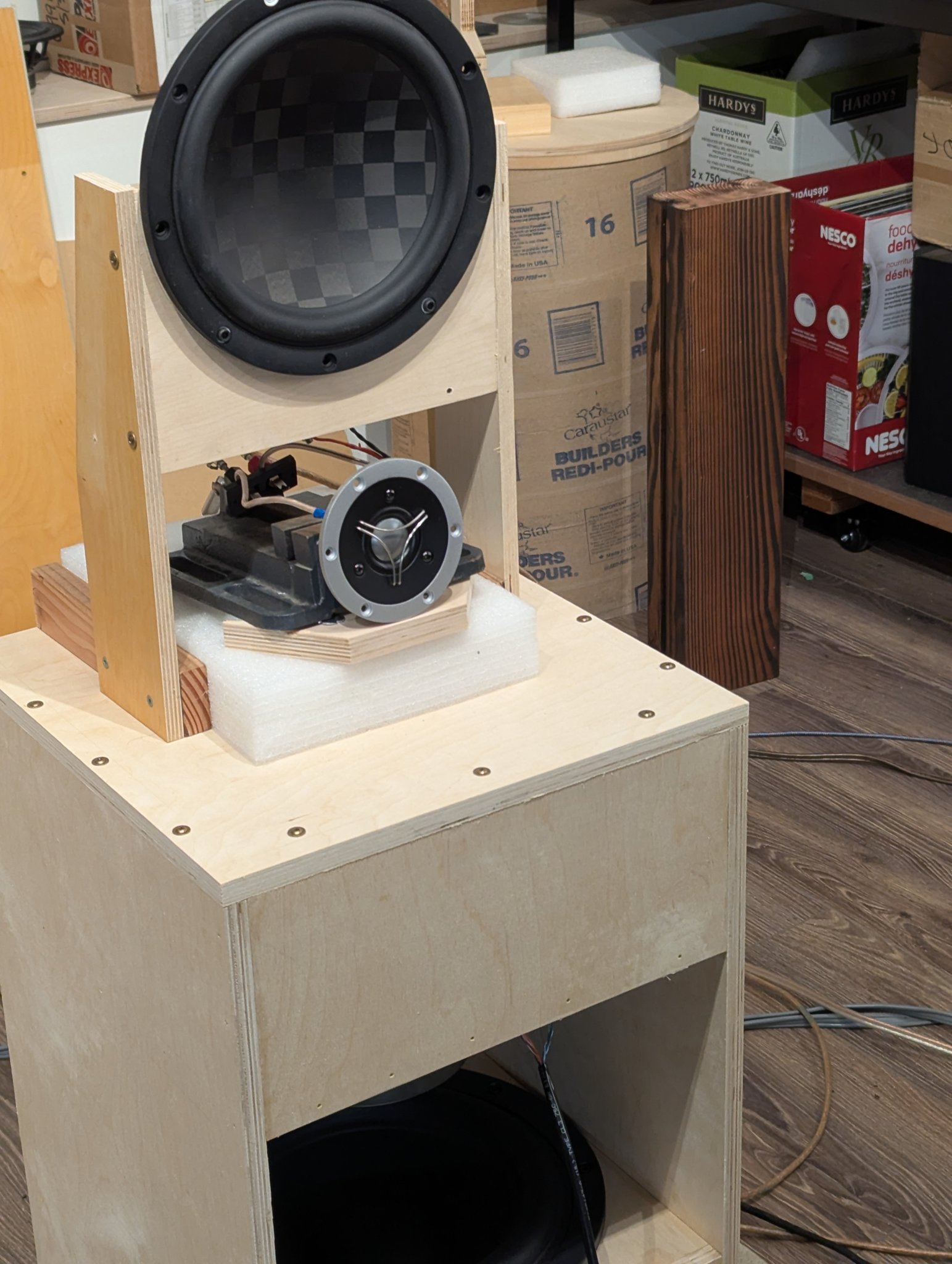

This project continued on, despite absence of responses to my last post: Still force-cancellation bass but OB now, and monopole for >1khz. A reversal of the original header for this thread. 😬🙄😆 Such is the nature of a journey into the unknown (to me).

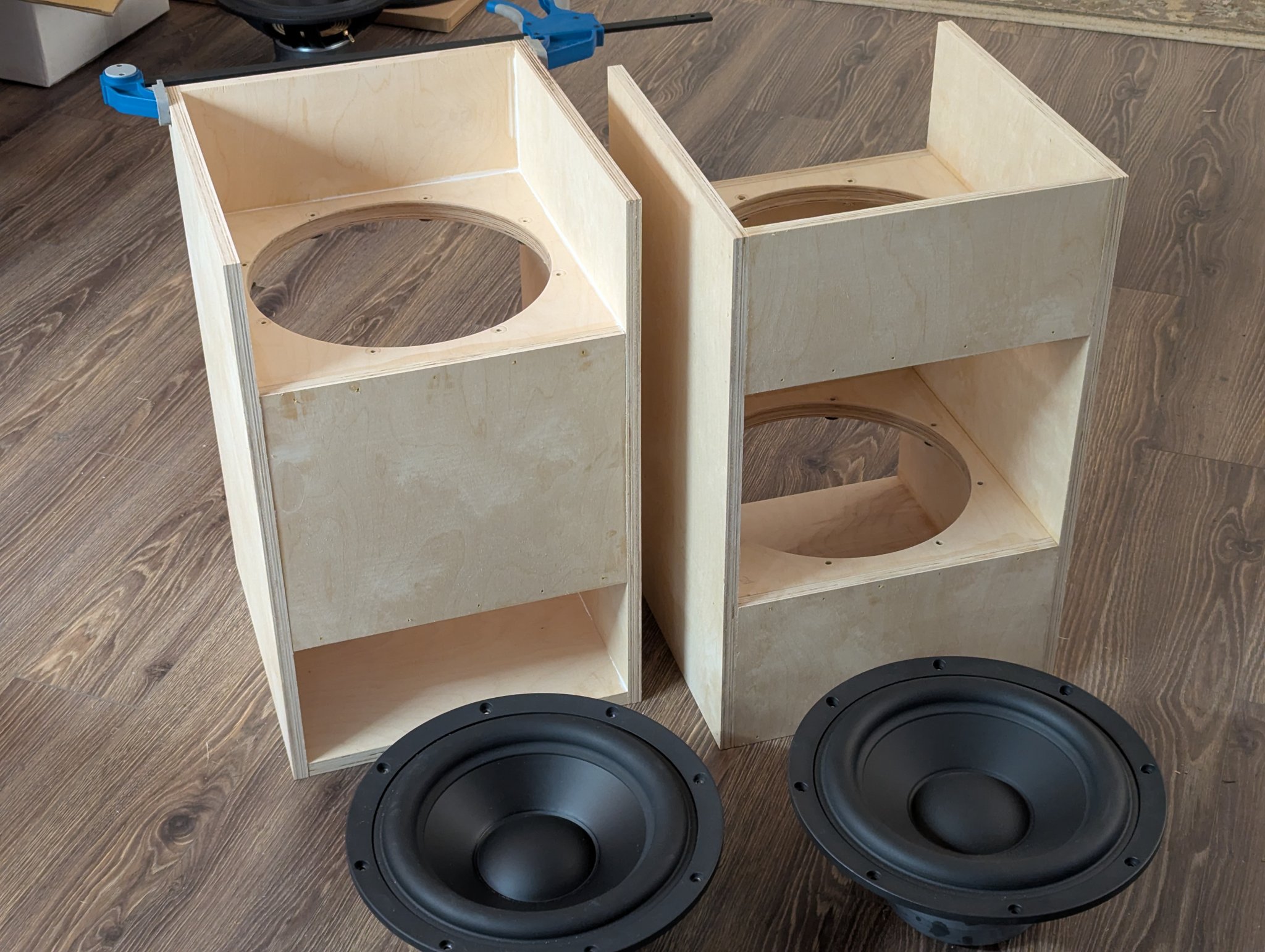

The first task was to build the W-frame dual 12" bass boxes. I used 24mm thick BB ply for the driver baffles, and mostly 15mm BB for the rest. A layer of 18 or 25mm solid walnut or maple would be glued to most of the external surfaces anyway.
One of the 4 SB34SWPL76-4 was backordered, so for the time being I'd have to substitute two SB34NRX75-6 on hand for one of the bass bins. I figured I'd be able to match them closely enough with PEQ up the 150Hz max.

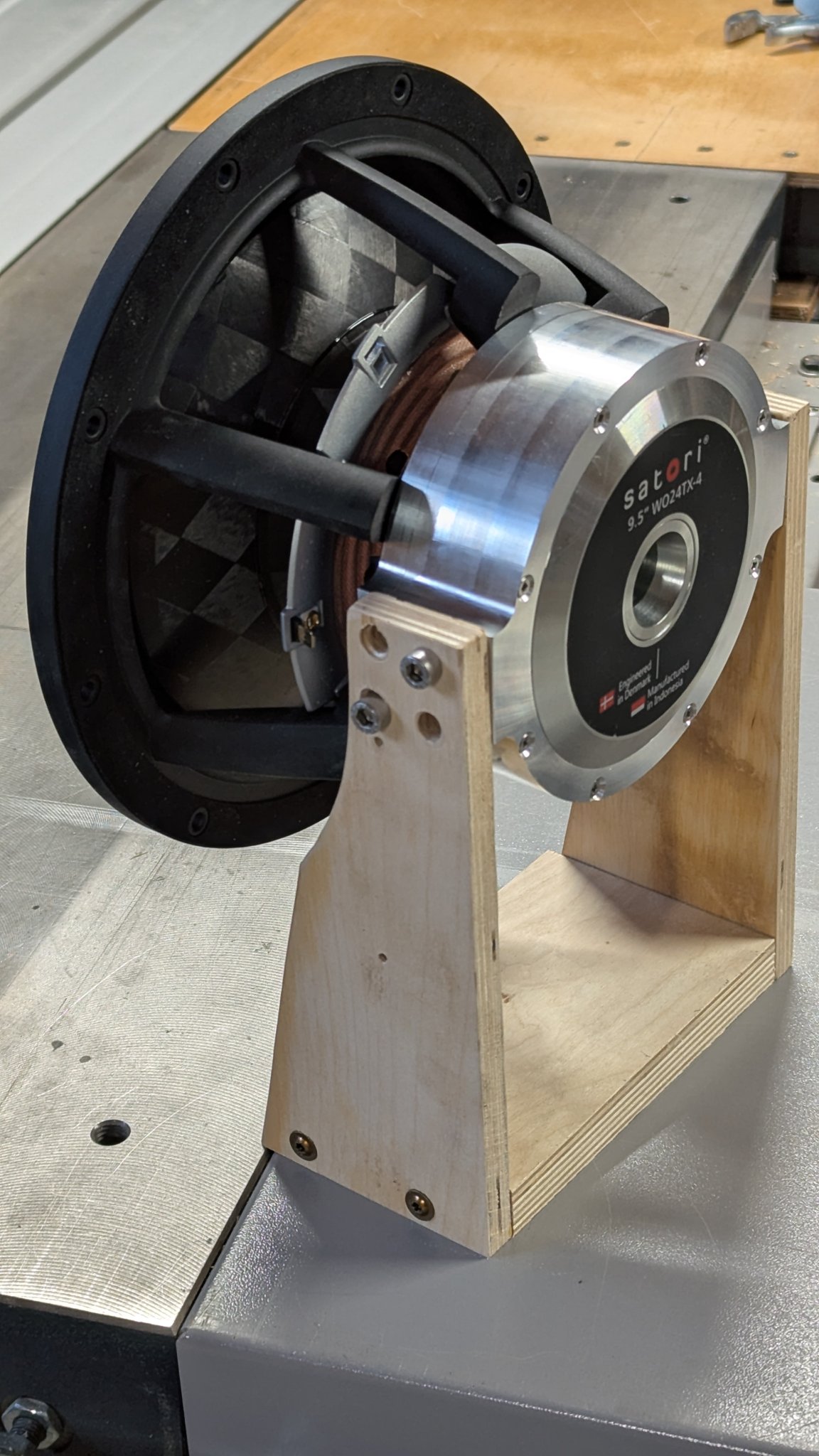

The WO24TX to be used as a mid up to 1~2 khz would be magnet mount to prevent its vibration from exciting the main upper baffle. This a temporary BB mock-up.
