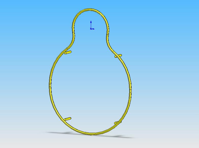

I believe that NHT does have grilles for the XdS speakers available, but you will have to contact them.
Making a grille yourself is going to be very difficult, since the XdS grille was bent out of thin wire and welded together. I've attached a rendering of the design. The dimensions for the location of the four locating pins are:
Wire diameter 3.7mm
Vertical spacing 97.4mm
Horizontal spacing 116mm
