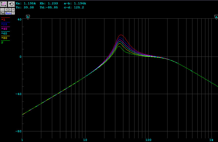

X1 EQ Curves
I have attached the stock X1 EQ curves if anyone is interested in seeing what they look like... and if they might be useful to one of your projects. The curves represent 20% turns of the EQ knob.
Jack,
If you had a chance to modify a X1/2 schematic to work with the XdW, I will update my simulation and post the results here.
Jack,
