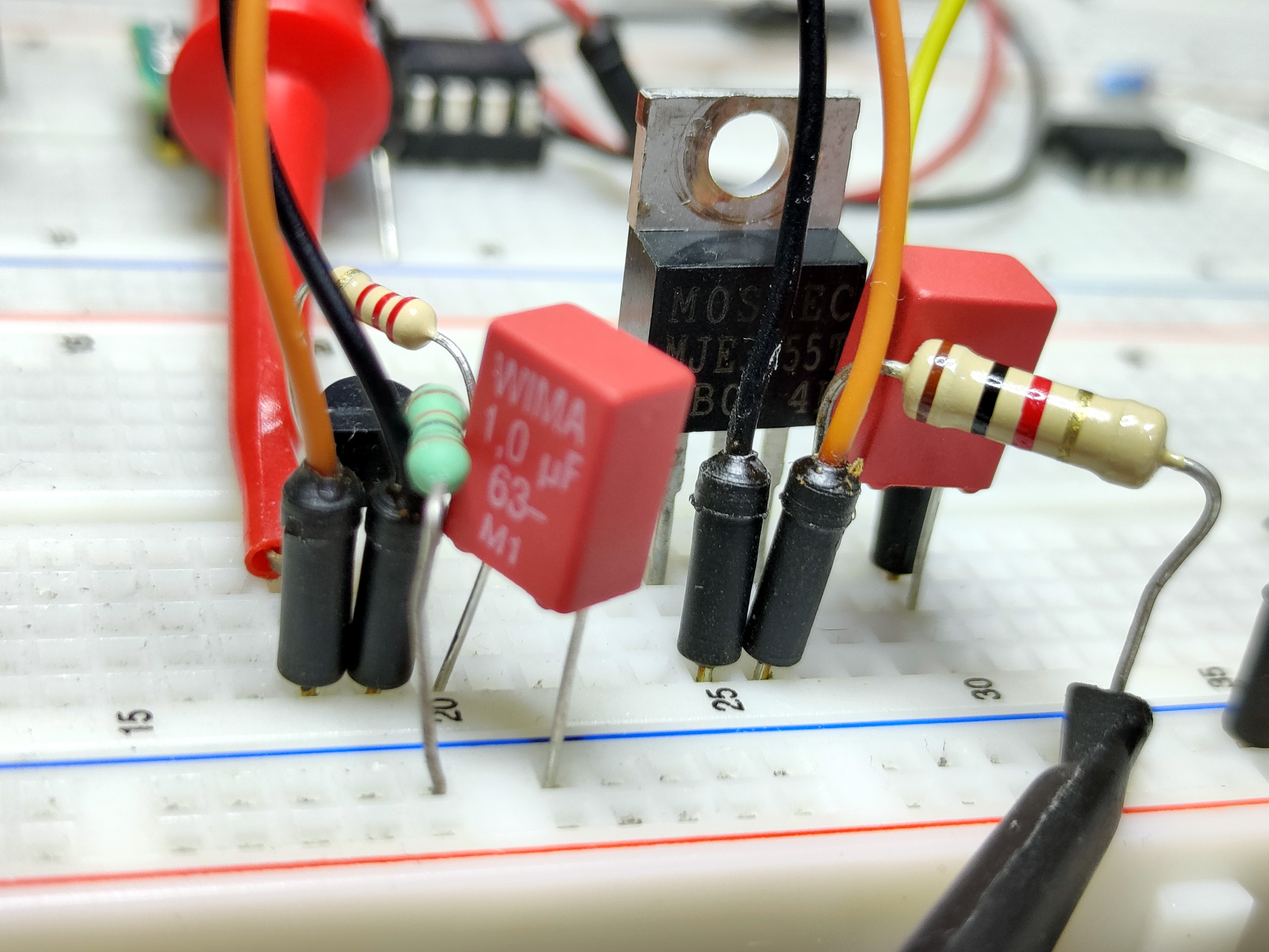

Weak and quirky in Rongon's situation, maybe more purposeful if augmented with a pass NPN or NMOS. To can deliver some useful current peaks. Tried with MJE3055T and IRF640 in low voltage, they work there. In HV maybe there will be surprises again. Better the BJT in LV because VGS loss is too much comparatively.
Collector to Vin, base to LR8 out, emitter to the load (that bigger 1k resistor). I used 1uF Wima Cadj and another one for Cout parallel to the load.

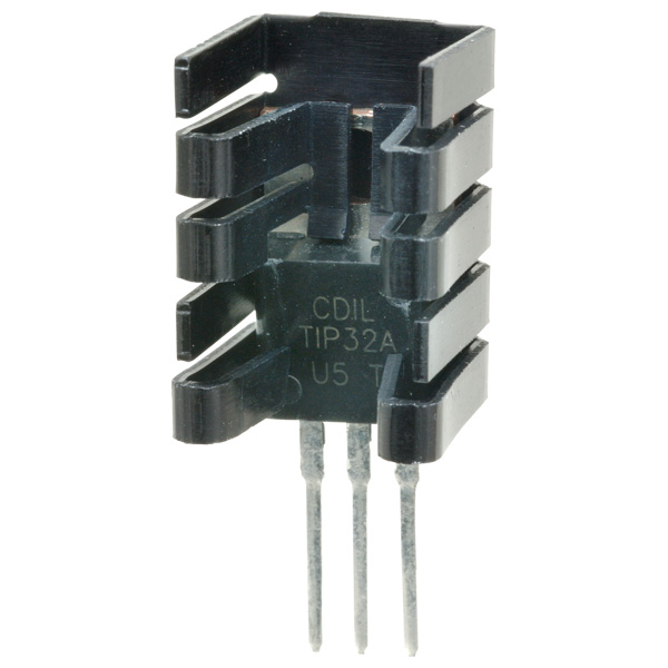

I have a small collection. I could use ZVN0545 (TO92 case), which would be the lowest capacitance choice. I'd have to raise the value of its source load resistors to something like 47k or 56k though. I don't want to do that.
I'm currently using FQPF2N70. They're in the TO220FP case, so have a plastic covered tab, not live metal. They're not as low capacitance as ZVN0545 but are low enough, and they're more robust. Just not robust enough to survive my ham-handedness! LOL
I have a bunch of clip-on sinks like the one in the picture below...
The way I had the MOSFETs biased, I actually don't need to heatsink them. A TO220FP case is good for up to about 1W Pdiss. However, when I swapped in the passive RC, I misjudged the voltage drop, and the audio PCBs got over-voltaged a bit. The caps and resistors are all over-rated enough to withstand that, but the MOSFET dissipated right about 1W for a bit. I'm sure that's what fried it. Now that I increased the resistance of the first PSU CRC, the MOSFETs are dissipating 800mW. That's low enough to work without a heatsink, but I've learned my lesson. Always put heatsinks on TO220 devices!!!!

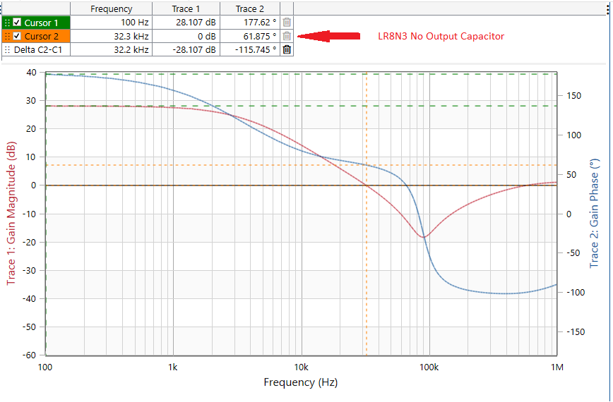

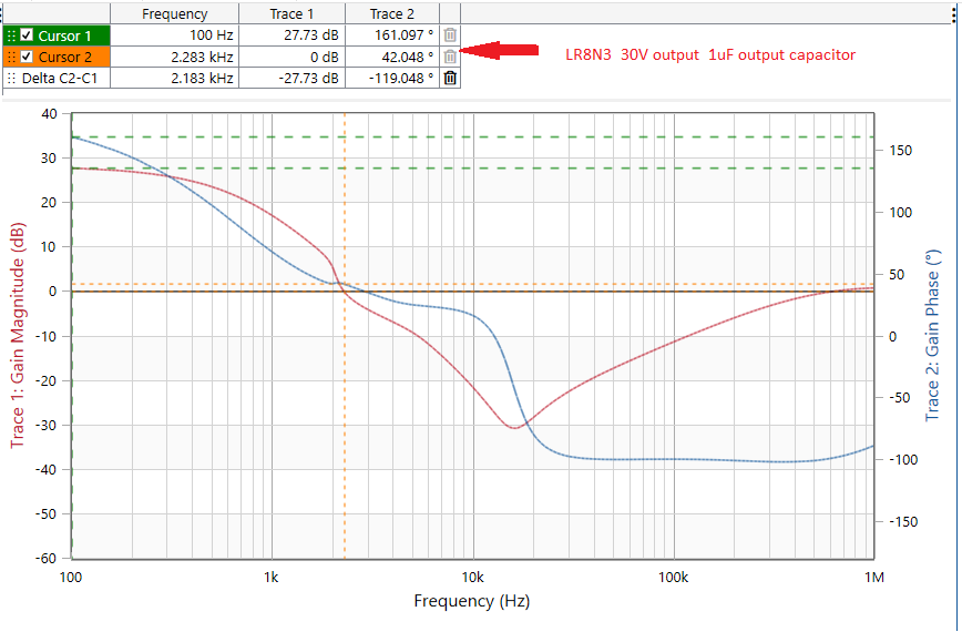

I ran some tests on the LR8N3 with a 30 Volt output, 7mA load, 42 degrees of phase margin with 1uF ASC film cap @2.3kHz, and 62 degrees at 32kHz.

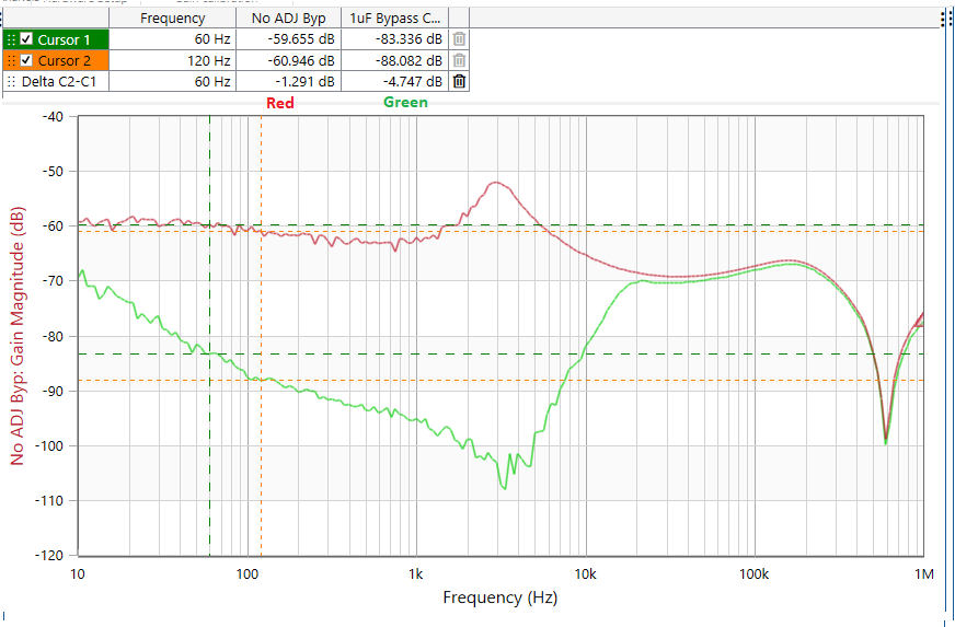

Well, it doesn't look like there's much ripple suppression there.
What if the OUT bypass cap is 10uF?
What if the input voltage is +345V and the output is set to +315V?
The LR8 is rated for up to +400V out, but is it useful at those high voltages?
