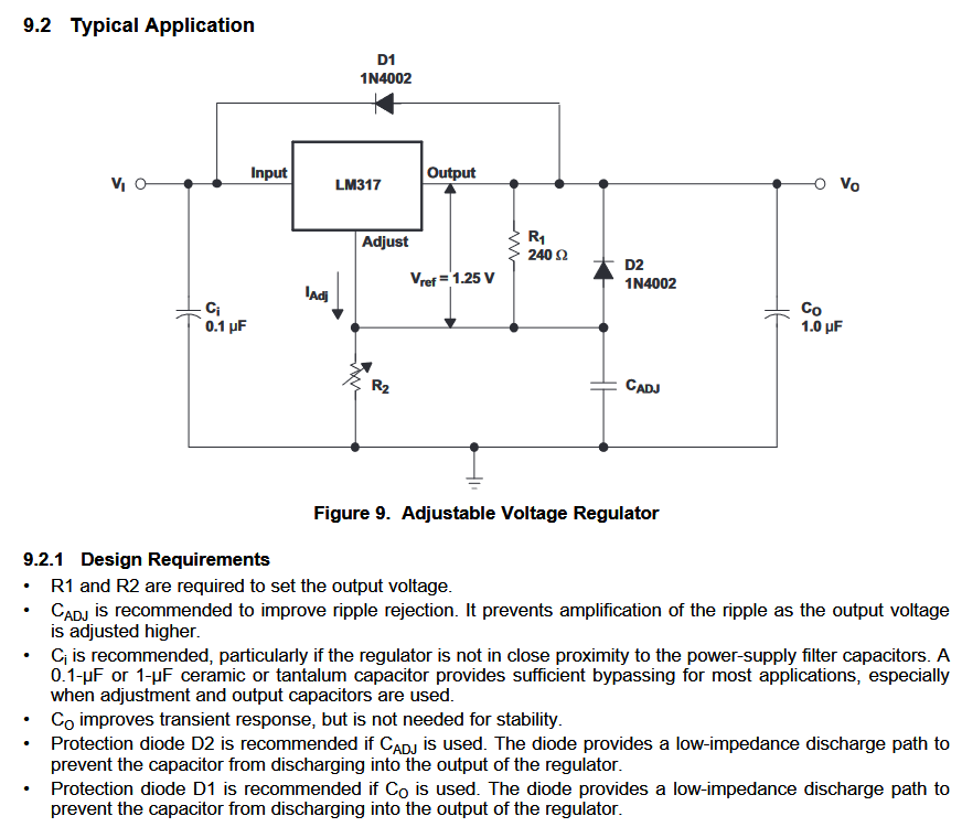

I wonder if the inrush current you get due to Cp and C10 triggers the protection. If so, a capacitor across R21 (with a protection diode to the LR8's input) might help it starting up as well as suppress its noise.
Across R20 to output maybe? That's how its practiced in LM317 at least.
"Protection diode D2 is recommended if CADJ is used.The diode provides a low-impedance discharge path to prevent the capacitor from discharging into the output of the regulator."

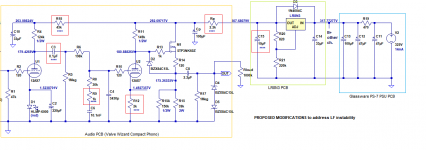

I have a couple of tasks in front of me. First, I need to replace R18 with a much larger value part. I have some 20k 1/2W metal film resistors. I figure the 12AX7 is going to draw only about 750uA of plate current, so...
20,000 ohms * 0.00075A = 15V
15V * 0.00075A = 0.011W
I think a 1/2 watt metal film resistor should be fine for R18. Yes? No?

Is this the correct way to implement the reference noise filtering capacitor and the protection diode "D2" from LR8 ADJ to OUT?
The protection diode is labeled D6 in the attached schematic.
Reference noise filtering cap is C16.
R22 (10R) is added because it seems to be standard practice.
Yes, I think it is. I don't know what R22 is meant for, but it won't harm as long as it is << R20.

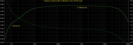

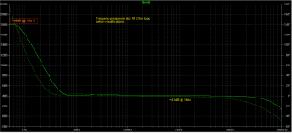

Meanwhile, auditioning the preamp yesterday, I had trouble with motorboating. Obviously there's a low frequency instability.
I can't figure out how to do a spectrum analysis display on my Rigol scope, but I do see problems in the subsonic regions. So I went back to LTspice and tried to replicate the issue there. It didn't take me long to figure out what the problem is.
I had designed the circuit to play down to 20Hz driving a relatively heavy load of 10k ohms (typical input impedance of a class D amp or similar). What I didn't count on was that into a 100k or higher impedance load, the preamp makes a huge (+14dB!!!) boost right around 1Hz 😱😱😱: !!!
The first image attachment is the frequency response of the existing preamp circuit into a 1M ohm load.
OK, I need to fix that. Obviously.
I had to juggle several things to get that resonance under control, maintain low audio frequency response, and minimize the amount of parts transplants I'll need to do. I think I've succeeded. The second image attachment is the newly updated schematic. The updated parts values are shown with "****".
The third image attachment is the predicted frequency response into a 1M load, after the changes. There's still a shelf where the response stops rolling off below 10Hz, but it's several dB below the response in the audio band. I think (hope) it'll be OK. Of course, into a heavier load the low frequency response rolls off more quickly.
The changes are:
C3 - originally 0.22uF, now 0.1uF
R18 - originally 4.7k, now 43k 1/2W metal film
R9 - originally 1.43k, now 1k (only makes a minor difference)
R12 - originally 1.5k, now 2k (to keep the cathode 1.5V above the grid)
Rp - originally 1k, now 2.2k 1/2W metal film
C15 - originally 1uF, now 10uF 400V electrolytic
The first stage 12AX7 is now run on the lean side, with only about 650uA of plate current. But that's commonly done with 12AX7, so I hope it will be OK.
The second stage 12AX7 also runs leaner, at about 750uA plate current.
The source follower MOSFET runs at 5.5mA drain current. I understand that MOSFET devices typically have rising gate capacitance when run at less than 5mA Ids.
I hope to be able to get these parts swapped this evening.
