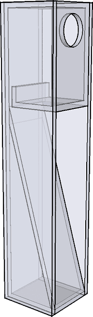

Dave, I know u r overloaded with volunteer work, but if u can dish out some numbers for either FE107E, or el cheapo or TB, would love to cut some plywood. (I have the drivers all wanting a box)

Scottmoose said:
We're way ahead of you Greg. Already done. 😀 As Dave says, they're up on the Frugal-horn site. Direct link: http://homepage.mac.com/tlinespeakers/FH/download/SuzyChang0v9-NBVR-map.pdf
oh, my... I knew I was in trouble when the experts named the cabinet...
looks simple to build, stylish, not too big (at least until we move to a mansion, although prefer BIG..)
Thanks, Scott and Dave as usual. Don't try to contact me this weekend, I will be occupied in my garage....
gychang😉

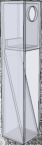

Now they are quite cute little numbers...
Anyway on filling the bottom cavity.
1. Will anything do? plain river sand, kiln dried sand what they call 'sydney sand'? or paving sand?, lead shot? - no idea where to get that, but can probably get paving sand from bunnings...
2. pour straight in a back hole, or in some sort of 'glad bag' clip seal bag or plastic bag...
3. I've glued them together so I will have to drill a hole in the cavity area on the back somewhere... - what should I plug it with, or how big a hole?...

according to some of the NRA members of Hornshoppe Forum, copper clad shot (cyro treated, of course) would be the best. :angel:
In all seriousness, though, I'd probably fill only the bottom 1/3 or so of the void, and step the remainder. For my filling media, I've been quite happy with a silicon carbide sand blasting material. I'm sure there are any number of brand names available at industrial building supply or auto paint supply dealers. IIRC, the one I've used is called "SureShot" or some such. The local high-end audio dealer uses it for filling their speaker and equipment stands.
Drill a hole on the bottom of cavity and fill with glued in tapered wood plug, or simply add another layer of plywood /MDF before finishing the cabinet.
