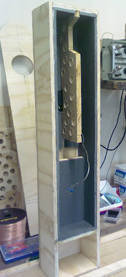

completed stuffing of one enclosure:
complete with some poly fill:
Tested one speaker with clamps, and actually sounded pretty good, so I will stick with the fill & complete the second one, then glue together & test for a while then do the finish to the wood.
the Poly fill looks denser than it actually is.

stevodude said:complete with some poly fill:
My 1st reaction was way too much... some data from an unfinished experiment suggests that the polyfill is best if only between a point that is between bottom of the driver & bottom of the holey brace, and the port opening.
dave
well I dropped the stuffing down with just a loose amount between bottom of driver and end of the holey brace. Anymore I can stuff from the terminals or the driver holes.
Glued the front on, and doing initial testing it actually sounds pretty darn nice, specially light rock, like John Mayer & Teh Cranberies starting to sound really sweet.

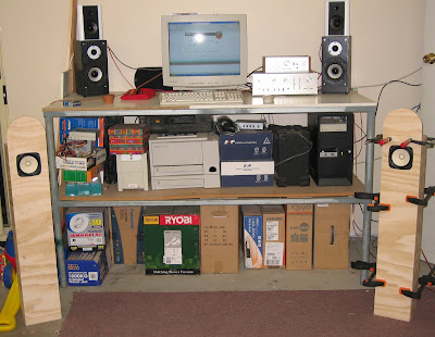

finished one enclosure, but no finish on the wood yet.
Almost completed the second one, just have to stick in the dampening/driver & binding posts... not long now for complete stereo testing 🙂
but sound is great, VERY detailed, good solid mid/bass, not pounding but clarity is great. top end in direct ear view is a tad sharp, but this is in a large workshop, so will be good to try out upstairs soon as second enclosure is completed ( probably by the weekend ), 2 lil children makes it hard.
Next up will be some sort of grill covers to keep my (almost 4yr old) fingers away from the drivers...

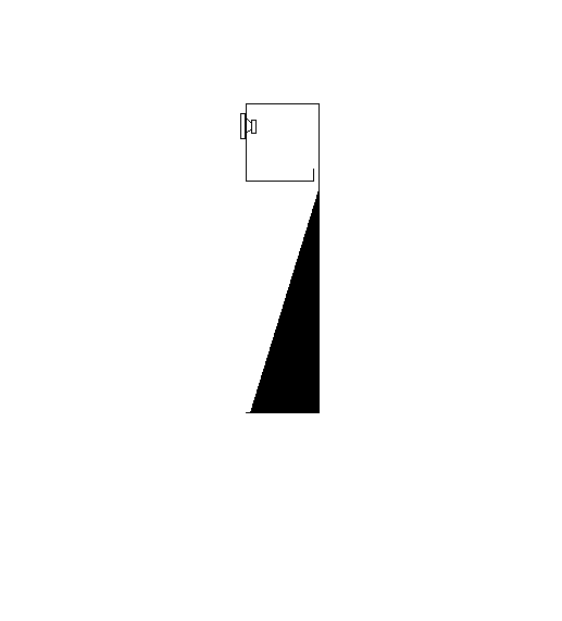

Here's one idea. Build the recommended Fostex reflex box, above a Chang style vent 600mm tall, internal. Instead of using the port on the Fostex design, a slot vent at the bottom-rear of the chamber, full internal width, 12mm deep & 60mm tall (including the thickness of the material). Like the rubbish drawing attached, though it should give you an idea of what I'm blithering about. Might need a little damping to kill the spurious resonance you can see on the extreme right of the graph. Doesn't control the driver as well as a horn would, but you'd probably need to go to a full-size horn to get LF excursion down within Xmax.
Scottmoose said:Here's one idea. Build the recommended Fostex reflex box, above a Chang style vent 600mm tall, internal. Instead of using the port on the Fostex design, a slot vent at the bottom-rear of the chamber, full internal width, 12mm deep & 60mm tall (including the thickness of the material). Like the rubbish drawing attached, though it should give you an idea of what I'm blithering about. Might need a little damping to kill the spurious resonance you can see on the extreme right of the graph. Doesn't control the driver as well as a horn would, but you'd probably need to go to a full-size horn to get LF excursion down within Xmax.

When i get home i'll whip up a drawing... anyone suggest a name. A bit of whimsy please (ie working name for the FE167 Chang is "Chili Chang".)
dave
dave
planet10 said:When i get home i'll whip up a drawing... anyone suggest a name. A bit of whimsy please (ie working name for the FE167 Chang is "Chili Chang".)
dave
Dave, brilliant, CC sounds better than CSC (Can't Stop Chang). My driver on deck is FE107 (4" shielded), wish I had 167 though.
gychang

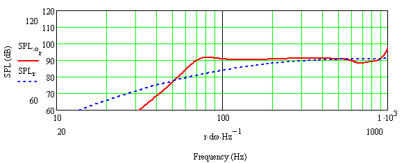

The response is mostly the same as the regular reflex box (which is basically what it is -I don't pretend it's anything else), but the end correction to the vent isn't going to hurt, especially as it should help direct the output at the listener. Plus, it makes a neat stand & an interesting looking little floorstander.
You can go madcap & do a doubled version of course -just shift the driver to the middle of the reflex chamber, reduce the depth of the slot vent to 6mm & add another at the top of the chamber.
Yes, I'm certifiable. Gibber. A curved front version might be interesting? Have the set of 4 -107, 127, 167 & 207? I don't like to bother Ron as he's so busy at the moment though.
