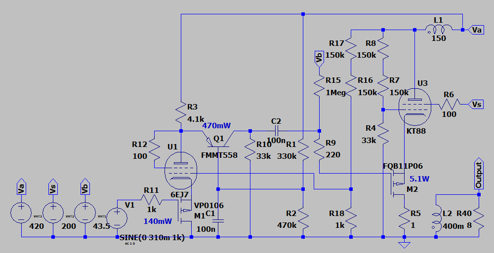

Folded/Shunt Cascode driver for 211
I have had some time to try a couple of things on this. First, I built a simple voltage source for the base of the cascode transistor made from a CCS feeding a bypassed resistor. I then added a ZTX558 follower to drive the cascode transistor base.
Unfortunately, neither circuit has improved on the noise performance of the measurements from post 28. Is this circuit just a lot noisier than the CCS-loaded pentode? I really expected some improvement on noise performance.

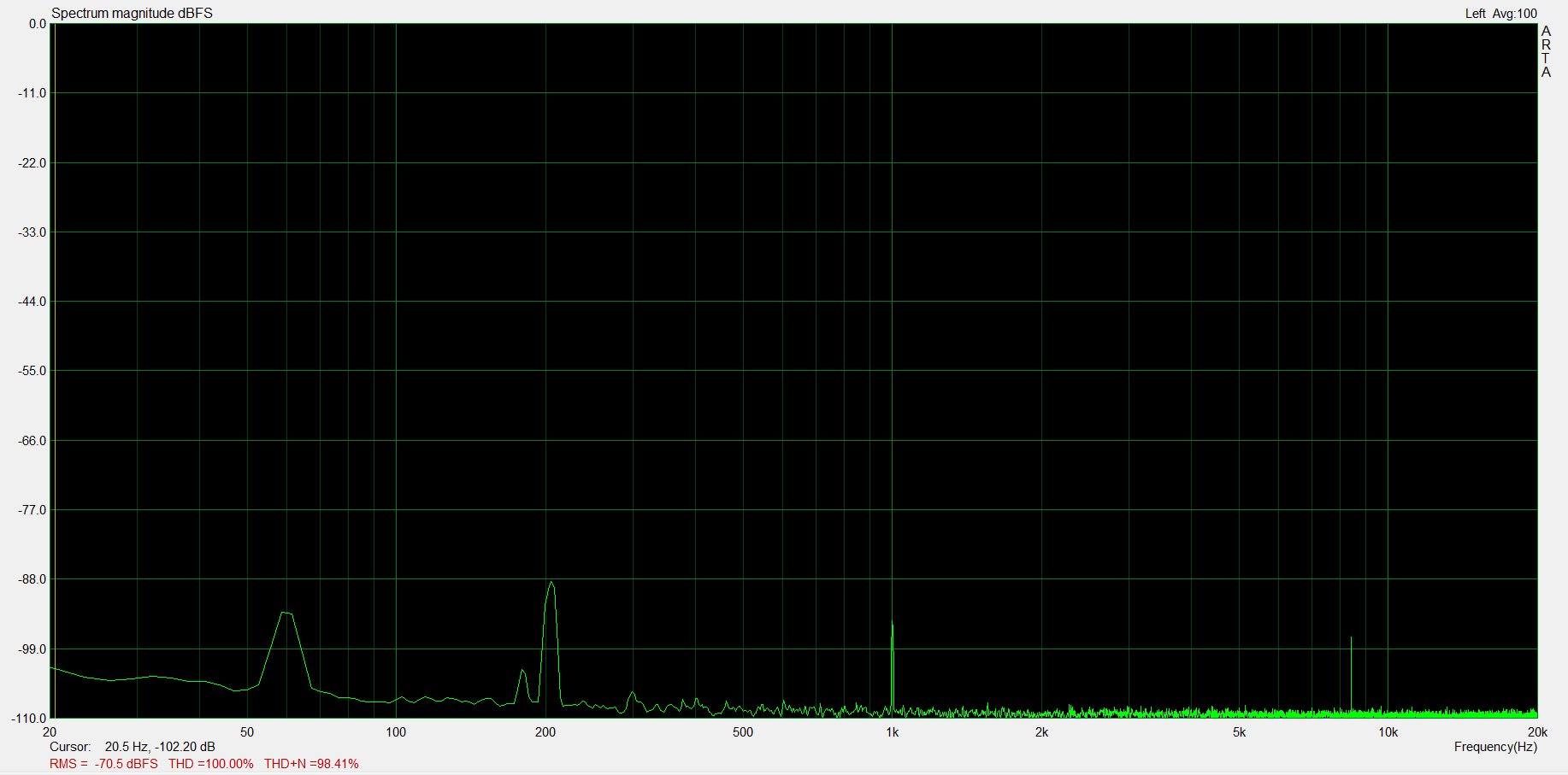

I guess I'll have a look at my negative rail next but I thought it was pretty clean...

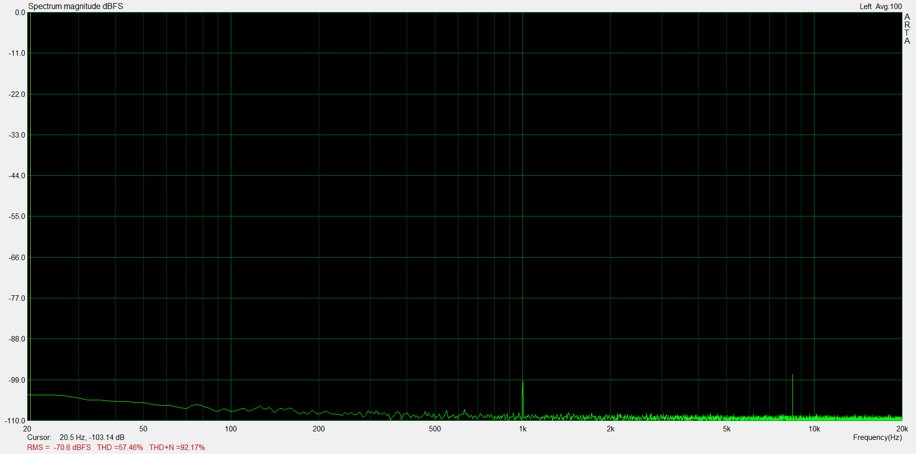

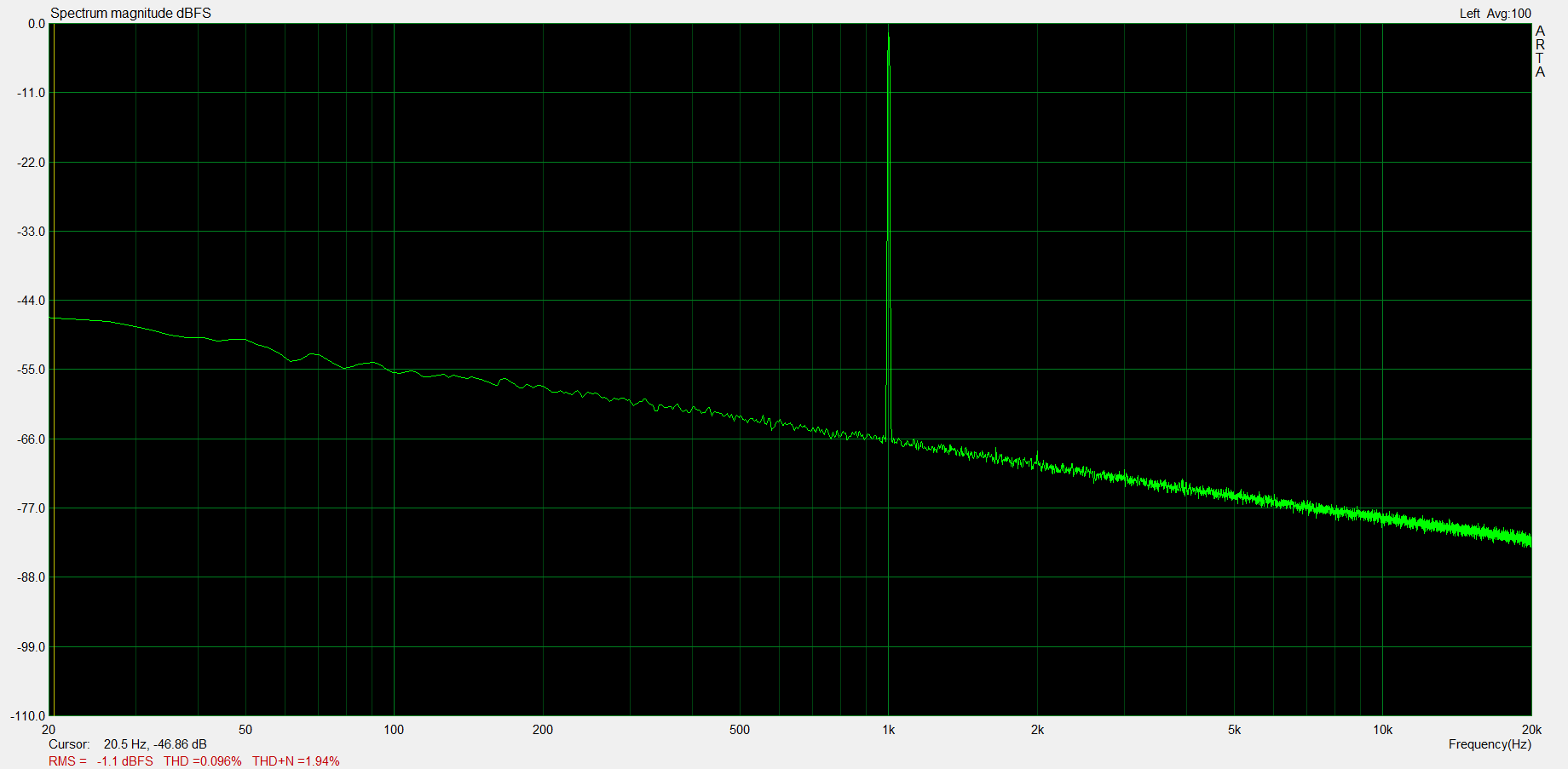

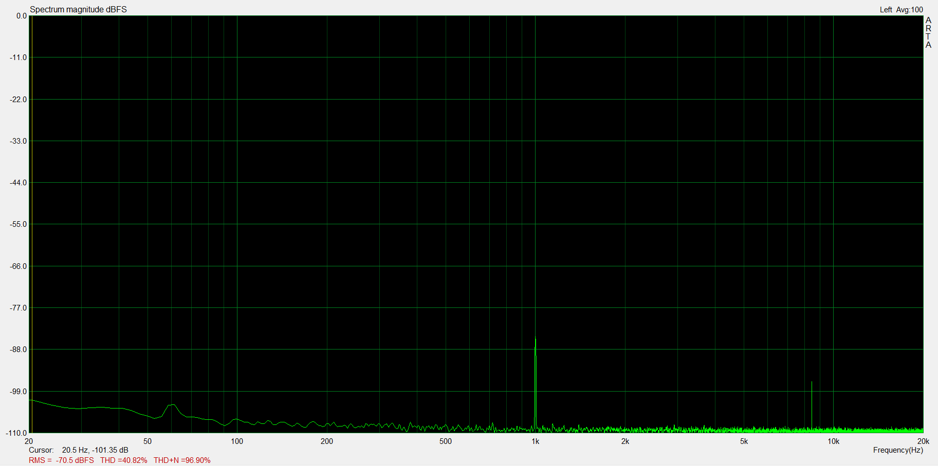

I just took a few measurements and attached here. All three are averaged spectrums during 22.5Vrms 1kHz test tone. Circuit output, negative rail, cascode base voltage, and GND.

It certainly does not look like the supplies are creating the noise, since they only add noise to the output. Then again, the base noise is added to the output current, so if the load resistor is a very high value, that might be a driver for it.
The other noise source is the driver valve - the noise if of course stepped up by the voltage-gain factor.
