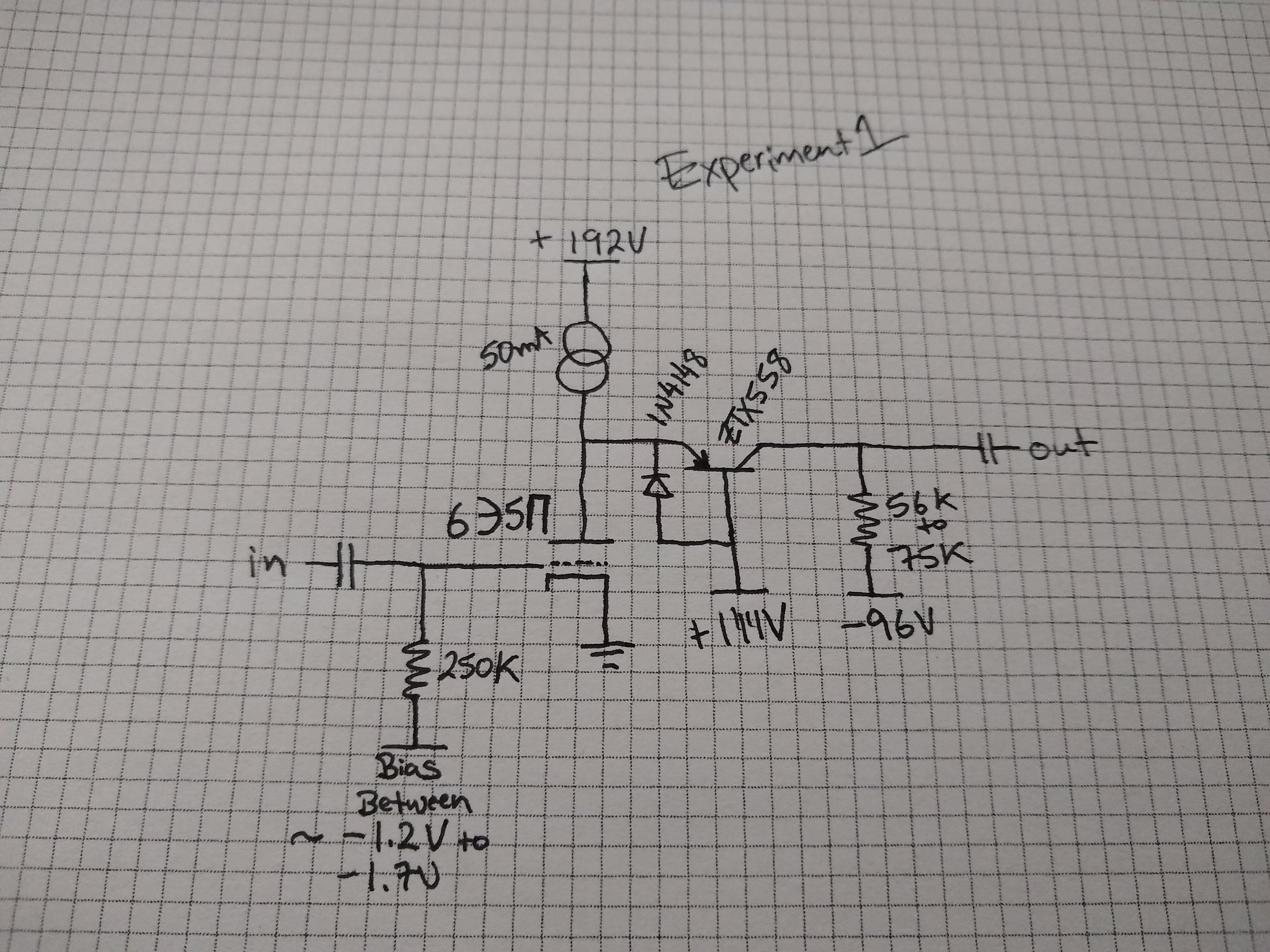

I have had some time to try a couple of things on this. First, I built a simple voltage source for the base of the cascode transistor made from a CCS feeding a bypassed resistor. I then added a ZTX558 follower to drive the cascode transistor base.
Unfortunately, neither circuit has improved on the noise performance of the measurements from post 28. Is this circuit just a lot noisier than the CCS-loaded pentode? I really expected some improvement on noise performance.
I guess I'll have a look at my negative rail next but I thought it was pretty clean...

I just took a few measurements and attached here. All three are averaged spectrums during 22.5Vrms 1kHz test tone. Circuit output, negative rail, cascode base voltage, and GND.
It certainly does not look like the supplies are creating the noise, since they only add noise to the output. Then again, the base noise is added to the output current, so if the load resistor is a very high value, that might be a driver for it.
The other noise source is the driver valve - the noise if of course stepped up by the voltage-gain factor.

I was thinking along the same lines. I think I will set this aside for a bit and try to optimize the original 6BN11 input stage operating point in my amplifier and see what I can get out of that. Then I'll put the 6E5P in and see how performance changes in the overall amplifier.It certainly does not look like the supplies are creating the noise, since they only add noise to the output. Then again, the base noise is added to the output current, so if the load resistor is a very high value, that might be a driver for it.

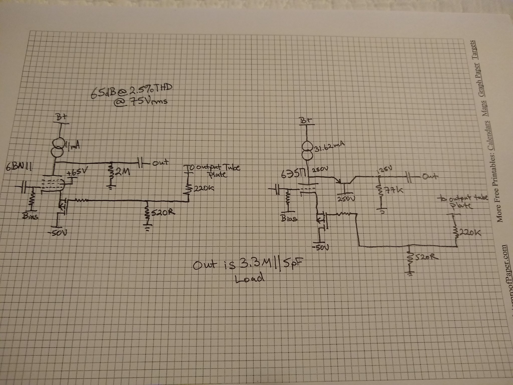

No, I set this aside after more staring at the noise floor, particularly the LF side of the spectrum. I have no more updates since this thread, but I still have the breadboarded circuit and ten 6e5p. I'd love to play more with this one some day.
It is still an amazingly low distortion level for that much output and gain.

It can probably be made to work, but local (intra-stage) feedback is much better served with a cathode resistor. You can DC bias the grid +ve to allow a wide range of feedback/cathode resistor values. No bypass capacitor.is it possible to drive the shunt cascode through a pmosfet source follower at its cathode and apply feedback (local, at primary of the output transformer, global) through its grid, like in the schematic
Driving the triode's cathode with a FET source is more difficult, since you must correct for the phase in a closed loop (OTOH, no phase effects for any practical Rk value).
Also the open loop distortion is likely lower with the resistor. With a MOSFET, the source impedance varies with current, and it faces a cathode which also varies in effective resistance with current.
New version Shunt cascode is drawn out, with many attractive performance improvements. I am still stuck with ongoing distractions, but will do it soon, if slowly.
As for connecting a closed loop, maybe you can try to feed back to the cathode from some driving node. With positive grid bias, a resistor large enough to allow a divider may be an option.
It is indeed, and it has a very good harmonic pattern. Looking forward to see your updates, when you’ll have some.It is still an amazingly low distortion level for that much output and gain.
Thanks! Please keep us posted! What will be the benefits of the new version?New version Shunt cascode is drawn out, with many attractive performance improvements. I am still stuck with ongoing distractions, but will do it soon, if slowly.
