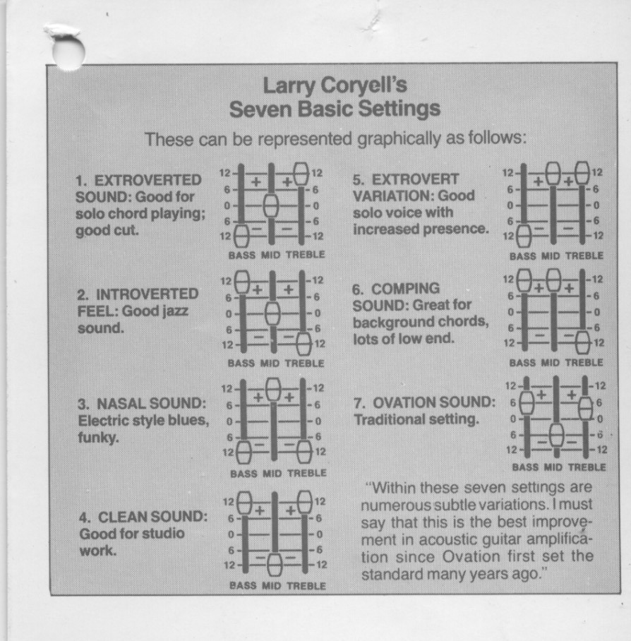

I forgot how to change the (over ten year old..) battery in my Ovation Elite, when reading the manual saw this:
24dB difference between Larry Coryell's "extroverted sound" and his "introverted feel" envelope shape.

Art I printed out Larry's settings, I need to do more of that. I have been going for clean, literally all tone in the off position to see what the guitar and horns can do. My video responses have been very very positive. A music head friend that I respect said "man so clean, so clear, so full, love it!" another said put this damn thing on Shark Tank, sounds great! I will not do that, just not part of my strategy. 🤔

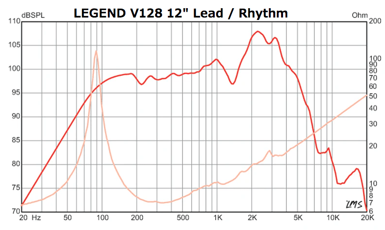

Most "classic" guitar speakers roll off steeply (18 dB per octave or more) above 3-4kHz, like this Eminence:
To avoid the on axis 2-3kHz peak, most engineers mic the cone to the side (off axis), and most guitar players point the amp at their knees..
The high E note at the 24th fret (a few frets higher than most) is ~1318Hz, very little past the fourth harmonic of the high notes makes it to the recording.
Your folded horn's high frequency response rolls off at a an lower frequency than an average guitar speaker, so also does not reproduce the upper harmonics of the acoustic guitar.When I play my guitar with the horns on, the tinny sound disappears
Since you don't appreciate the "tinny" upper harmonics, the rolled off high end is preferable to your ear.
The folded horn has it's own "tone coloration", it deviates greatly from flat frequency response.This FHAG holds its own without any need for amp tone coloration!
Your guitar amp is probably also "coloring" response at most any setting (you could measure the amp's transfer response to see what the gain and tone controls actually do), and the response of your two pickups are both quite different from the guitar's actual string and body sound.

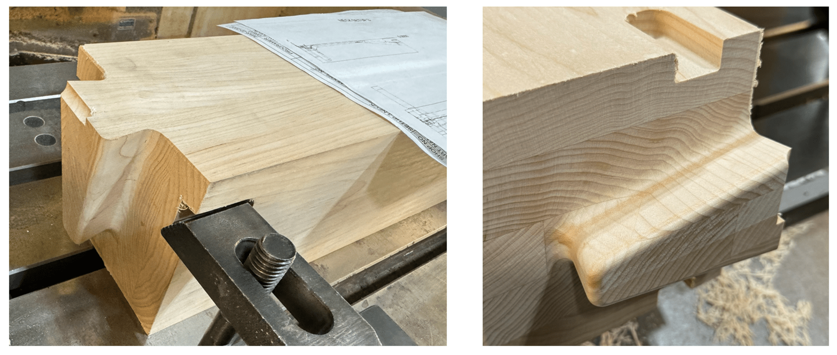

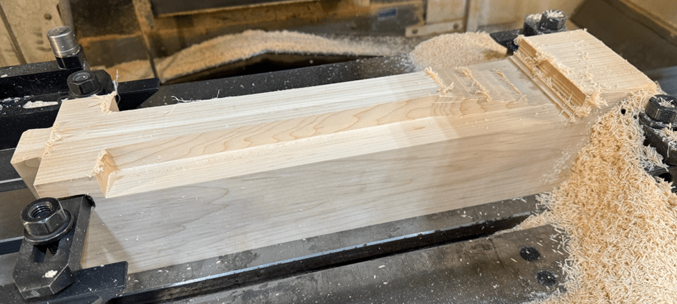

I finally have another neck being cut, a long wait, the CNC department finally has some time to do this. The dovetail on the neck and body are large, and have radii everywhere, no sharp corners to concentrate stress. The first one worked so well, straight as can be without any change over time, great intonation and great strength to last for decades!
I also have studio time booked for the end of June, will be the last one needed, then YouTube and Website, stay tuned!
Getting some more CNC time for my second neck.
