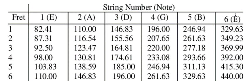

Yes I know 1st string is the highest, blues harp and piano are opposite this, FR data sometimes shows opposite also, should have said D string 4 not 3...

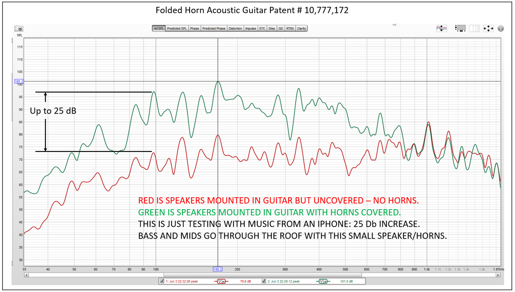

Not really. I agree I have used different methods, but it always shows a huge increase in SPL. Now the lows, mids and highs may be increased by different levels for different recording setups, but they are all generally the same. They all blow a standard acoustic guitar out of the water in, just by different amounts depending on setup, not even close.

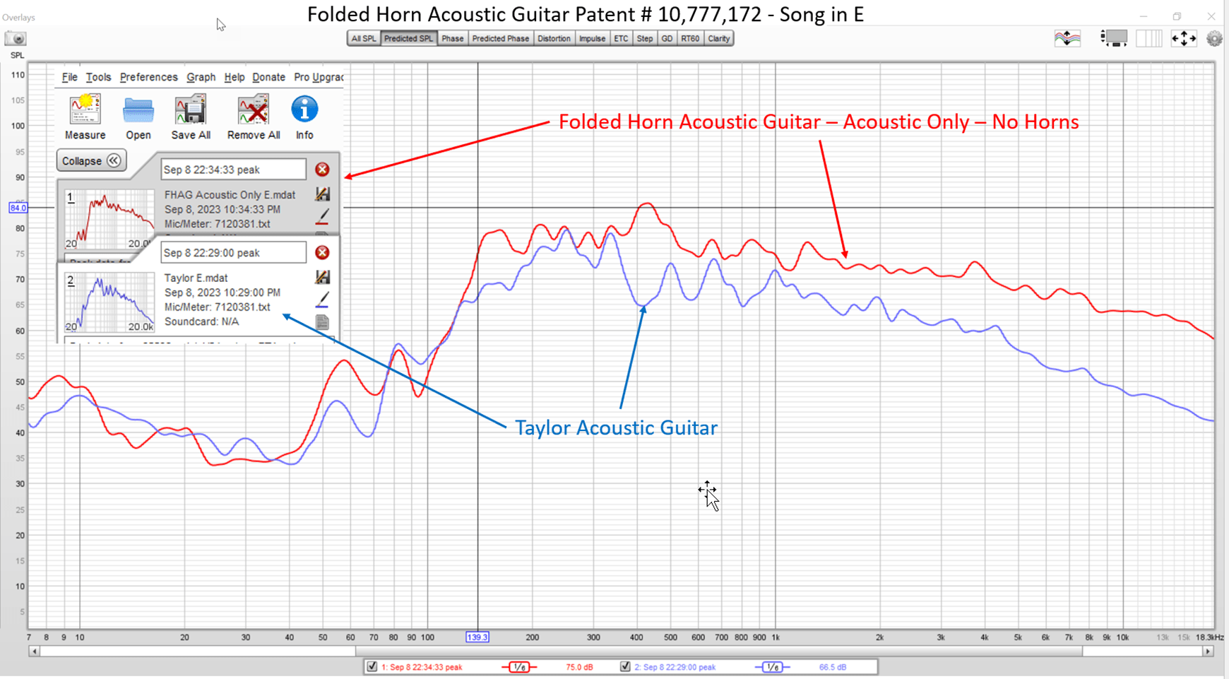

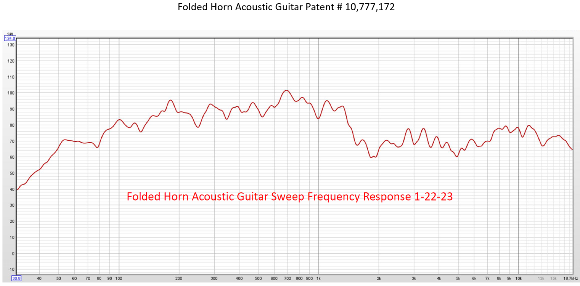

Sweep of the folded horns shown, love the lows as people by now know, don't see how the drop off at 1,000 Hz hurts, especially with the guitar sounding so good, in fact I think it helps.
Not much different than a Taylor, compared to my guitar with the horns off, oh yeah, mine is brighter.
Note this is a full song through the horns from an iPhone, it shows what they are capable of doing with 3" full range drivers I am using. Of course this includes a bass guitar. When I say lows go through the roof, I mean it, unbelievable what you hear.

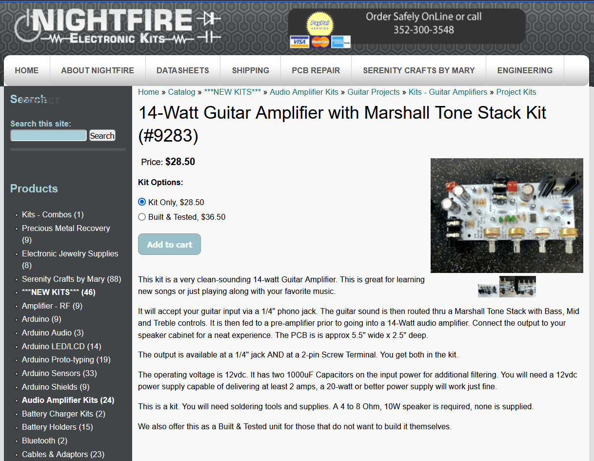

I wonder if you could get something like this inside one of the free spaces? It's <$40 built, takes +12V to run. It's a start toward an integrated solution, where you could pull it out of a case, turn it on and play. Solid state guitar amp DIY kits are pretty rare -
The string numbers are flipped on this chart, obviously wrong per your comments Art, meant 4 when I said 3...trust but verify.

I do need an amp kit, but what you show is not enough power, only 14 watts (using 30 watts now), plus it is likely for an electric guitar. That said, the right idea for sure. I have looked and not finding anything small enough just yet, but I have not researched in depth. Thanks and keep it coming brother!

Like I said, it would be a "start" and well within anyone's "petty cash", budget. They have 3 models, I assume differing in only how the tone controls are implemented. Unsure which tone control scheme would be most appropriate for acoustic play-through. You could easily ask what their opinion is. I think they were Fender, Marshall and Baxandall, Bax being more like a HiFi tone system than what's typically in a guitar amp.I do need an amp kit, but what you show is not enough power, only 14 watts (using 30 watts now), plus it is likely for an electric guitar.
I'm pretty sure they all use the same power amplifier and would bet it's a common "Chip-Amp". The thing on the heat sink. It'd be pretty easy to get a built one, get a second kit of the same - slice off the power amp section of the second and connect it to the same driving audio signal on the built board and 12V battery power. Voila! Now you have "14W" for each speaker; just the way I think.

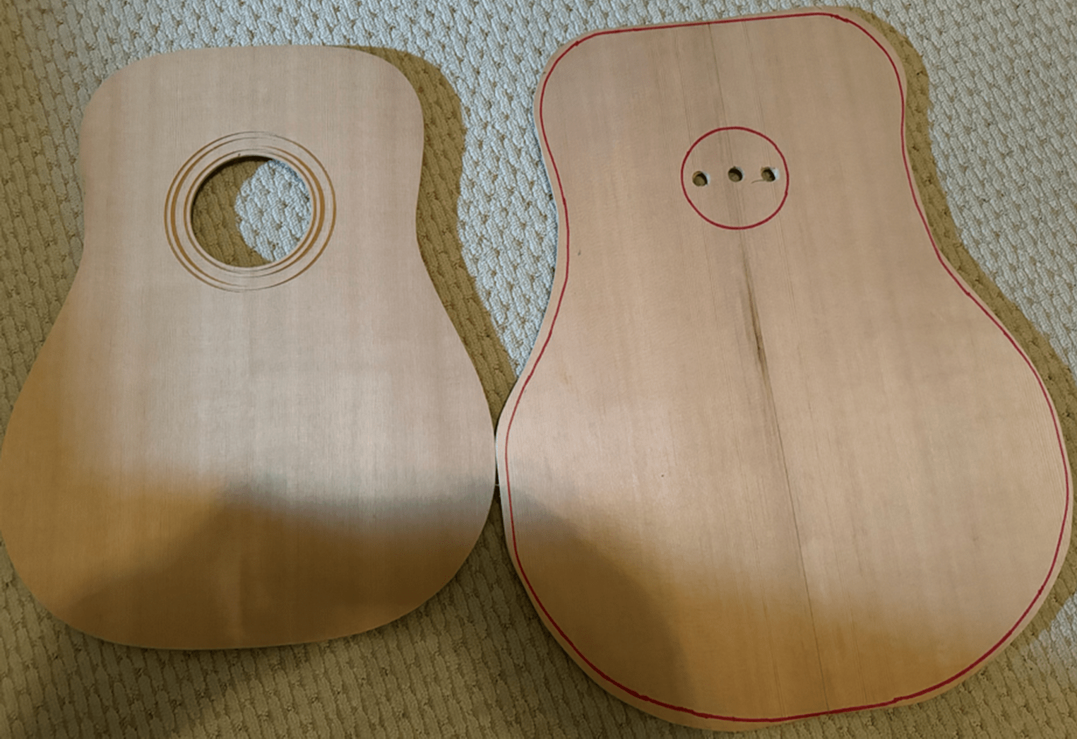

I have the back ribs mostly cut on my new Sitka Spruce soundboard for the FHAG ( shown to the right). A standard Sitka Spruce Dreadnought soundboard is shown to the left. When I do a tap test, they both sound great, but mine is so much bigger, it just rings like a bell, with so much more power.
I am using the same light but strong design that worked with my Birch soundboard, BUT a Sitka Spruce soundboard may not be able to handle the stress from the strings, just not as strong. I am thinking "brace the braces". My braces are cut in solid and very small compared to standard Dreadnought braces.
This provides the light requirement, but will it be strong enough with a delicate wood like Sitka Spruce? Doubtful. Braces that "connect" the braces will decrease deflection, but still allow the soundboard at it thinnest area to ring with vibration. Will it work? Unknown, let's try!

That is for sure JJ, bracing is an art and a science, I have seen many of these examples. My goal is to get a very light yet strong soundboard from Sitka Spruce now, used on violins almost exclusively. This was not too difficult with Birch, but Sitka Spruce will be more of a challenge, hence the bracing on bracing idea. I have never seen this, maybe for good reason, maybe it will not work, but maybe it will, test, test, test!
My big Sitka Spruce soundboard ringing like a bell is a great start, now I need to prevent the string tension from destroying it!
