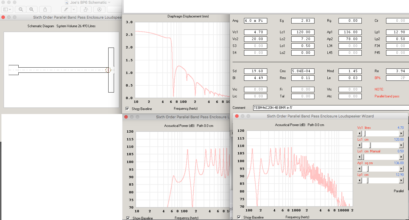

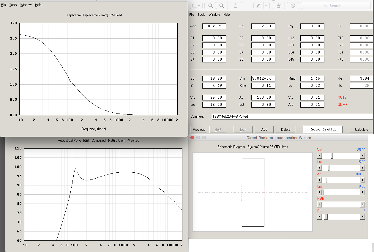

Your "Folded Horn Acoustic Guitar" can be modeled as a sixth order parallel band pass enclosure.
Although this alignment is a series of low frequency dips and peaks that average to around +6dB over a simple ported cabinet, above 1000Hz or so, the band pass attenuation drops level below the direct radiator.
Though the sixth order parallel band pass is considerably louder, sometimes the "sounds like ****" phrase says it all. 😎

Art - wow, you really did read it! Good catch, there is a digit missing, never saw that, what do you think of the speakers? Also the sounds like **** is something I am trying to avoid of course, don't want anybody to misinterpret this. Playing an acoustic guitar too hard is something that happens often, because other instruments drown it out, and sometimes people just want to rock, even though they are not playing an electric guitar, for whatever reason. This allows people to play with less force, and get more volume, much more room to set the tone where it is desired and stay clean.
I see dB is about 108 max, sounds about right. What do you think of the dB min/max over the frequency range, and any other comments are welcome. Thanks so much for modeling this! Joe
The TEBM46C20N-4B simulations are not at all exact to your design, but show the difference between using the drivers front loaded compared to the way you have employed them.
Looks like your sixth order parallel band pass may "sound like ****" 😉
That said, the acoustic guitar sound may fill in some of the holes, and you are making a sound producer, not reproducer, guitar players often like the sound of phase shifters...
