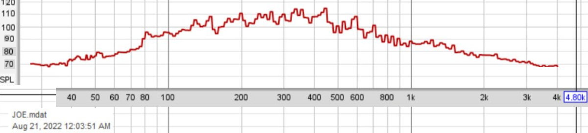

Attached are REW images. dB is 115 max, very powerful!
Let me know about FR, looks somewhat flat to me, and very similar to what I get with a nice Taylor standard acoustic guitar by itself, but louder.
So I am thinking, same FR but at a much higher dB level, good.
OK let me have it, am I missing something?
It is fun to learn REW, but I have a way to go, I know.
Also what about the sweeps? I am totally clueless regrading this. Thank you Art for being my mentor on this project!

"Somewhat flat" frequency response could be construed as +/- 6dB on axis response over a given bandwidth, say that of a guitar, from 80Hz to 16,000 Hz.
Some of your sweeps show response dropping from near 115dB at 450Hz to only 70dB at 4kHz, a 35dB drop.

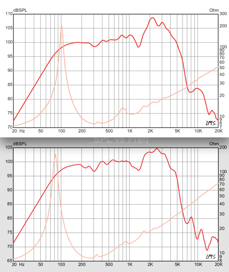

That is worse than I expected from the simulation in post #225.
That said, your notes don't mention any basic measurement protocol, such as signal voltage, mic distance to source, boundary conditions, so I have no clue as to what they are, or if they even are representative of the actual frequency response that would be heard in a normal situation.

Both my mentors, excellent! JJ yes I agree with the sealed chamber, just proved yesterday what a disaster an unsealed chamber is on the other side. The chamber divider side had a port added to experiment, I also have a divider that is sealed, no problem, will test that.
I admit I rushed through REW last night, it was getting late. The good news is I like the software upgrade, and I am finally enjoying using it again, was fun.
I have tutorials Art supplied, and found many online, I really just need to print them out and read everything, get a better understanding of the software, and how to use it, then have fun actually using it and testing. I will get better with REW, that must happen, as the focus now is electronics in the guitar.
Also note that my FR is very similar to an acoustic guitar all by itself. When I measure a quality acoustic guitar, the dB levels are not even close to +/- 6 dB, maybe this is the nature of an acoustic guitar that is being strummed by itself (need to try the short horn). This is not a stereo or a full band, just a guitar,
As we discussed before, this is not just a reproducer, but a producer and reproducer together, so a bit unusual. Plus I wonder how the FR is affected by the strumming or finger picking. For instance sometimes I am doing two down stroke, then one upstroke, then one down stroke repeated over and over with different chords, offbeat rhythm. Obviously plenty of resonance, but attacking the strings at different times. There are not five other instruments playing, so this has to have some affect of FR and dB at given times. Yes? Thanks guys! Joe

Joe,Also note that my FR is very similar to an acoustic guitar all by itself. When I measure a quality acoustic guitar, the dB levels are not even close to +/- 6 dB... Plus I wonder how the FR is affected by the strumming or finger picking.
A frequency response measurement compares an input signal to an output signal- an instrument does not have a frequency "response", it has a spectrum, or timbre.
The range of frequencies and levels which constitute an instrument's spectrum, or timbre can be displayed on a real time analyzer.
The sound spectrum of any instrument is affected as much by playing style as it's physical construction attributes.
To accurately reproduce the sound an instrument, the system must be reasonably "flat", yours is not, and may require around +/- 22 dB of equalization to even approximate an acoustic guitar's spectral response.
Art
You can find out. REW has a peak level reading in its plot. You can turn off the regular spectrum plot and show only the peak. Just take your mic and - as if recording the guitar - play it with REW doing a peak spectral analysis. Be careful not to bump the mic stand, clap or make any other sound besides the guitar (especially transient sounds).I wonder how the FR is affected by the strumming or finger picking.
Of course you'll have to fool with the REW spectrum settings, but it will give you an across the whole song frequency spectrum, showing all the frequencies made by the guitar. Try it once strumming, a second time (after reset of the spectrum, as it's cumulative) finger picking.
This information can in turn be used to design the reproducer; at least determine the most important frequencies. I mean if 16k shows up, but it's 40 db down in level from most of the other louder frequencies, probably dont have to worry about reproducing that one so much.
And when 4kHz is more than 40dB down from 440Hz (like in the measurement of the reproducer in #265) it's time to add a tweeter to the woofer .This information can in turn be used to design the reproducer; at least determine the most important frequencies. I mean if 16k shows up, but it's 40 db down in level from most of the other louder frequencies, probably dont have to worry about reproducing that one so much.

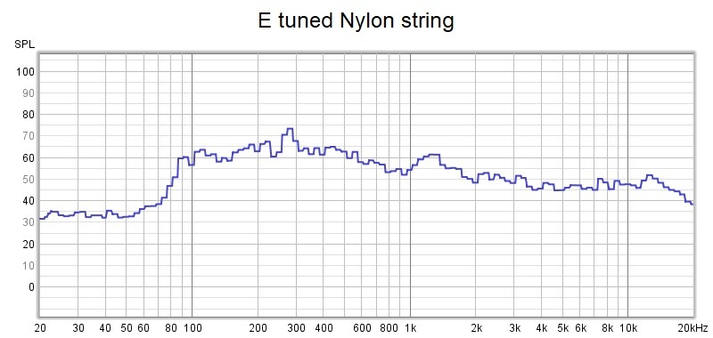

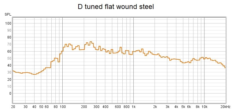

So I tried it with two guitars, one a nylon string the other a steel string with flat wounds. The Nylon is tuned to E, the Steel is tuned to D.
REW can analyze a recorded file, so I recorded me <ahem> playing the same tune on two different guitars. I recorded with my Tascam DR-05 on a camera stand at 32" height, about 2' in front of me sitting in a chair. SPL is relative. Here's the resulting spectrums -
(The RTA analyzer is set to 1/12th octave and 1/12 smoothing. When you open a file (.wav) with the RTA, it asks which channel and if you want to do a "peak" analysis. I selected left and peak, then watched it crank through the sound file. When I selected "both" at first, I just got two essentially identical analysis)
Not much sub-80 on that D tuned instrument - even though it's body is almost twice as deep as the Nylon guitar. Anyway - FWIW; you can quantize differences in instrument sounds: just dont get too attached to the result! Glad it's not possible to unravel this data and hear me play

Yes, thank you gents, response vs. spectrum that helps Art, more what I was looking for. I think of flat when considering a stereo, +/- 1 db flat to reproduce the existing sound would be great, especially when listening to Pink Floyd. There are other bands that I don't care how close the reproduction is, I don't want to listen at all, because the original music is terrible. Getting it right at the instrument is critical. I have heard my guitar sound not so great in the earlier days, when my electronics were "questionable", but today I am getting a sound that I only hoped I could get with this instrument. I need to get better with REW and get some better measurements, I know it is there. I may not have a good voice, but I do have a good ear.
The attached file is a violin, I see +/- 15dB all over the internet for guitars and violins. I think I can get better with improvements, but why can't this type of curve be reproduced with all the different dB levels at different Hz? I am talking about a guitar by itself, or with voice, or another guitar. In a band I understand that would be different. Also a regular acoustic guitar is giving me the same type of curve, just 20 dB less SPL, like JJ, so it is not my unique guitar per say, it must be my measurement methods. If I measured a standard acoustic guitar with the same setup, and it looked totally different, that would make me wonder.
JJ you are getting about +/- 10 dB from 80 Hz to 1000 Hz, that is almost exactly what I am getting for my best measurement, plus mine was 20 dB louder or more across the board. Yes Art is correct I was also getting +/- about 20 dB in that range also with different setup, I need to figure out what is going on there.
Plus playing at 20 dB louder on an acoustic guitar is a whole different experience, it will be even better when it is in the guitar! You can play with such ease and get a big sound, really changes everything. It is a little hard now, because the body is close to me, but not in my hands, so still amp like for now.
