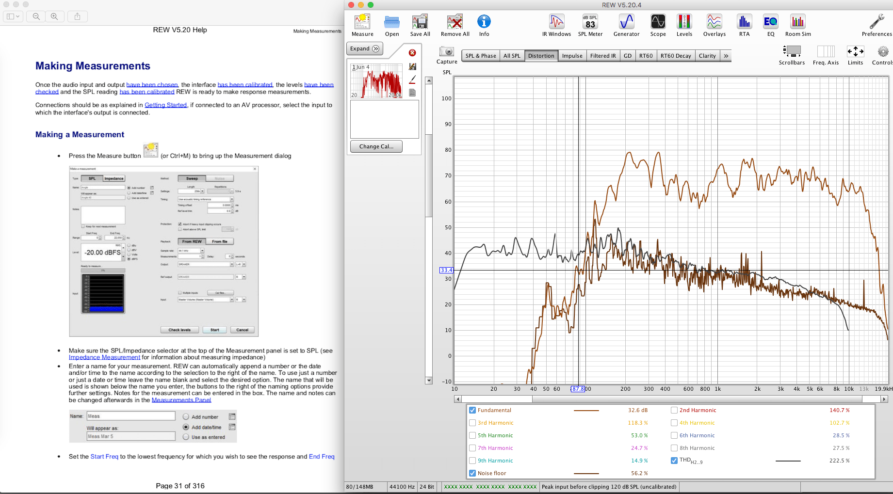

Hello Art, JJ and all - REW software is great, I gave him a 100 bucks and he appreciated that. I was like are you kidding,
you give this software to people for free, great guy. Attached is first look, much to learn with this software, but a good start.

First page is a Taylor Guitar, second page is mine...more to follow. 20 dB easy, frequency response...need better testing.
I'll go out on a limb here, to try and quickly describe one thing you can do with REW to help analyze what you have. I'll assume you have some kind of USB sound output and recording interface.
Let's try some pink noise. Open the Generator, go to the Noise tab and then the Pink random tab. Select Full range, just under the Pink random tab. Press the "Play" button in the lower right corner. Plugging in a set of headphones into your USB audio output, you should hear a sort of waterfall sound. Now arrange cabling from that audio output to the input of your guitar's amplifier, so that the same sound comes out your guitar's speaker horns.
Now, using the same RTA "spectrum analysis" you showed above with the mic, you'll need to change the RTA mode from "spectrum" to "RTA 1/24th octave". This is done by clicking on the "gear" symbol, just below the "X" used to close the window.
Theoretically, if your amplifier is flat and your speaker is flat and your microphone is flat, you'll get a flat response. We can assume the mic is flat, but dont know about the amp. For now, just set any tone controls to flat position and we'll assume its flat in FR until getting around to actually measure it electrically.
Get your guitar's horns making some sound by cranking up the volume moderately and measure that with the mic, setup say a meter away. The FR of your horn speaker setup should be revealed. You can do it more accurately using a FR sweep, but for now this is the easy way to get a first look at what the speaker system is doing.

JJ - I recorded data per your suggestion, thank you! It looks pretty flat to me, but please tell me your thoughts.

Looks like background and 60Hz line noise, not speaker response.JJ - I recorded data per your suggestion, thank you! It looks pretty flat to me, but please tell me your thoughts.
