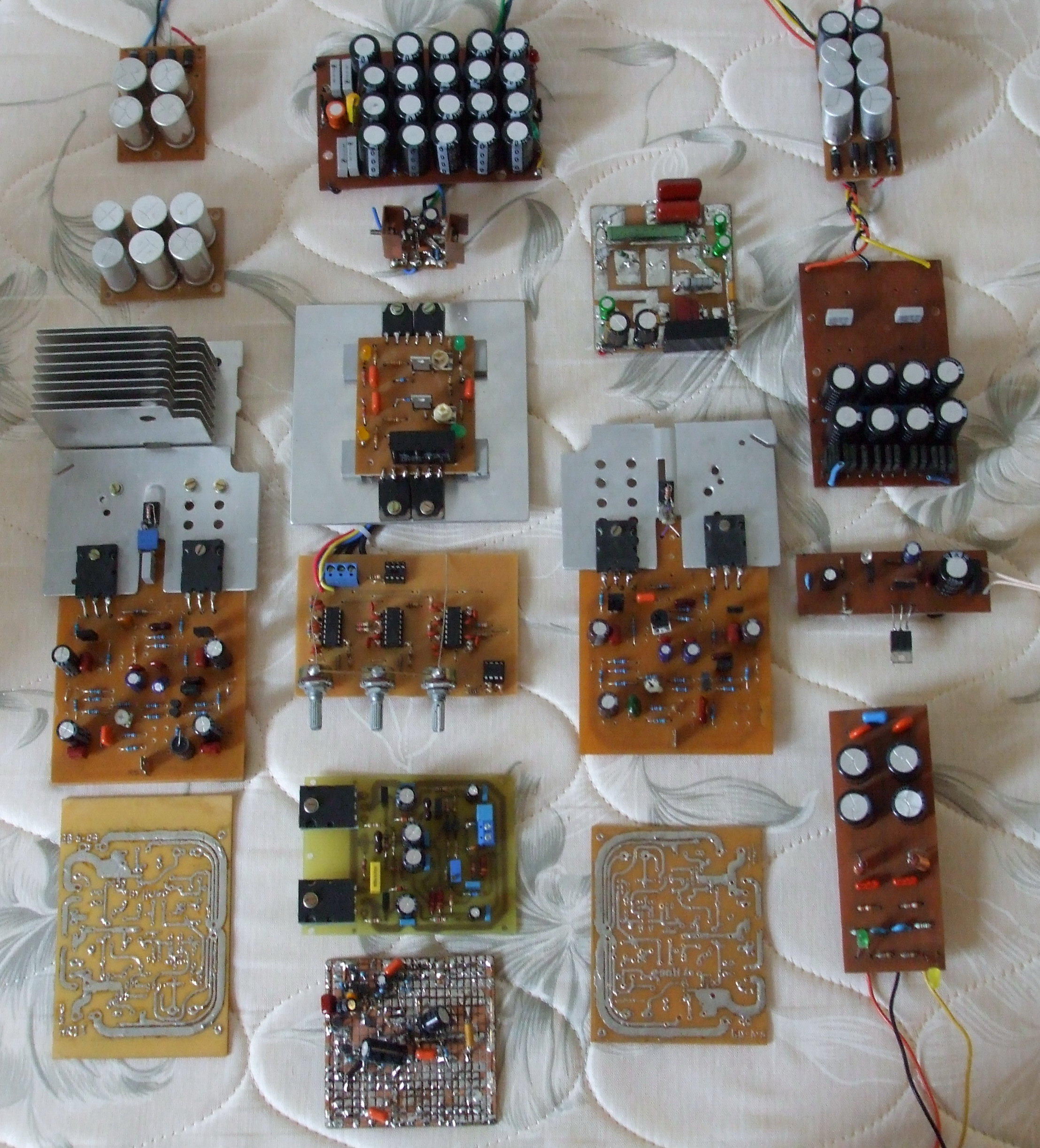

Yes, what this thread is about
But I believe its exactly the right time to coinsider the final physical layout
Next time it will be too late 😉
Sorry, i cannot do that, because i may decide to remove some CCS
circuits, introduce new parts and new subcircuits...so... the layout prepared will be lost.

The ones that wants to assemble, will have a very good amplifier
But not an awsome amplifier....better to wait to final version.
I am using CCS to the drivers (Electrocompaniet idea)....and 28 miliamperes to each driver...this means we gonna need 3 watt heatsink to each one of these CCS pass transistors.
3 watt heatsink can be made using 2 milimeters (or more, or less) thick aluminium blade, cutted in rectangle or square, then bend the way you want, produce a hole to screw and better to insulate from the heatsink... 3 centimeters side if squared may be good...but because insulator, better to make it rectangle and bend.... 3 by 4 centimeters rectangle will be better...i have these transistors installed in the main heatsink..but this will be a problem to the board layout near future..so...better solution is to let them stand over the board having it's own heatsink not to complicate the pcboard layout.
Other CCS dissipates less power..but i think they should have small blades of aluminium too, to operate warm.
The image shows these in details.
VAS must be insulated from the heatsink, a 3 watt heatsink... parasitic capacitances may bother.... heatsink having full voltage swing can be a problem..do not forget to insulate... output coil and this transistor heatsink can interact.

Distortion dropped to 0.004%.... was a nice drop...i was having around 0.019%....phase is better.... waveform at 100 kilohertz reasonable.... speed (slew rate) seems good .... AC analisis flat to 4 Hertz... fourier with the harmonic distribution i like.
This is how it is today..... a big step forward done yesterday nigth.... now this is the second better amplifier i have built.
The voltage regulators you see in the left side..the input side, in the reality are special for me...because my supply has too much voltage drop...you may not need this...the place to this regulator to be is in the power supply board.
Do not assemble please..it is just a prototype.... i need time to check, to test more..to be sure about some details...this really needs 100 hours of observation of measurements, scope and listening.
The huge complication, in my point of view, usually does not sound fine...and i am in a struggle to increase sonics tweaking.... very small changes in part values and them the distortion increases.... really this kind of circuit needs tuning and will be hard to produce several units with the same characteristics or same performance because some capacitor and resistance and transistor choices are critical to reduce distortion.... a matter of fact, to me no doubts about...i knew that 20 years ago...the most complicated does not sound better than the simple ones..the over complicated "chups" (cannot use the real expression).... hard to make it so good as the generic Blameless, or my beloved super quality audio amplifier, the Dx Blame ST... at least, this monster gives you huge power...ballanced sound and also... the "psychological" satisfaction, as having voltage regulators, a lot of CCS, current sink, mirrors... a lot of parts (pure snake oil) will make the ones belief in such kind of stuff, feeling safe, as the circuit has some more modern features that should make it better than others... despite i do not think so.... i think people that has such kind of beliefs will feel good..will be sure has a better machine.
