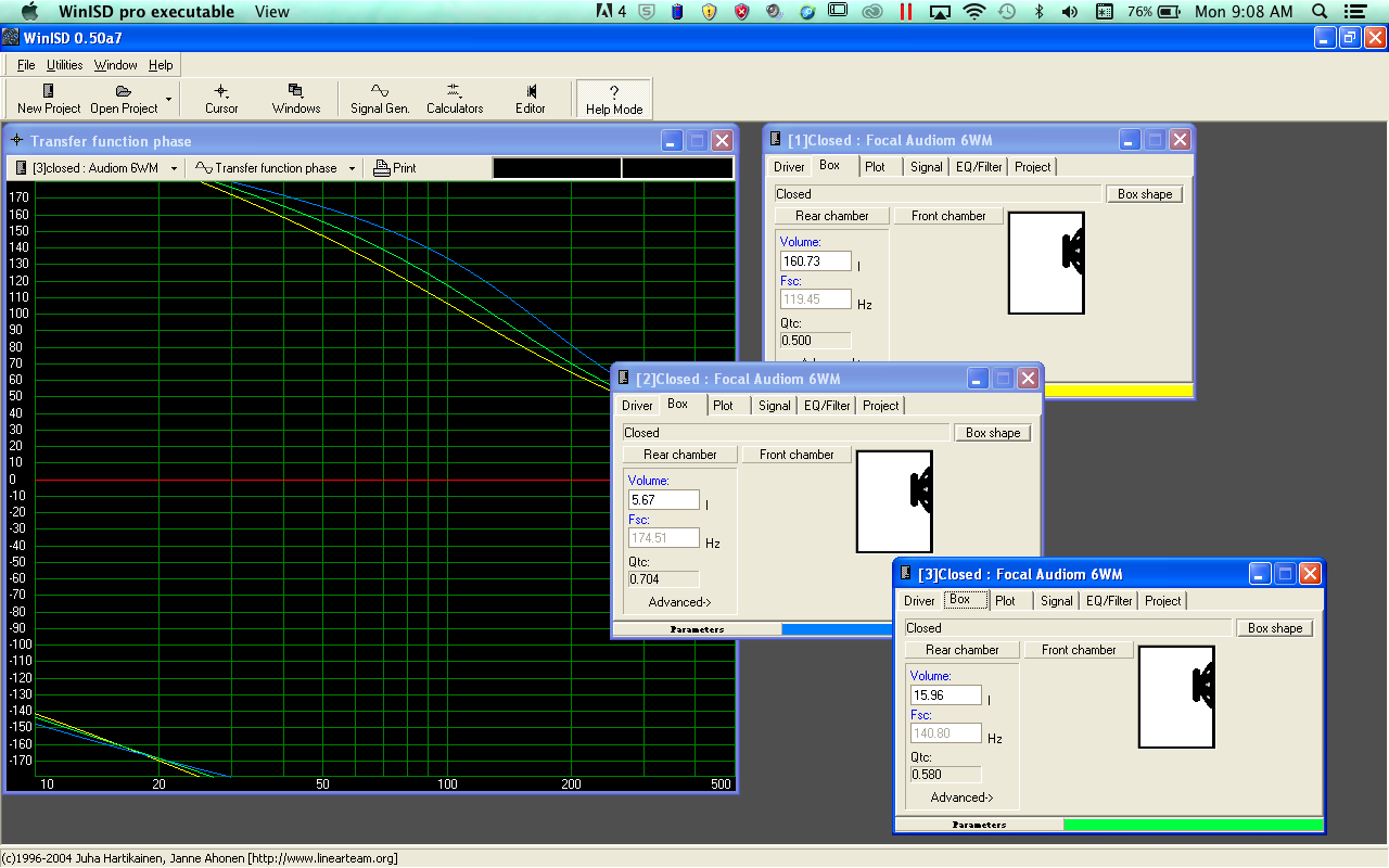

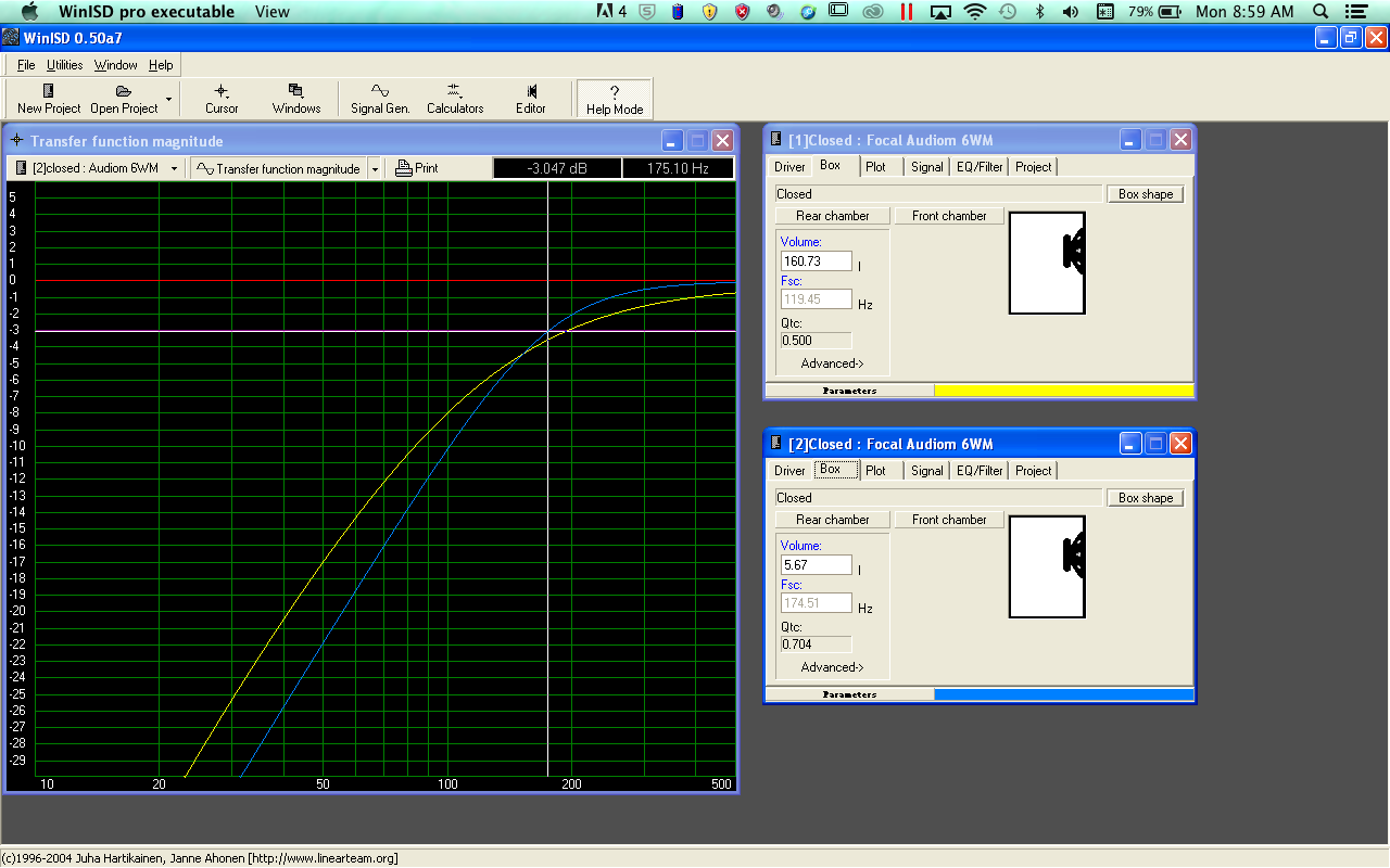

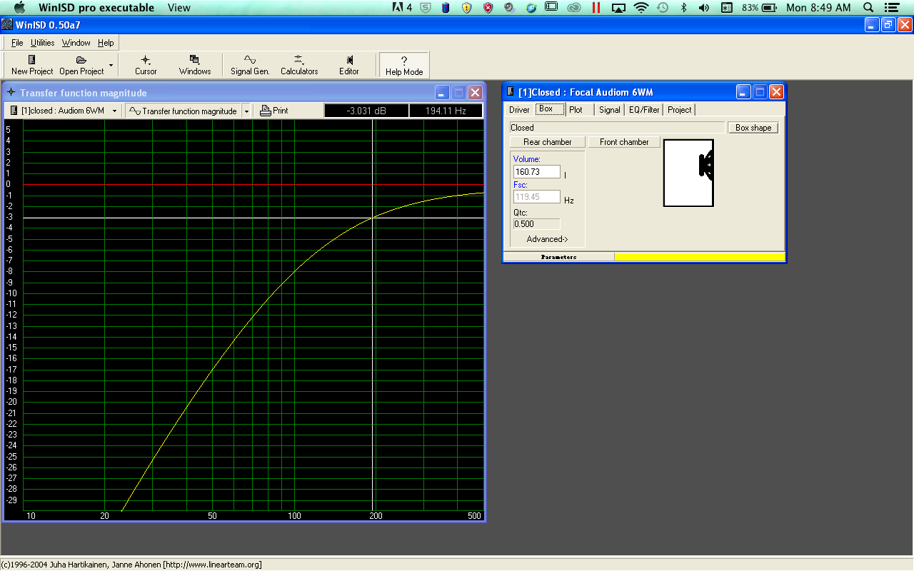

so for the midrange driver focal audio 6wm I am looking at the possibilities.
Here is critically damped . Has anyone tried this? What did you find vs a larger cabinet? Any input appreciated.

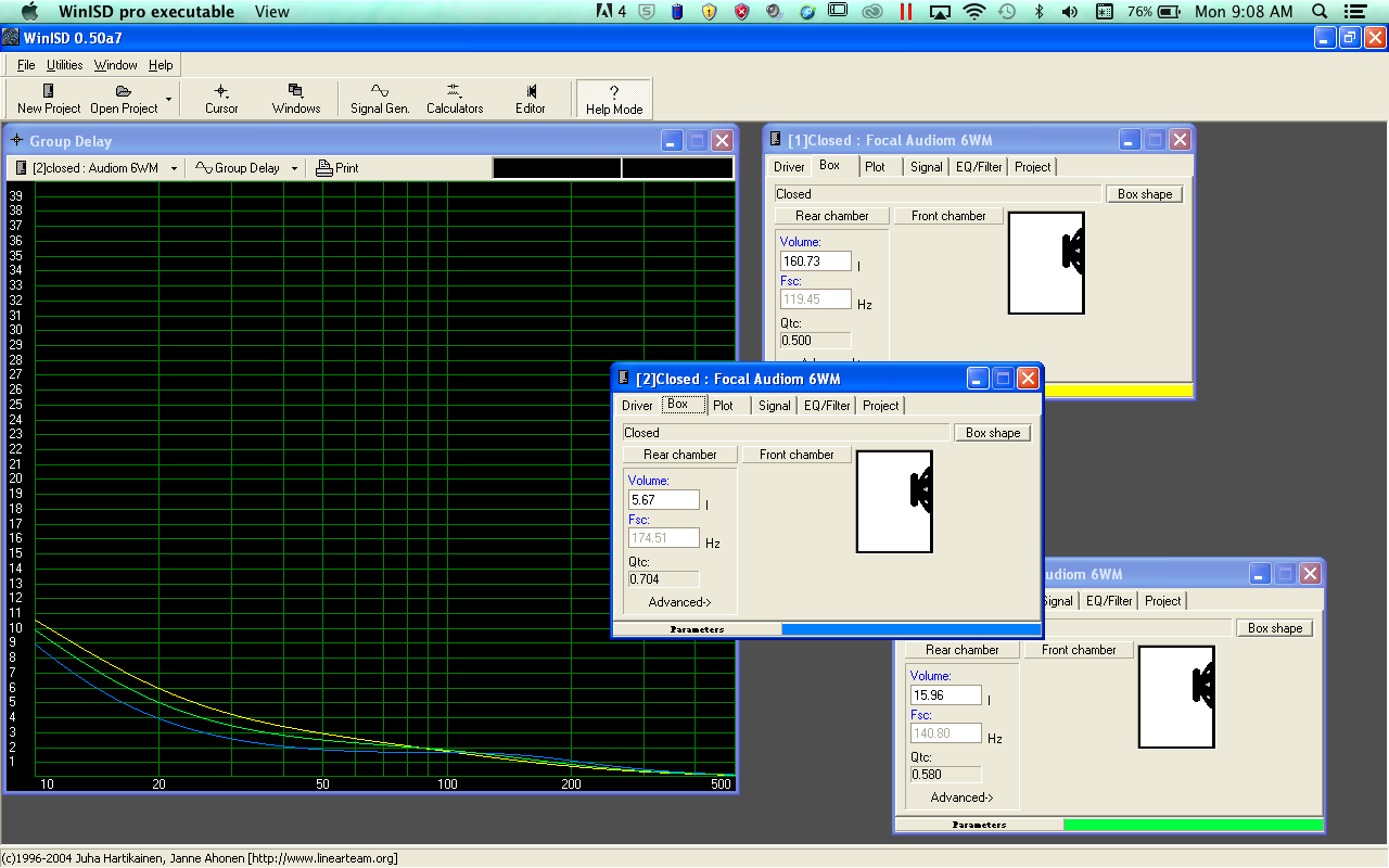

and max flat delay response q 0.577

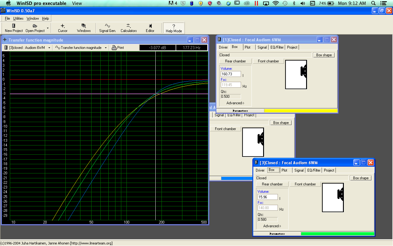

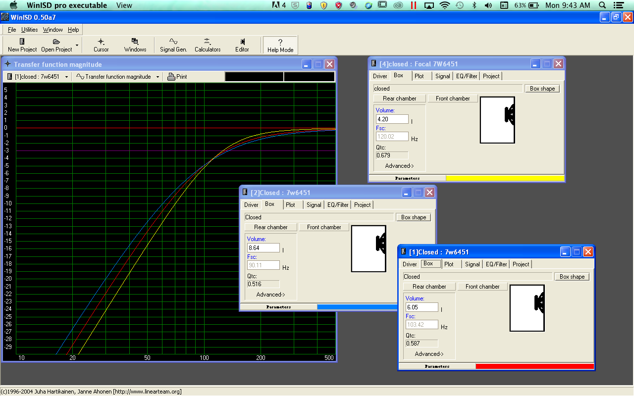

similarly comparing the options for the focal 7w6411
The recommendation I received from the seller of this drive is in yellow.
Critically damped in blue.
Max flat delay response option is in red.

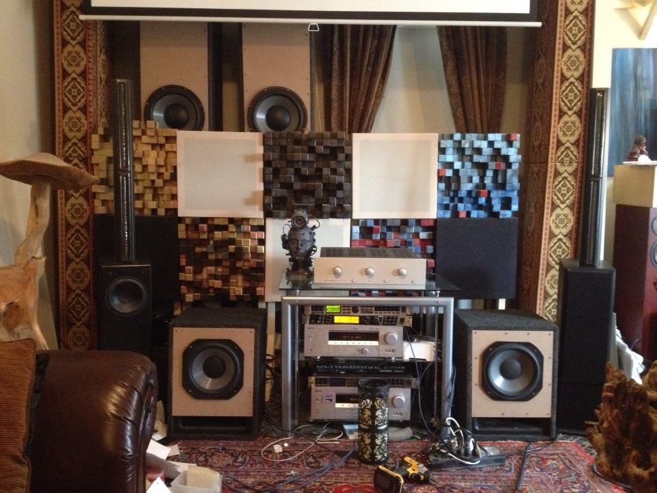

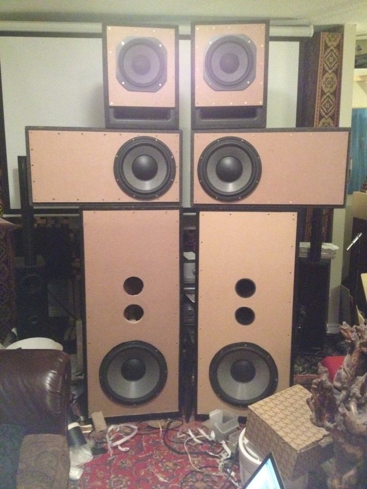

Done the woofers section. Must say it sounds fantastic and I haven't really done much in the way of measuring or adjusting the x overs, or running room eq yet.
I have hidden much of the bass cabinets behind my diffusers I made.

I have never heard that midrange but have seen it online. Always wondered how it compared to the W series stuff.
Does that crown amp have a fan in it? How do you find it in terms of noise? Does it distract you ? I am considering one for my project but I will be watching movies.
