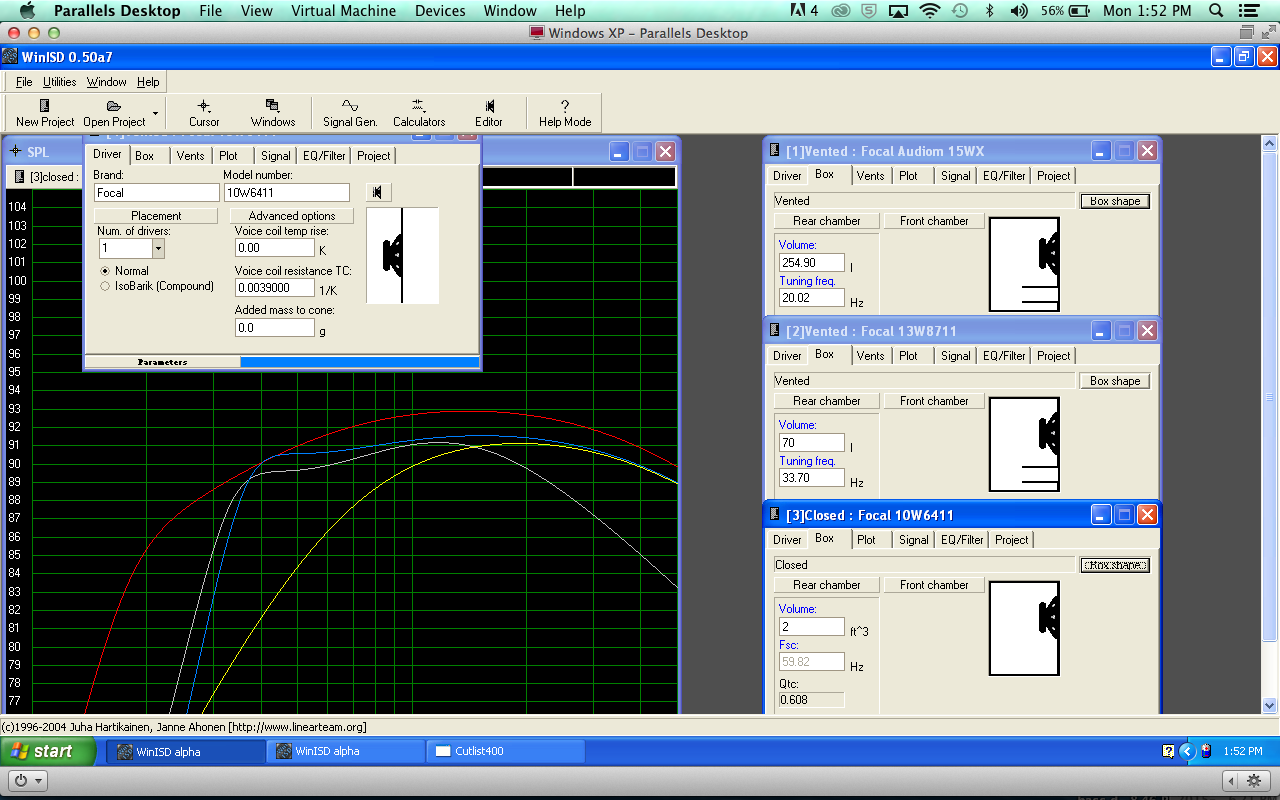

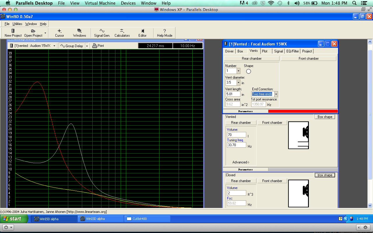

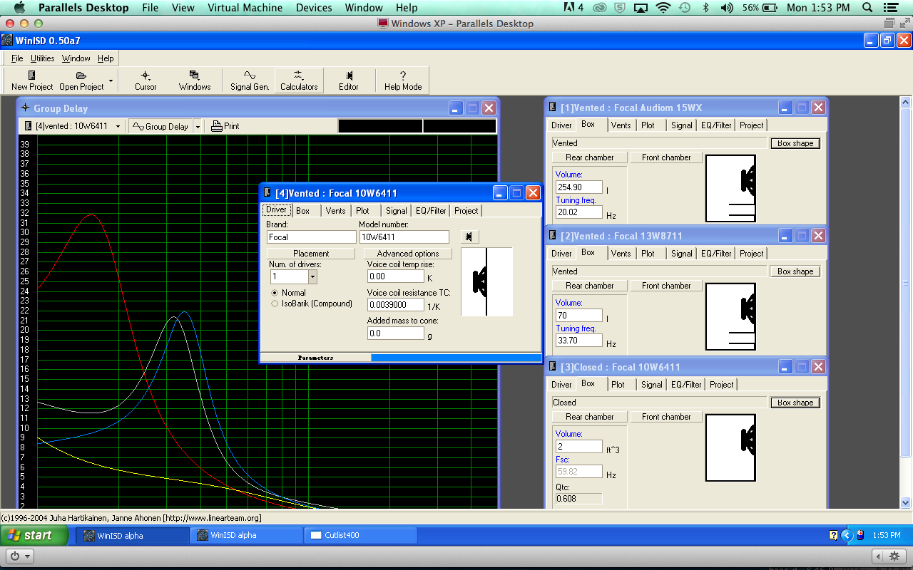

Here are spl and group delay for the proposed options.
The red line is the 15wx obviously
the white line is the 70l 33.7hz tuned 13w
the yellow line is the Sealed 10w
the blue line is the vented 10w

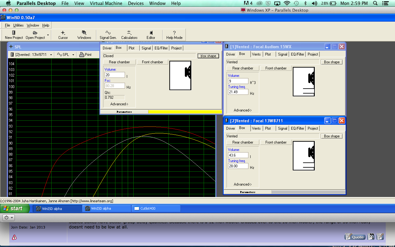

Here is my design with low pass filters on the 15, and 13 woofers.
The rolloff on the 10 inch is almost enough to let it play unfiltered, however this is a questionable power use.
I will model it with the 10 inch in a vented cabinet, but what I am thinking is that even though the difference in group delay is negligable from the sealed cabinet to the vented cabinet, I still feel that a sealed cabinet will sound better for this woofer working in this range for this design.

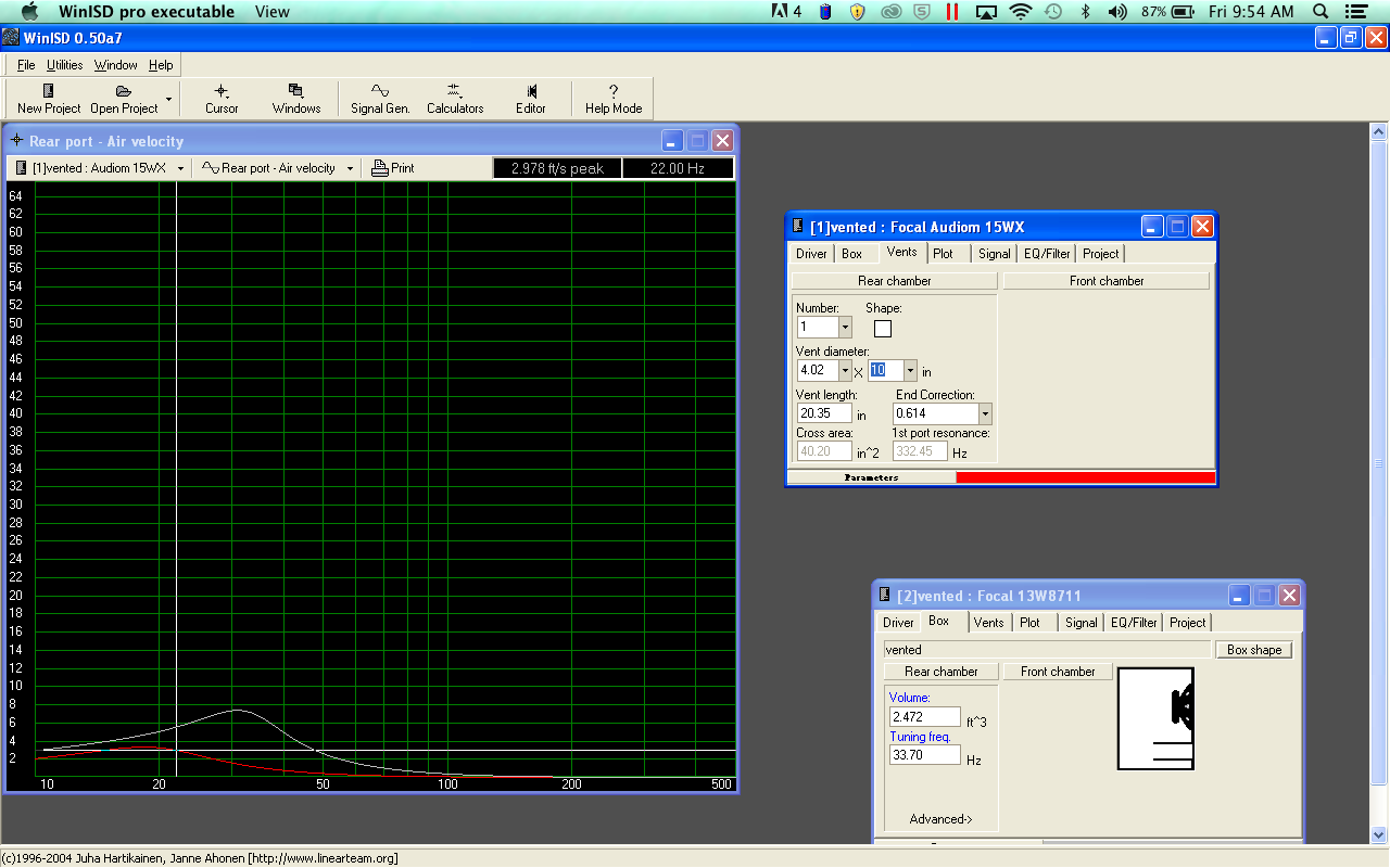

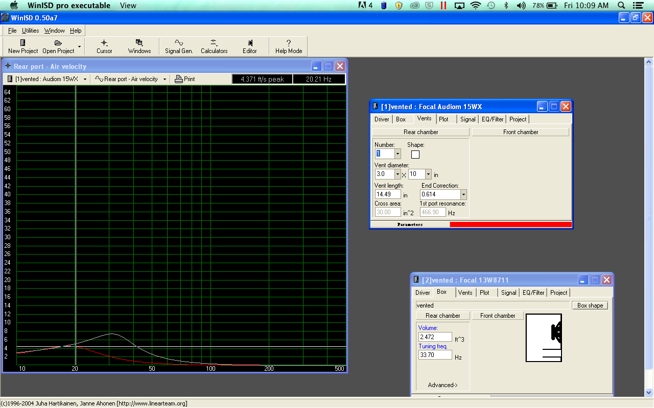

Maybe you can help me with this.
I did two 4 inch inner diameter bass ports tuned to 22 hz, and I still have considerable chuffing noise from the port.
Win ISD gives me a port velocity of around 6 ft/sec.
The cabinet is only 18 inches deep and theres lots of stuffing so really can't get longer than 13 inches.
If I build a square port I can get it down to 4.5 ft/sec port velocity.
The only other route is to cut a hole in the top and put the port along the length of the speaker. .....
Do most subs have some chuffing? Should I just let this one go or what?
+ klhsx@ post #34,
please give:
1. net (internal) volume for the reflex enclosure you have or plan.
2. reference for the driver you ask the question
3. power you will be about to use (+/-) after you build your project. (note. some members use RMS power for the driver others use 10W-50W and others use 1 or 5 with a Triode, just that you know.)
4. but not least port tuning and chuffing noise. You can tell us if a little chuffing noise in your room is ok or not. sometimes the ports are facing a back all or you will be using low to medium power not max or RMS. Larger the ports considerable longer they will be.
please give:
1. 9.1 ft^3
2.focal audiom 15wx
3. Max power of the driver
4. Little chuffing at 25hz, almost double at 31.5 hz
This was tested with one woofer playing, in the final setup it will be two woofers playing. so I may not get it loud enough to reach the chuffing.
I am tired of cutting new faceplates ! lol
2.focal audiom 15wx
