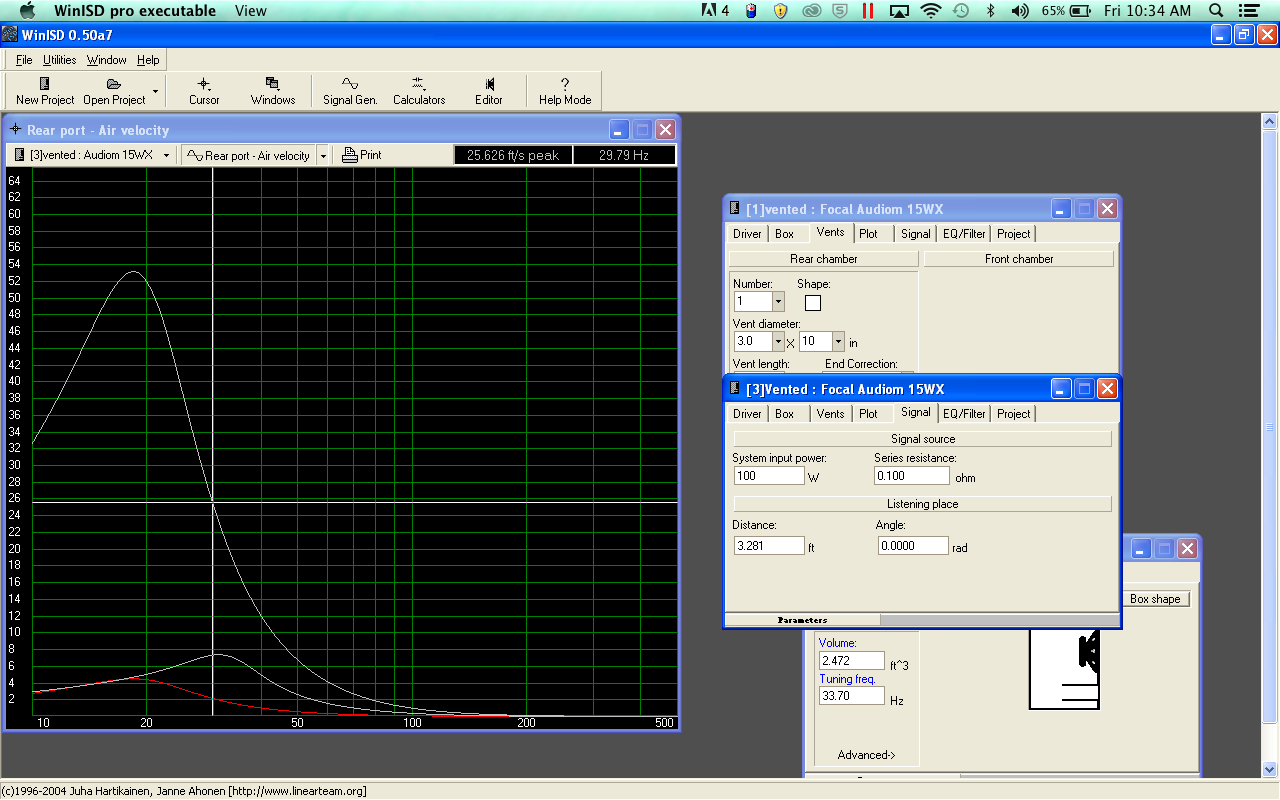

OK I figured it out.
Have to change input power in the signal tab.

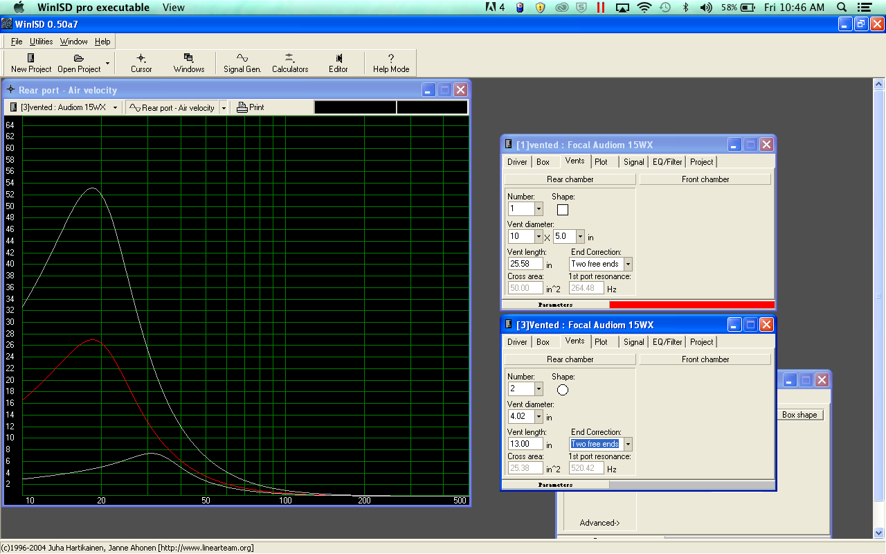

Well it seems the only way to get a worth while reduction is to make a port that is square and longer than my box depth will allow. This means meaning new face plate, and cutting a hole in the top, and building a square vent that is much longer.
ALSO I guess I have to recalculate the box volume and subtract the larger volume of the port because Win ISD does not account for this when I make the port size change ?
Thanks for you help so far guys.
Also, without having an exact box volume I have been cutting a few slightly different length bass ports from PVC and testing the results to fine tune.
If I go with a square port cut from MDF that would not be practical anymore. I would have to choose one tuning build it and live with it.
Considering this driver is going to be dedicated to the bottom range of 20 to 35/40 hz, I don't think I can let it go and leave this chuffing so high.
Especially because I will be equalizing and boosting the bottom end, and this will only make the chuffing worse.
I guess I will have to build the big ports and put them down through the top.
Yes I was considering just taking the damping out, but even so the cabinets are only 18 inches deep, minus a few inches for front and back baffle. So really 16 inches, and then at least an inch of play/air space..
Gives me 15 inches max depth for a bass port. Thats not really enough to make any port that will make a worth while difference from the 13 inches I just cut, even if I go square larger opening single port.
The only dimension that looks worth while is top down because the cabs are almost 4 feet tall.

FOCAL AUDIOM 15WX, VB = 250.0 L, FB = 20.0 Hz
would require 2 ports minimum 4" diam (for ~P.200W) and length 39.13cm = 15" 13⁄32in. consider distance between cent./ports 20cm/8". Consider at the end 3-4" free from the port/tube to the back baffle.
Surface Sd of the 2x Ports: 162.15 cm2
F-3 dB (in room/simulation): 21 Hz
