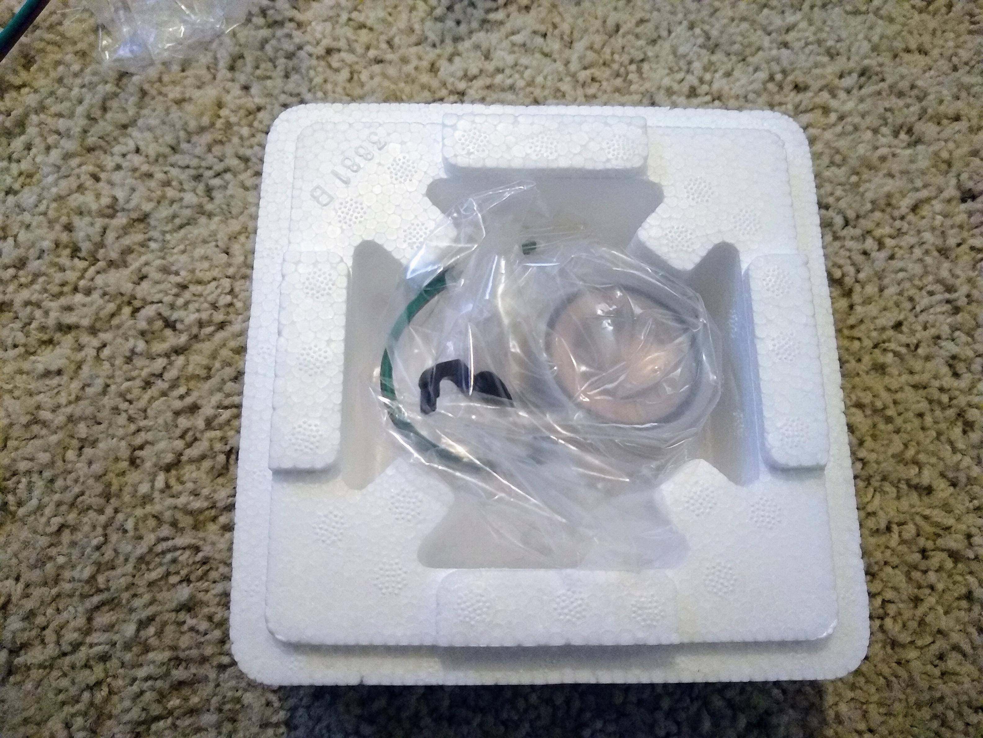

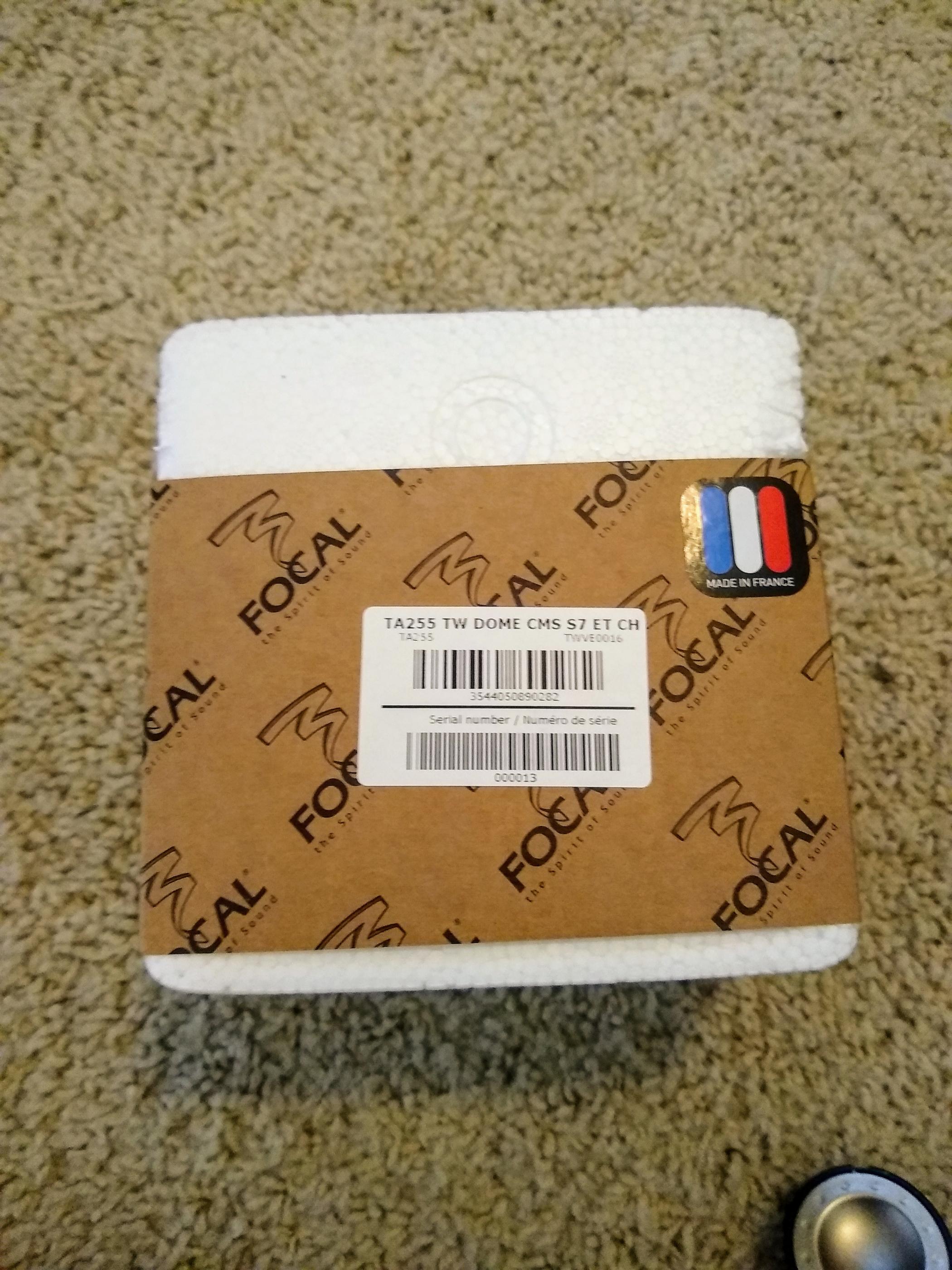

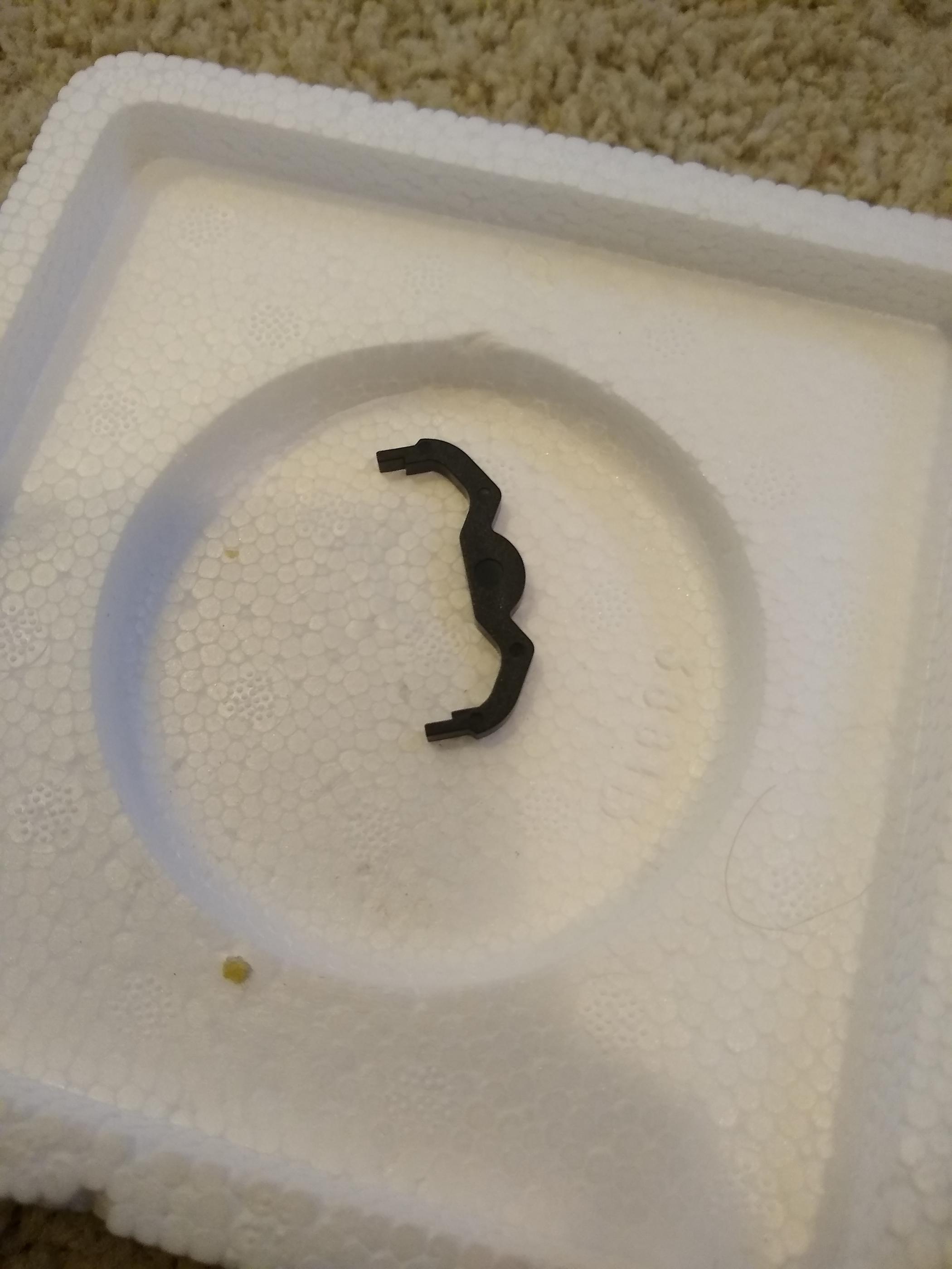

Got home and installed the new tweeters. I post the pictures shortly. It came with the key and it was super easy 😁
- Focal 826 Tweeter Removal
