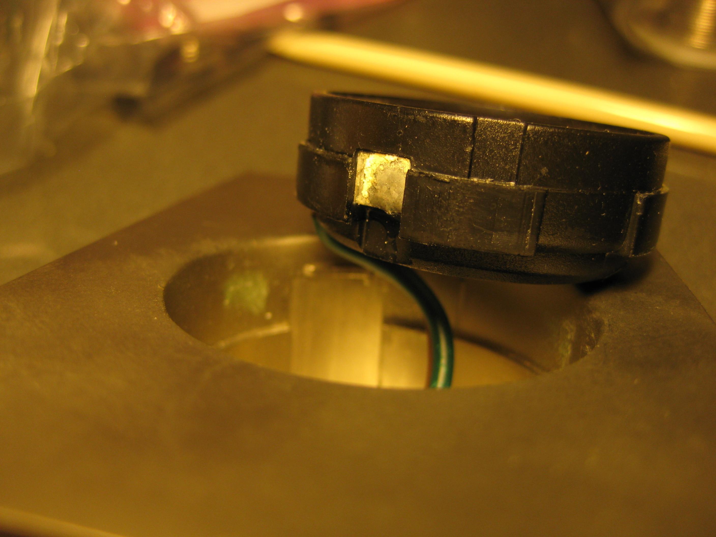

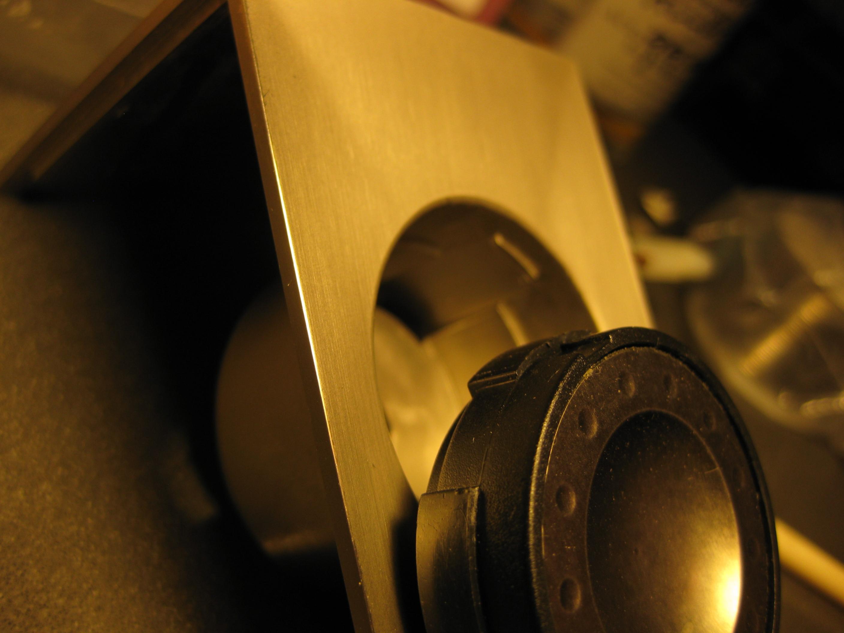

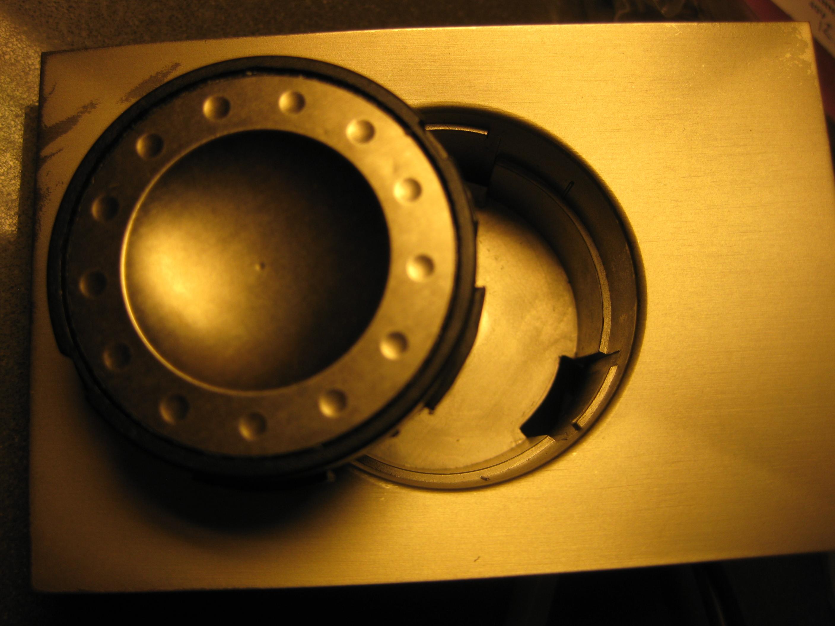

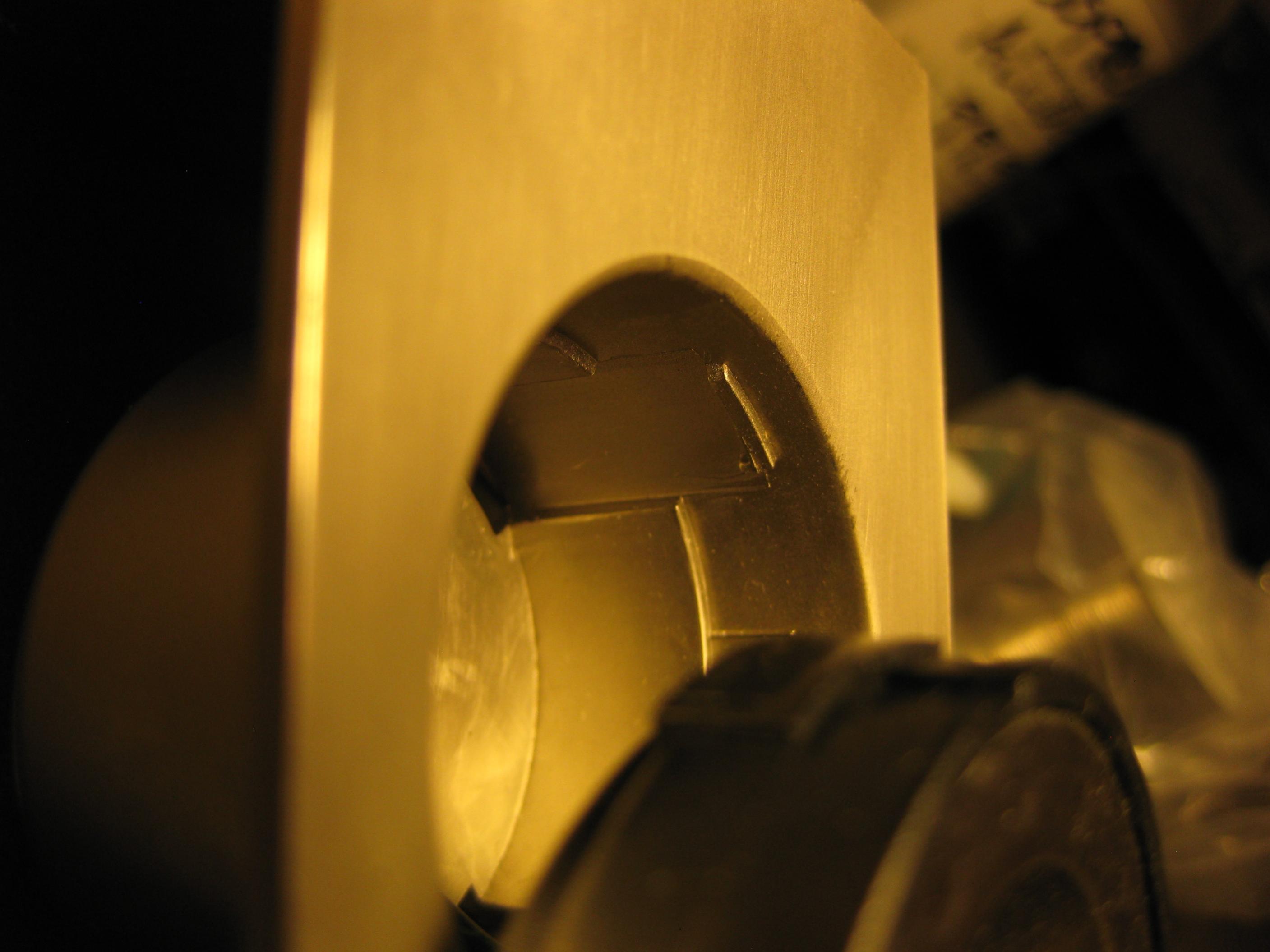

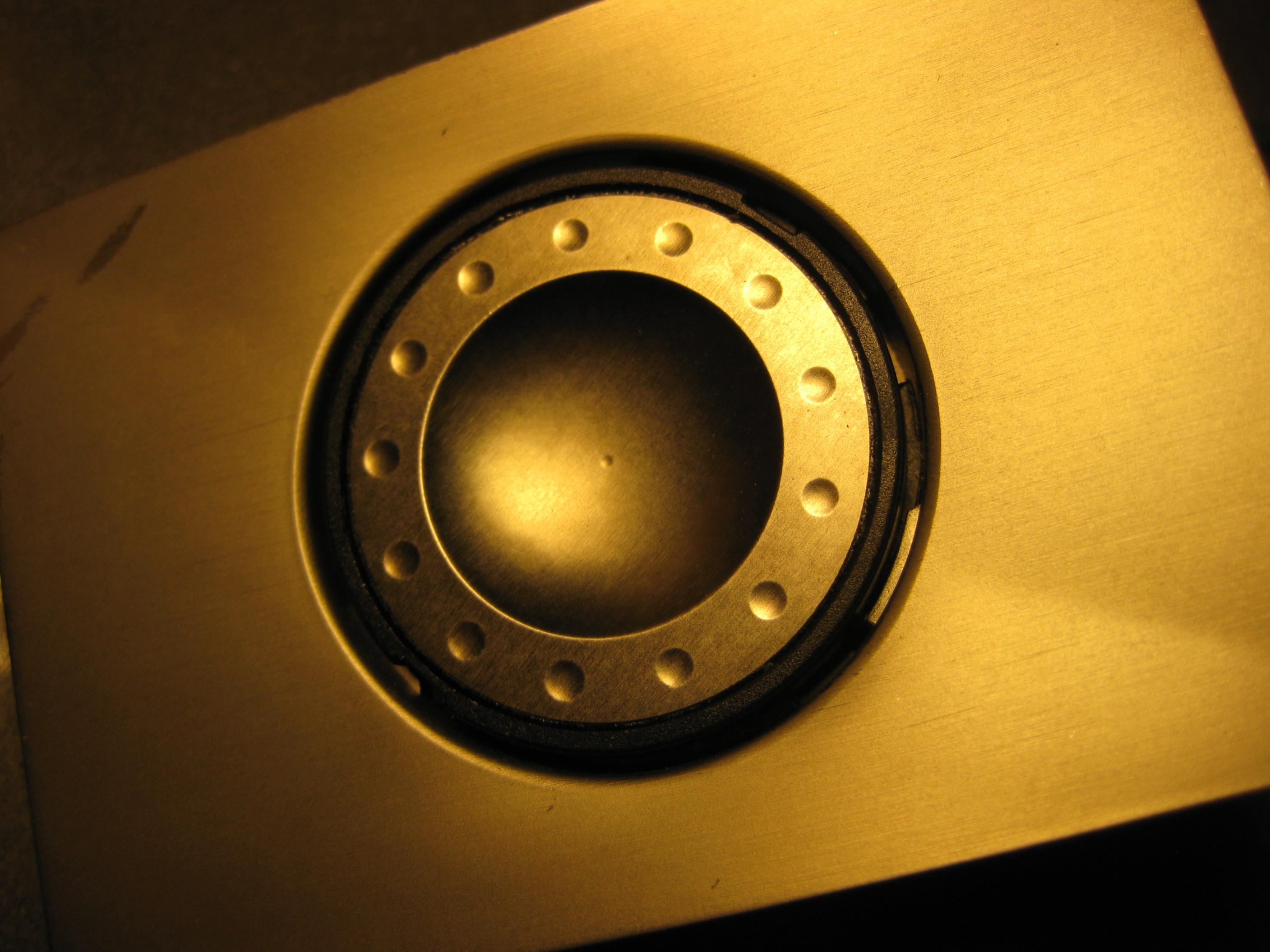

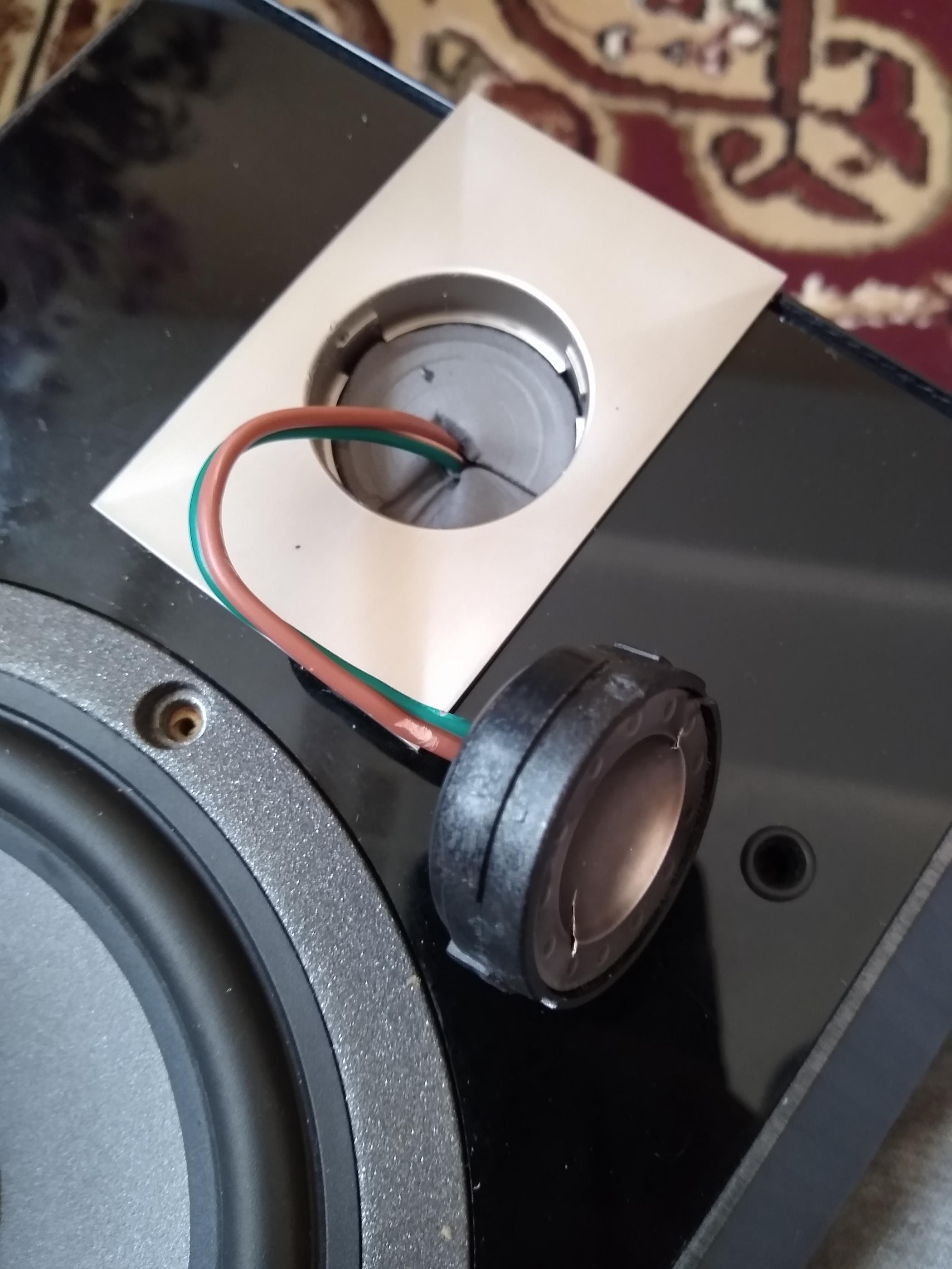

The metal surround that holds the tweeter is glued in. It is not necessary to remove that part to remove the tweeter. If you ever did want to remove it you use a heat gun to soften the glue and apply pressure from the back. You will feel it start to move when you get it hot enough.

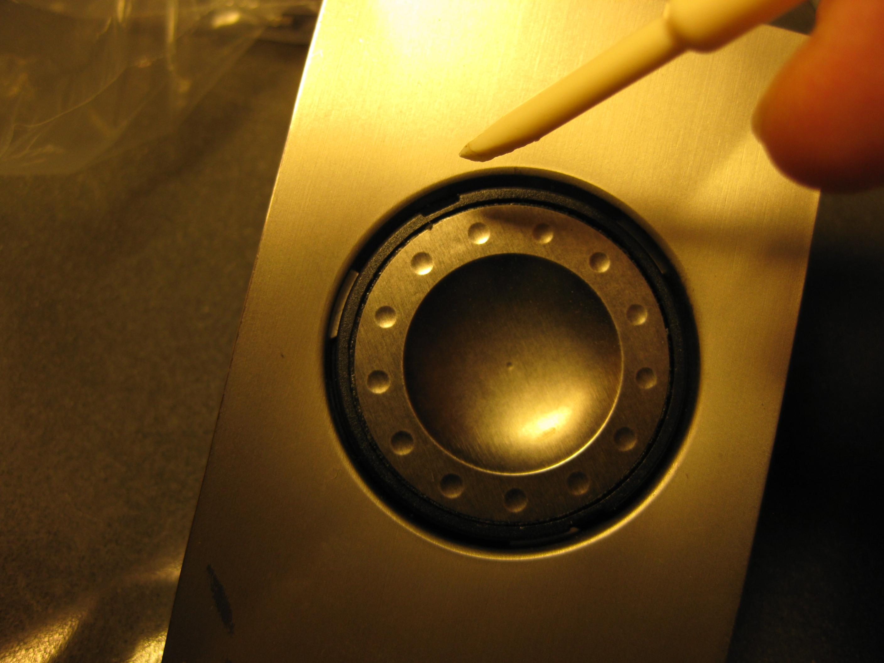

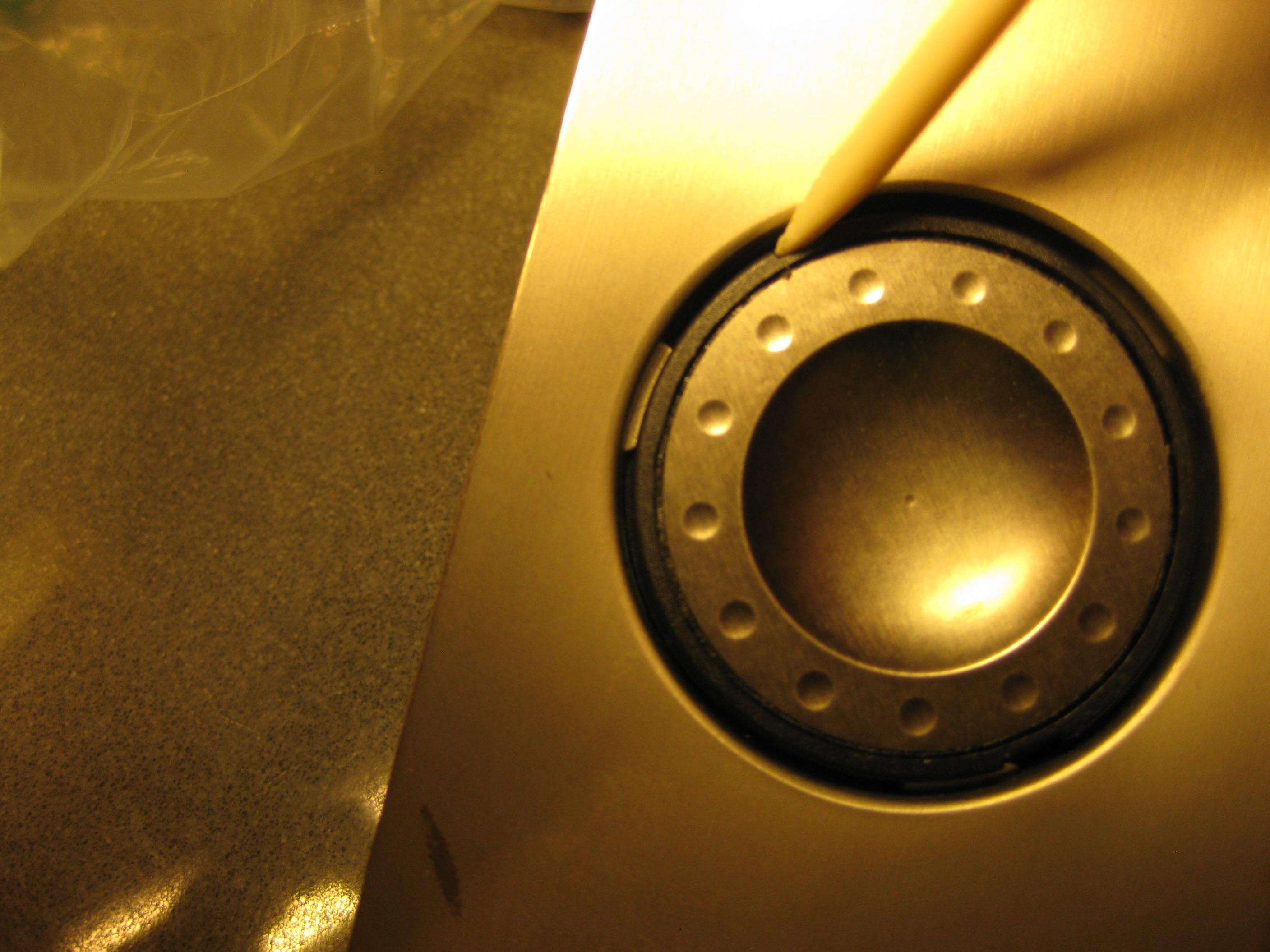

The tweeter is held in with tabs that are molded as part of the metal portion. To remove the tweeter look for the recessed "slots" on the plastic surrounding the metal tweeter diaphragm. DO NOT TOUCH THE METAL diaphragm- it will be damaged. Engage these "slots" with two flat small screw drivers or something similar ( this is what is shown in post #23). Now ,carefully, rotate the whole tweeter COUNTER CLOCKWISE. You should feel it disengage.

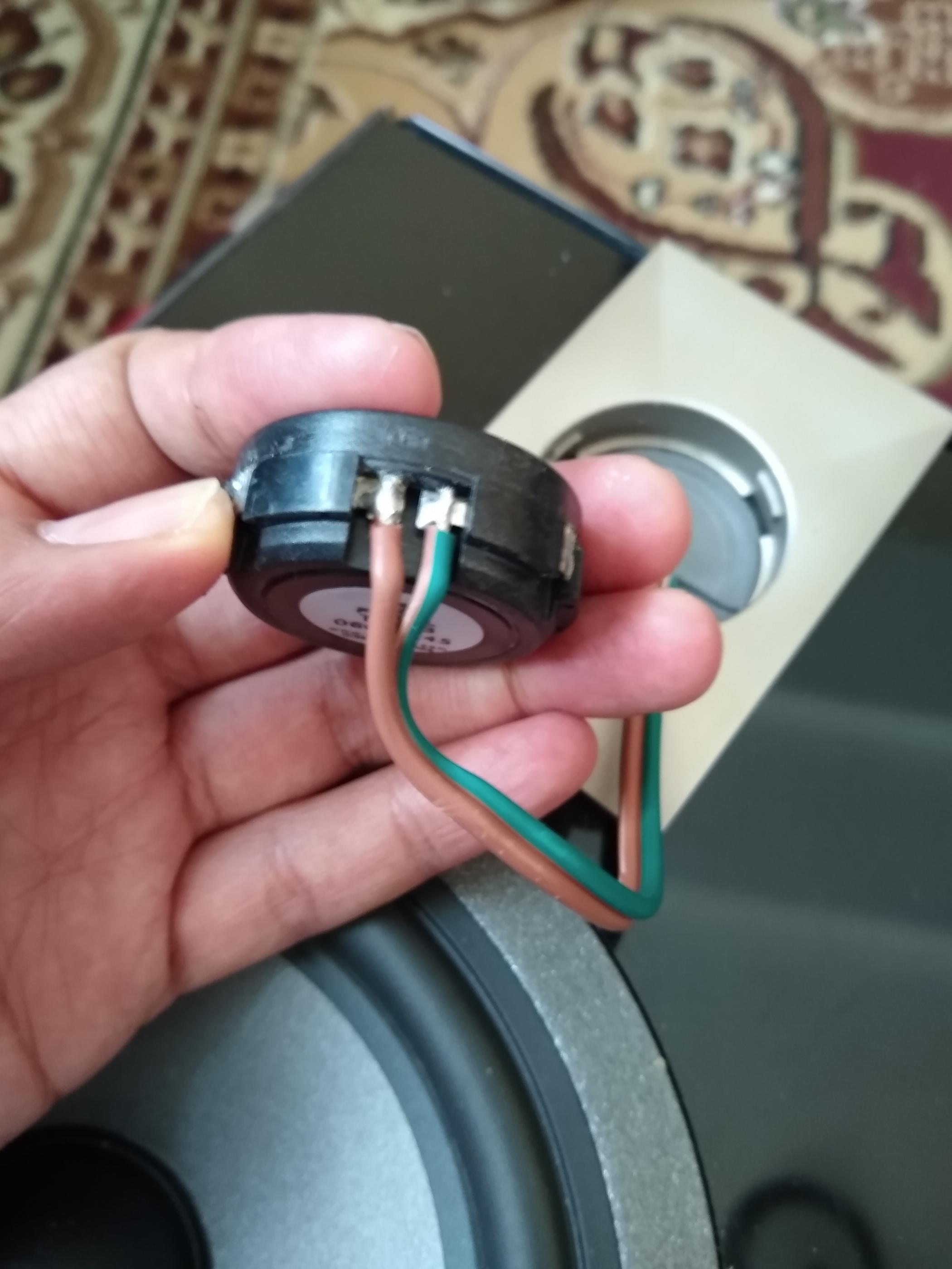

yes I bought them used. I was told by the owner that one speaker has tweeter not working and other speaker works fine. But I came home and checked them. Both speaker has blown tweeter 🙁
View attachment 811976I have what might be the same tweeter. At least it looks the same and is off a Chorus V.

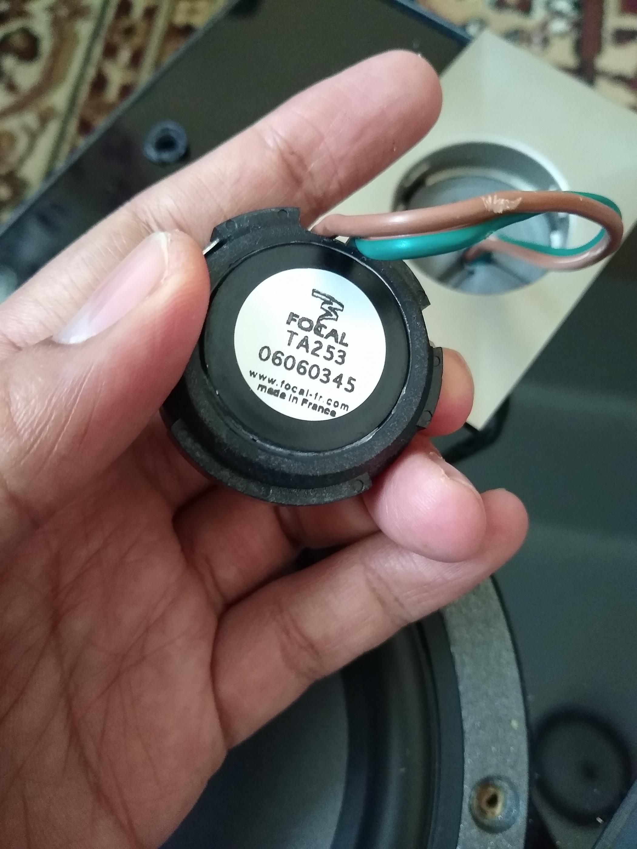

Wow You are a speaker saver 🙂 Thank you so much. This is very helpful. I finally did it!

I removed the tweeter from the center channel 800CC and put into the 826 V . I tested them both speakers worked fine. So replacing the tweeter should solve this. Like you said, I am hoping focal still have them is stock. Finger crossed 🙂

I have opened various speakers in last 10 years (Mirage/Energy/Definitive/Phase Tech), This is the worst design so far. It was really easy to take them out. But it was really difficult to put them back as the metal diaphragm is so fragile.If they don't have in stock, I will have to use the tweeters from surround SR 800 V. That is also painful because, tweeter housing design is different from the front(826V) and center(800cc)
