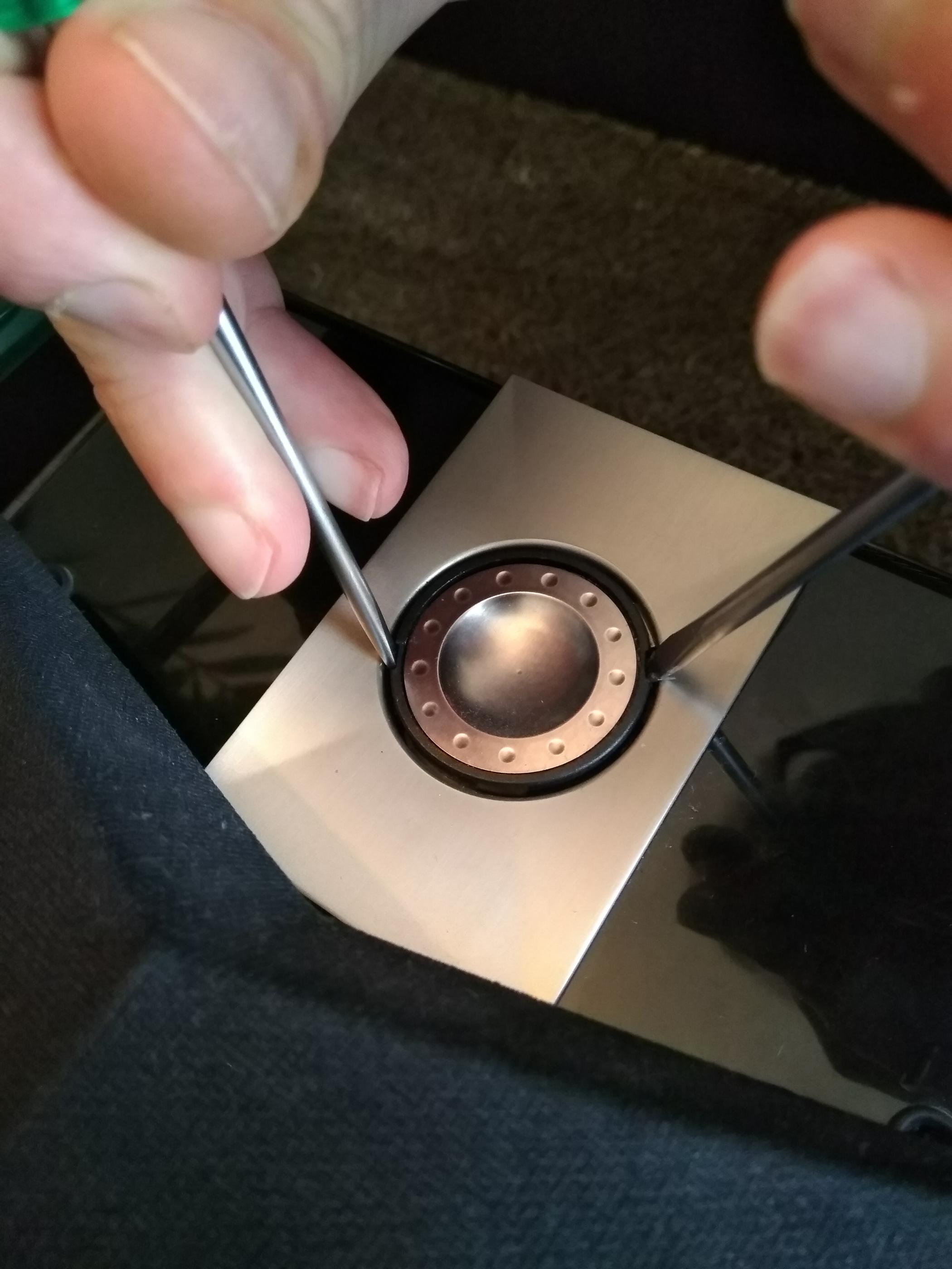

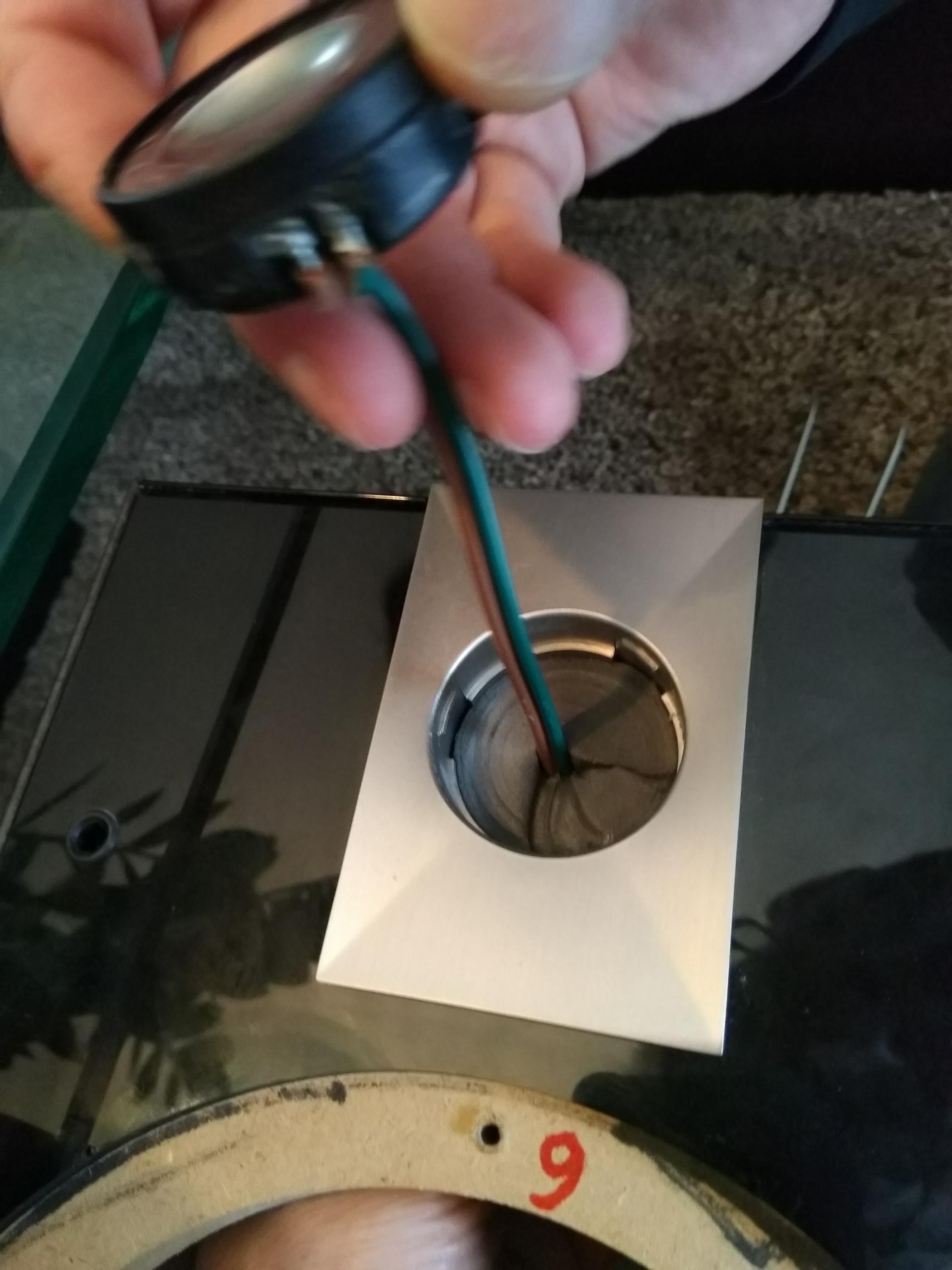

This is my first post here. I am no voice in building speakers. But I have replaced the drivers in my definitive BP2000/BP7002/SuberCube subs. I recently bought a pair of Focal 826 V speakers. I could not listen to them when I bought them. When I got home and listened to them, I noticed both speakers have tweeter blown. I tried to get the tweeter out by one of the forum member recommendation(using two screwdrivers) and I failed ultimately and damaged it 🙁 . My plan is that remove the tweeters from 826 V and replace them with SR 800 V (surround) tweeters. If anyone can explain the process of removing the tweeters, I would really appreciate. I have attached some photos.

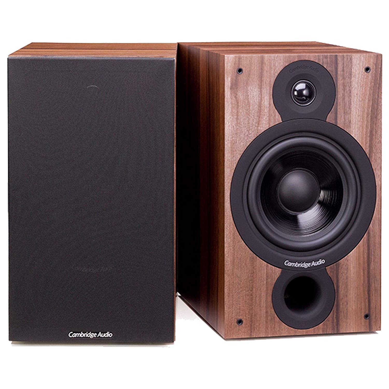

It looks like they did the same thing Cambridge Audio did on my SX-60s... they glued the tweeters to the front of the cabinet, in a custom dress piece.
The first day I had them one of the speakers started rattling. When I pulled off the grill to check, the woofer dress ring fell out. Then when replacing the dress ring, the tweeter popped off the front of the cabinet and ended up dangling by the wires.
Contacting CA left me pretty flat, they didn't sell "those parts" separately.
I eventually solved the problem by drilling the tweeter's dress flange, putting in screws and tossing out the woofer dress rings. Not quite what I paid $450 for...

This is how I tried and failed.

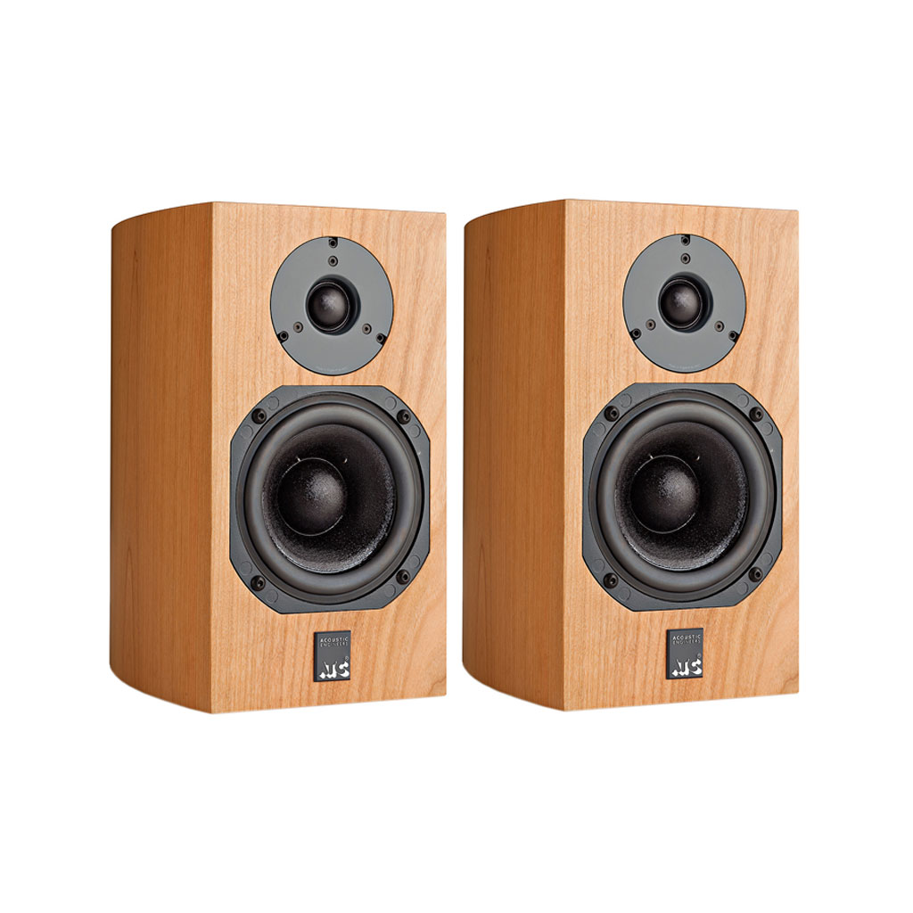

All speakers should have visible screws and bolts which you can tweak (just like the ones in the attached photo!). 😉

The CA SX-60s can be seen HERE My review is there too...

What is the bonding agent? If it's glued to the cabinet, I would get under that bracket with a flat tool and try lifting the entire thing off the case. Once it's off, Just grab the tweeter with some channel locks and twist...
Mounting a new tweeter will depend on what you buy to replace it, but I would not be shy about drilling a couple of holes and modifying that bracket... two to mount the new tweeter and two to mount the bracket back on the cabinet.
At least then you will not have this same problem twice.

Wait a minute ... comparing your picture with the one from the other thread suggests there is a dress piece on top of that tweeter... The later picture shows tabs inside the dress plate. I wonder if they lock with the dress piece to hold the tweeter in.
What happens if you try rotating that dress piece?
