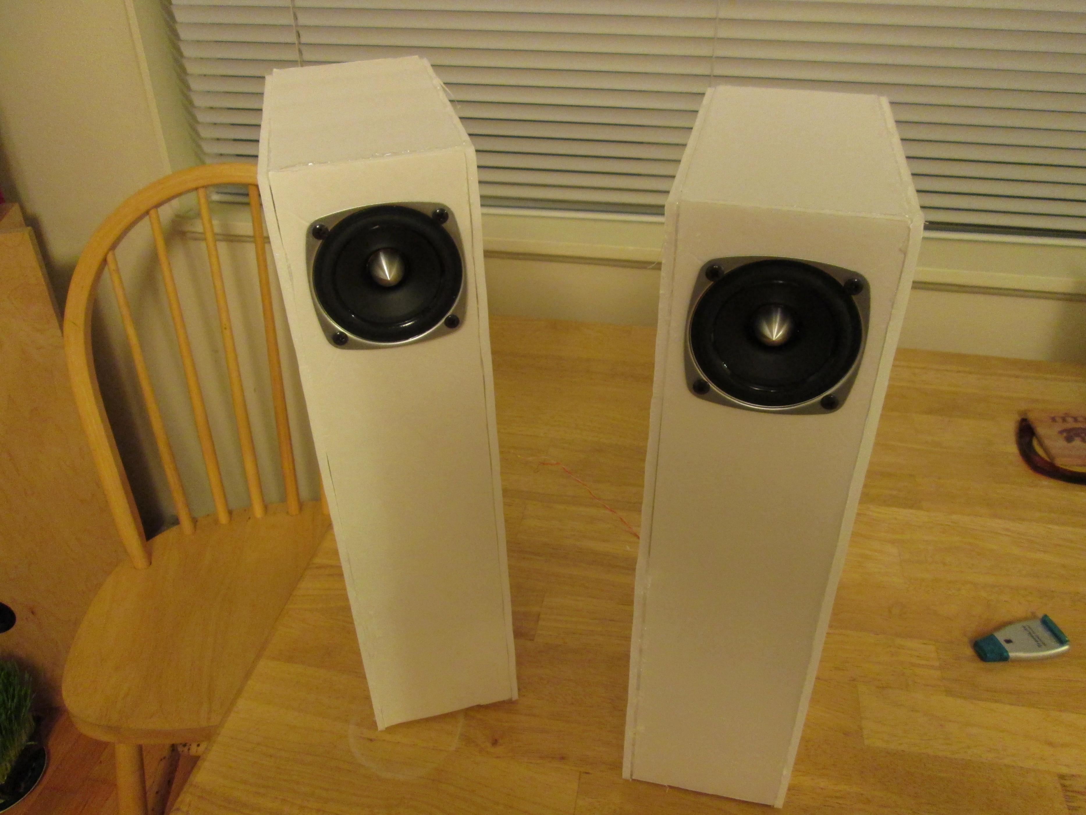

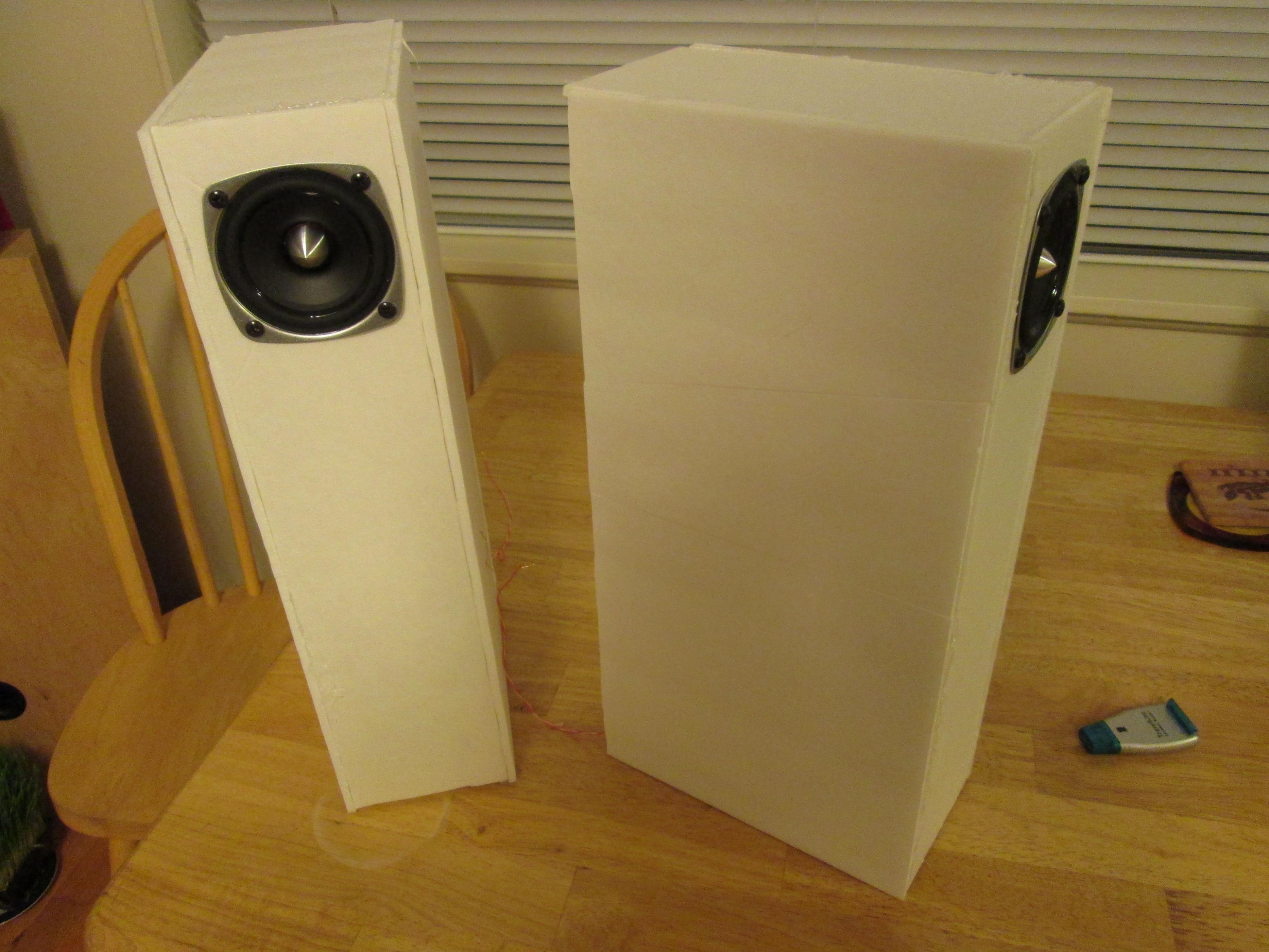

I like the foam FH3-inspired (FH3-i) speaker so much, I just ordered more Vifa TC9FD's and I have all the foam core pieces cut out. Just waiting for some time to glue now. I am wondering how to finish these boxes.... possible fabric covered?
On some songs, the deep bass really sounds good - you can really tell it has some deep extension. Can't wait to hear it in stereo. Like I said, I highly recommend this build. It is very cost effective too.
Driver $12, 3.5 sheets of foam core $3.5, binding posts $3, glue $0.50. Less than $20 ea.

Is there much foam core "sound"? Honky, rattles or resonances? If your foam core looked better, would you use it?
Thanks!
For the Cornu and FH3-inspired horn (and all of my other foam core speakers), I do not hear any rattles or resonances of the foam cabinet itself. However, you can feel that the foam core is vibrating and thus, there is probably some low level acoustic output - but it doesn't seem to detract from the overall sound. Use of bracing is important, for the Cornu, the spirals act as bracing for the baffle. For other box shaped designs, I add bracing wherever the span feels like it is more than 3 inches. This helps keep the structure more stable and prevents it from resonating too much or collapsing if you push on the wall too hard.
