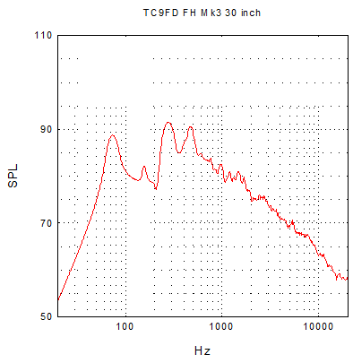

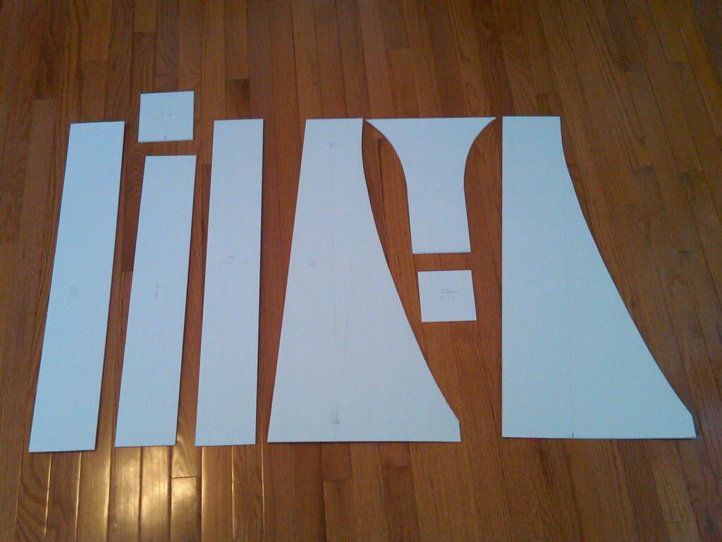

I finally had some time to lay out my homage to the FH3 in foam core. I scaled it to 30 in tall and internal cross sections scaled relative to TC9FD driver Sd. This gives cabinet dimensions of 4.5 in wide x 5.0 in deep (internal dims). Terminus height is 1.33 in and I plan to flare the back horn out in a smooth expansion to 12 in wide. This serves to provide built in stabilization feet and gives horn more lateral expansion. It increases final horn's expansion ratio by almost 3x, hopefully this will boost the weak bass from the tiny 3.5 in Vifa. As usual, cutting or scoring the wings on the horn allows a nice smooth compound curve that looks great and will be quite rigid once glued. I just have to find a bit of time to glue now. I sim'd this in HR and got a reasonable frequency response curve showing the low bass peak at 73 Hz. There is a big dip around 125 Hz but that should be filled in by Vifa's natural peak there as fs is 125 Hz.
