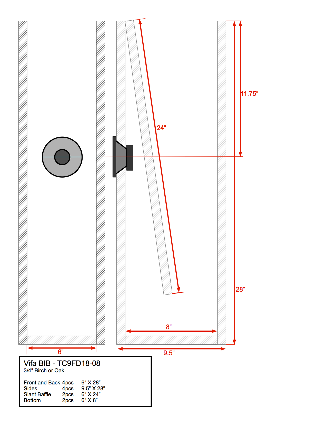

BIB with Foam Core and Vifa
I might try this next with the Vifa's and foam core - based on Jhutka's build in wood and burlap.
diyAudio
The box will be 27 in tall and 6-3/8 in x 8-3/8 in deep assuming 3/16 in thick foam core boards. The 27 in height is perfect as it is under 30 in length of Dollar store foam core stock. 😀
The BIB Calculator (xls spreadsheet) is available here: diyAudio
diyAudio

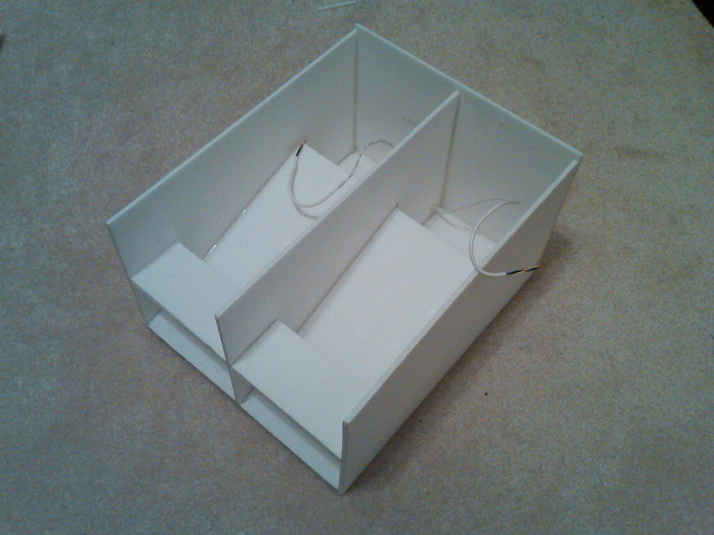

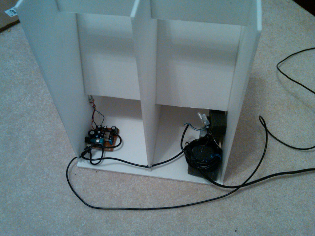

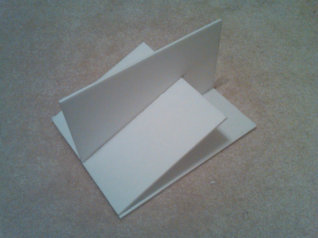

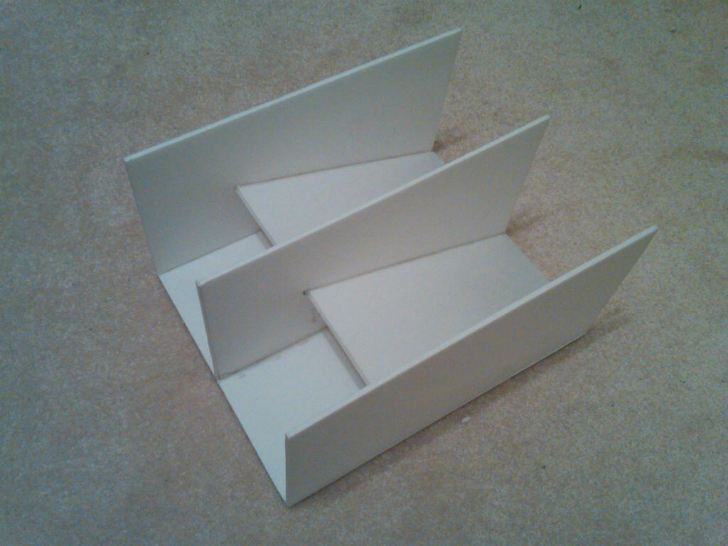

Micro Stereo BIB - new build
I had left over cuttings of foam from the last horn build and decide to make a little stereo mp3 player box with some drivers and amp pulled from the Logitech S120 pc speakers. I was inspired by Jhutka's little Vifa BIB and wondered what it would sound like if taken even smaller. Using the BIB calculator spreadsheet, I plugged in the Fs, Qts, and Vas for a Visaton FRS5 which I think looks closest to the drivers from the S120. The calculator gave a box size of 5 in x 7 in x 13 in tall with a 10 in long divider. I wanted to make a stereo pair so the overall box will be 10 in wide. Accounting for the 3/16 in thick foam cores, the overall dimensions were just a little bigger. The build was extremely easy and I can see why the BIB design is so popular. That is about as far as I got, I will fire it up and report on the sound later.
A very easy 2 hour project.
Update on BIB
The sound is very nice, too much bass actually, if that is even possible with a 2 in driver. I had to add extra stuffing all the way past the fold point to balance the sound. It's a very nice sounding mp3 player now. I can only imagine what the bass from an 8 in driver and 72 in tall cabinet sounds like.
