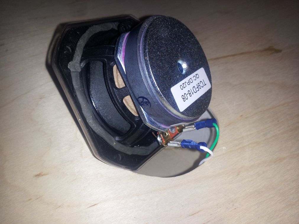

😀😀😀 "What He Said" - Simply amazing sound from a tiny 3" driver. I haven't even put anything in the horn yet and just plain got a great big smile as I shook my head in surprise. Any doubts I may have had about the wisdom of investing in some top notch drivers for these have been completely erased.

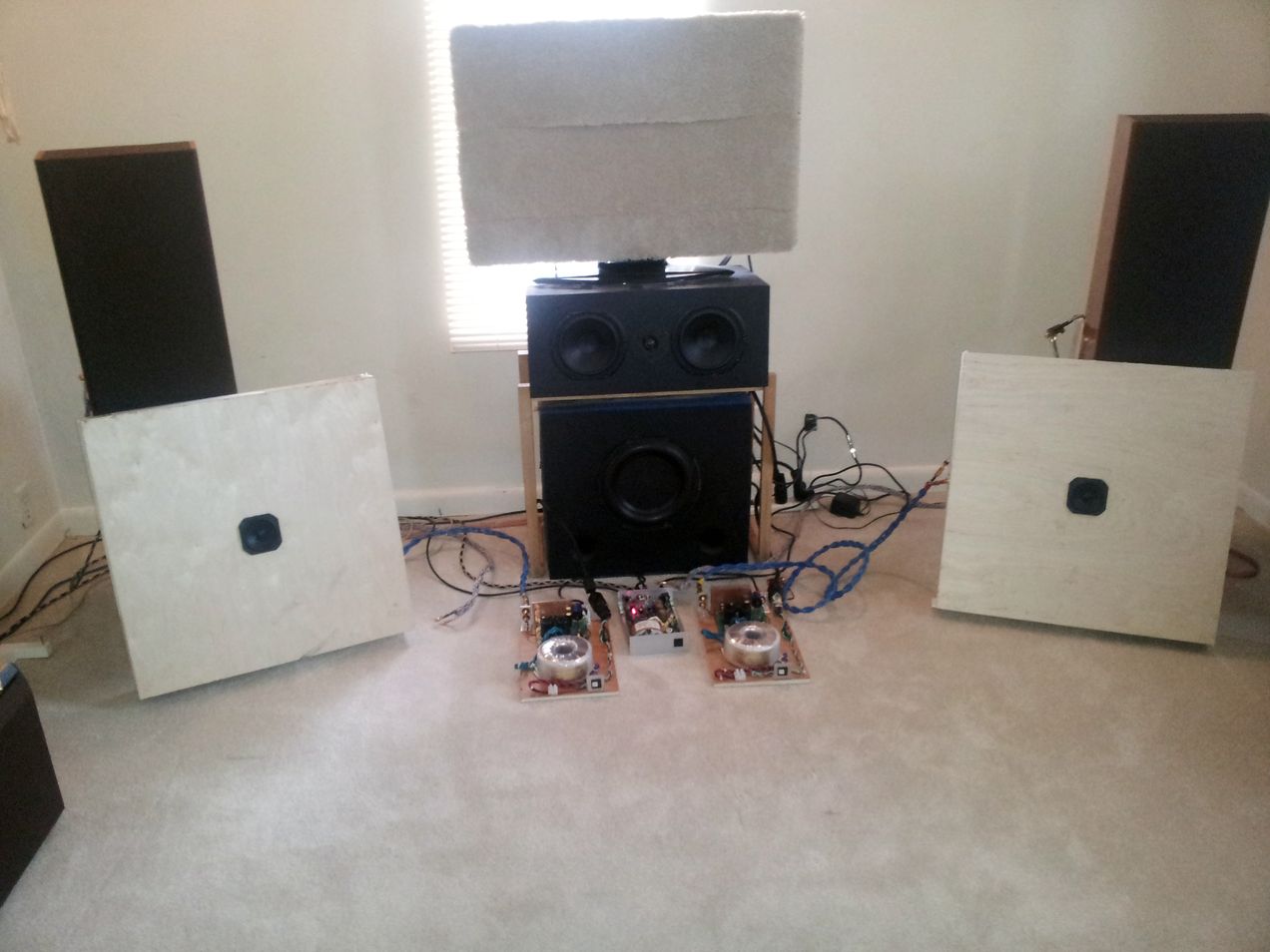

As in the picture, these are up against my favorite speakers - The Sunflowers - and though they fall short in comparison in the definition and sparkle at first listening, there is no doubt the Cornus could and will provide exceptionally good sound to all who attempt the build.
I am now at about $40 in this project and the Sunflowers ~ $450. It's a no-brainier for anyone wanting great sound at an unbelievable bargain.

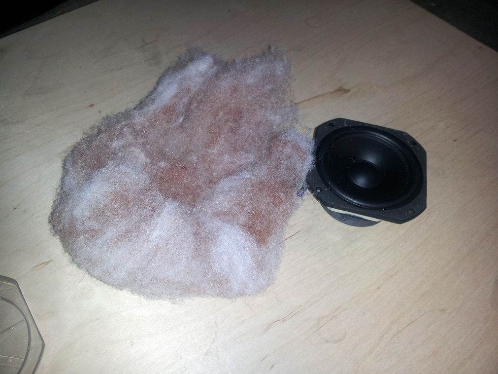

I'll be stuffing and tweaking for the rest of the day. Thanks Xrk and Cal for the support and enthusiasm, 6L6 for pointing me to the thread in the first place.

By the way, I brought up this design with my audio engineering teacher and he pointed out a problem with the design that could possibly be fixed with little trouble. He noted that the shallowness of the speaker is going to lead to a cancellation around 2k from the bounce off the rear wall. His hunch appears to be backed up by a couple of passages in the 6 moons review:
The solution, if there is one, might be to simply place a sound-absorbent deflector behind the driver. I might experiment with this."When the Cornu CS was on display at the Triode Festival 2004, it was equipped with a plastic front horn. Daniel was not secretive at all to reveal that there is a frequency response dip below 2000Hz and that the front horn was meant to remedy the problem acoustically without electronic filtering....
...Said dip was clearly visible in all the measurements I made. Judging from the window of this depression, it could be explained by diffractions and internal cabinet radiation."
Wait till you hang it on the wall! Even more amazing. I am glad this wrked out for you. So it looks like little Vifa works in a 24 inch x 3.5 in thick cabinet beautifully.
This explains the nosecone placed behind driver in patent drawing. I made my left and right cornus slightly different: I have a sandwich of foam and plumbers' putty in the back of one. Maybe it will show up in a measurement?

Depending on your tastes, you may find it a little boomy when it goes on the wall but you said you have a good supply of pillow stuffing to add if needed?
Almost a bushel left. PE just lost a stuffing customer. 🙂
