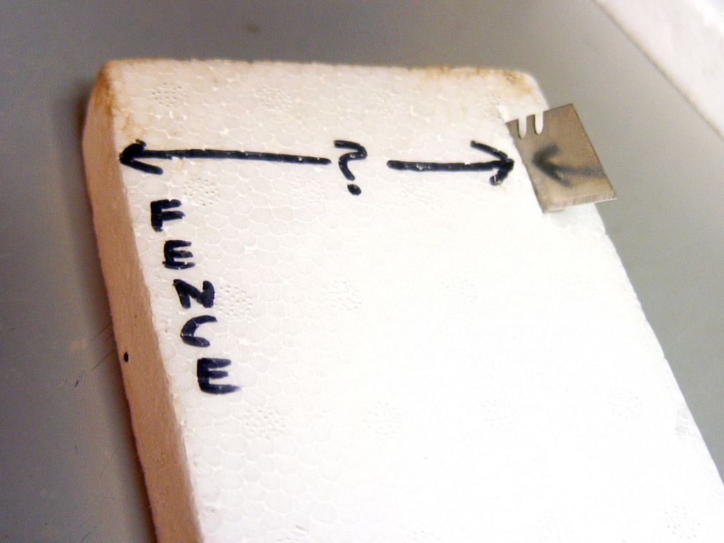

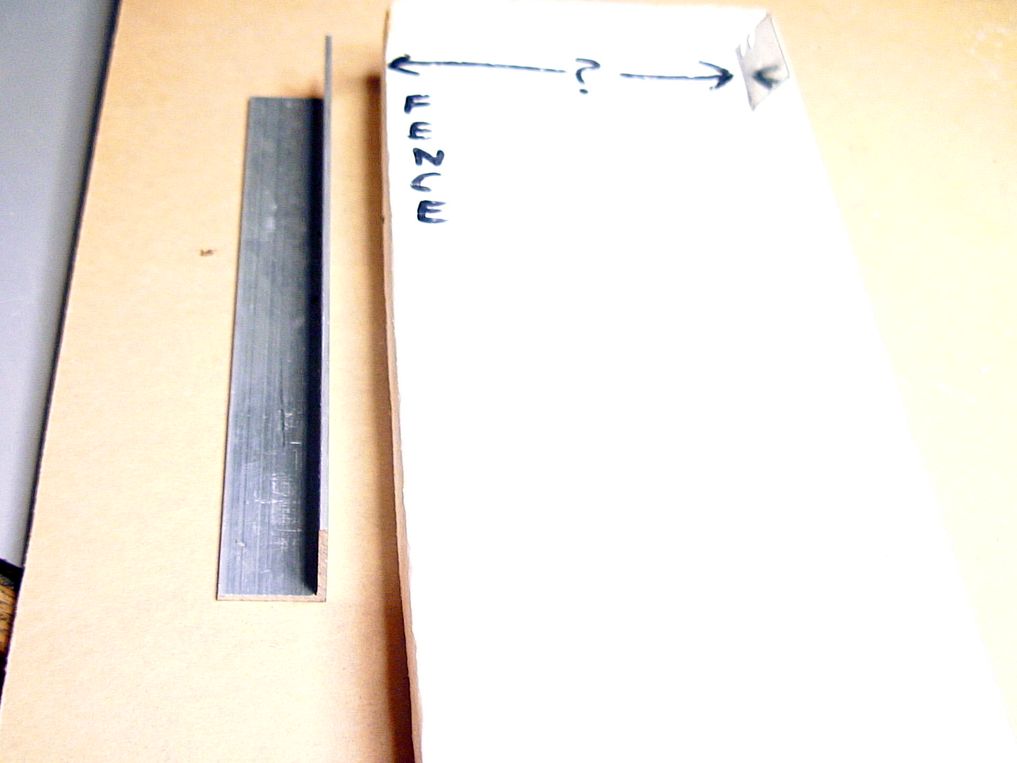

ooh, ooh I just got an idea. If I use the table saw as my foam cutting jig it might save me a few minutes building one. I can use the fence as my stopper and the edge of the mitre gauge channel for my cut. 🙂
Sounds like a good technique. You could also use an embedded blade (with proper safety considerations) to hold the blade at 90 degrees. Styrofoam really grabs the blade but tape or glue could also be used. Running this jig against the fence sounds good to me. The same type of blocking can be used to make about six very uniform simultaneous bending cuts in a single stroke.
I love the idea of the tablesaw fence and one of the channels. Combine that with a T-square to help keep the blade straight and you will (hopefully) be unable to do anything but a straight and square cut. 🙂 🙂 🙂
6L6 - I believe you used the more expensive drivers. Can you give us a more detailed report of the sound you are getting?
Bob,
I don't get it. Do you mean that your styrofoam will hold blade as you push the foam core through it like a tablesaw?

Bob,

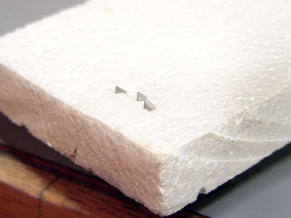

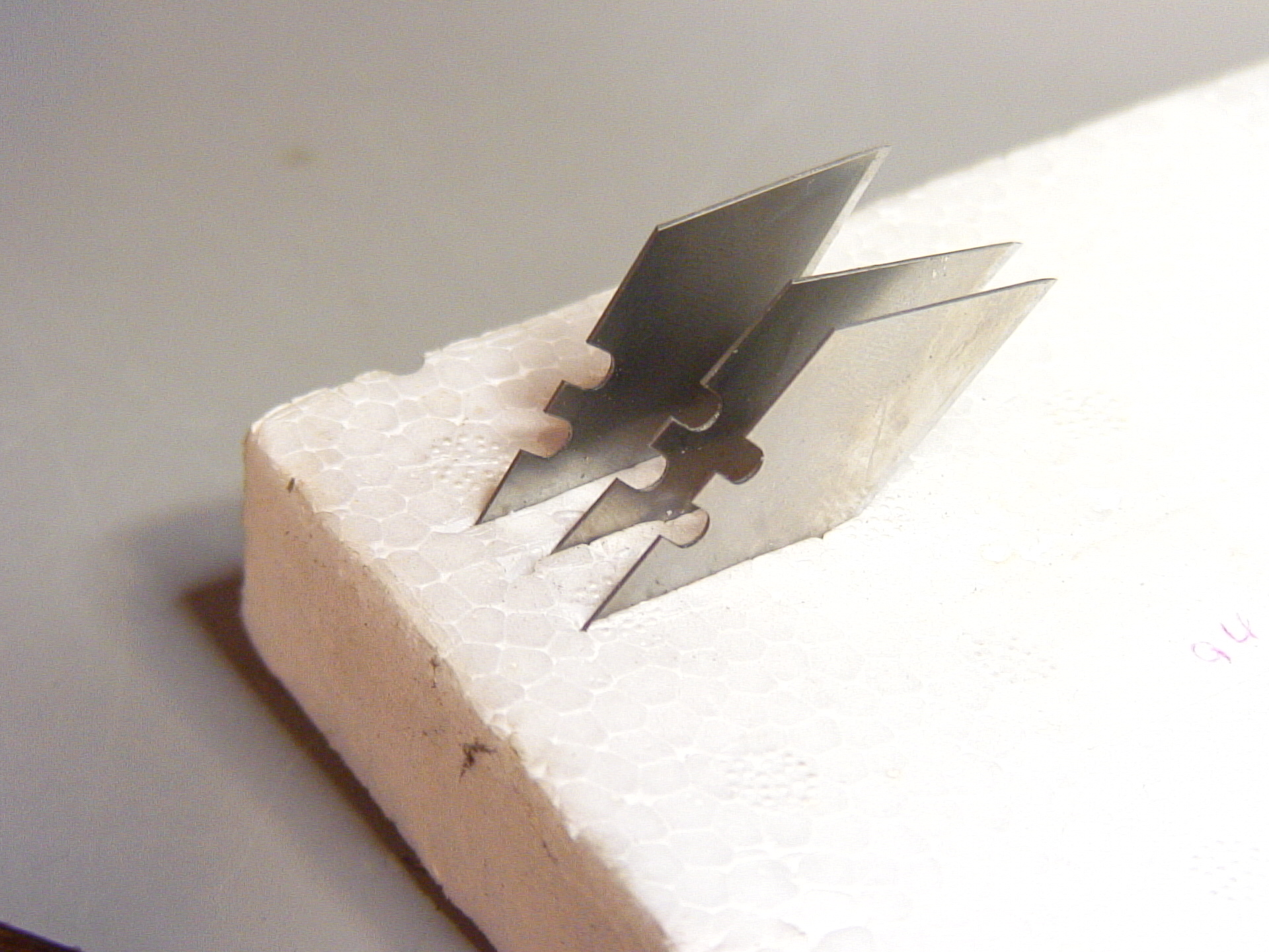

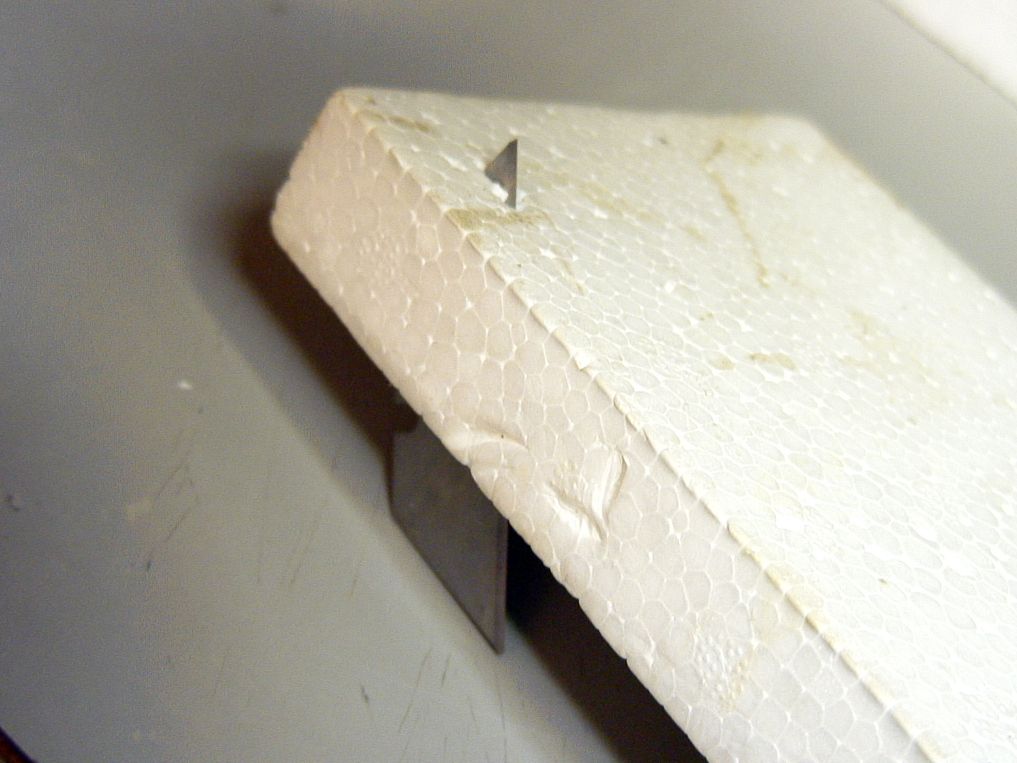

Here you go. Cronus in background. 😀
Blade & Block
Sorry for the lighting. Just used double sided tape on the angle.
