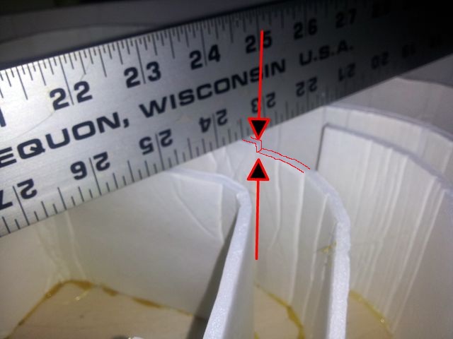

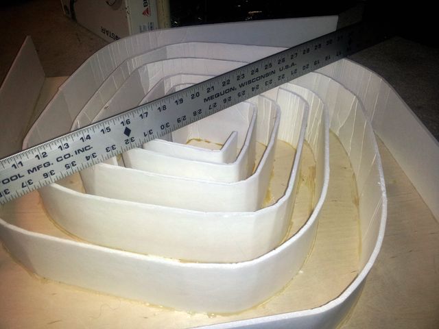

Ok, I had a bit of time to work on the second box today, all it needs is to be sealed up with the top piece of wood. I will hopefully do that after dinner and my QC guy is in bed.
Concerning time, it took about 40 min, maybe a bit less to go from the first photo to the second.
My strips seem to be a little uneven. How precise does the cutting need to be for this project? I'm worried of my front panel appearing "wobbly." Should I go buy a drywall T square to assist the precision of my cuts and try again?
I hate to show my substandard quick build after 6L6s latest posts, but the pics may be helpful. Before gluing the top I placed an aluminum yardstick across the partitions to check uniformity. I found several spots that never would have sealed even with the expansion of Gorilla Glue. Even though I used the same yardstick to cut the strips, just the angle of the blade can make a significant difference.
On the next build I will make a full sized thin wooden template to insure accuracy. I think 6L6 did that. I can fix these but won't have finished cabinets till tomorrow.

When I see strips that appear too shallow to seal, I lay beads of what else, hot melt, on the channel section in question to 'build it up' to the correct height. Check with straight edge after done. The pva will bond to hot melt bead and make good seal.

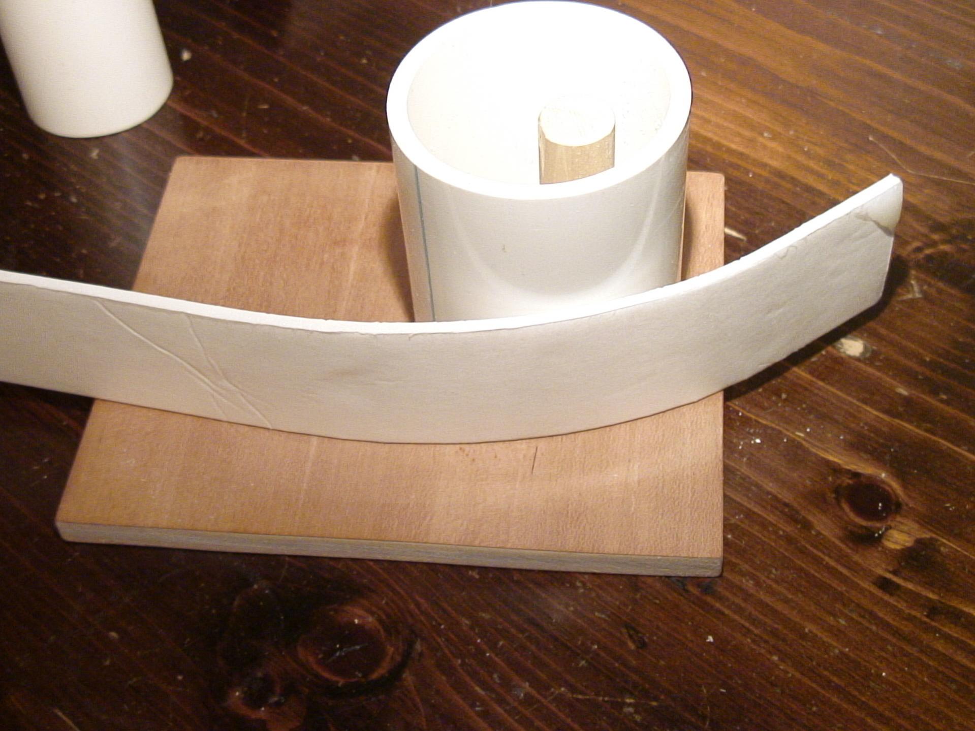

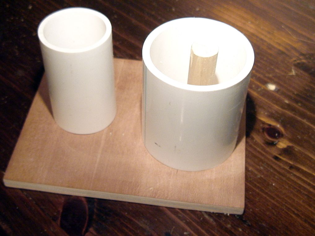

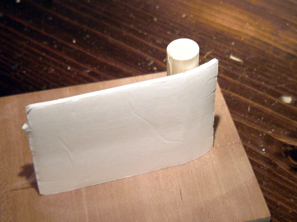

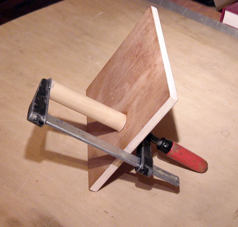

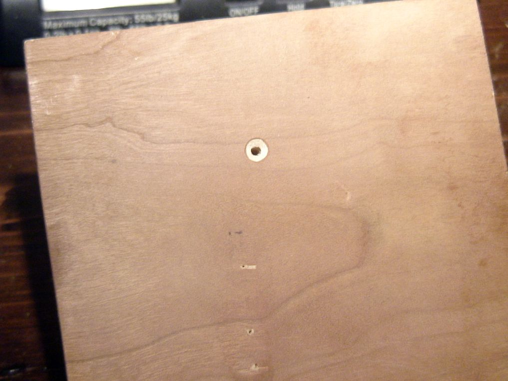

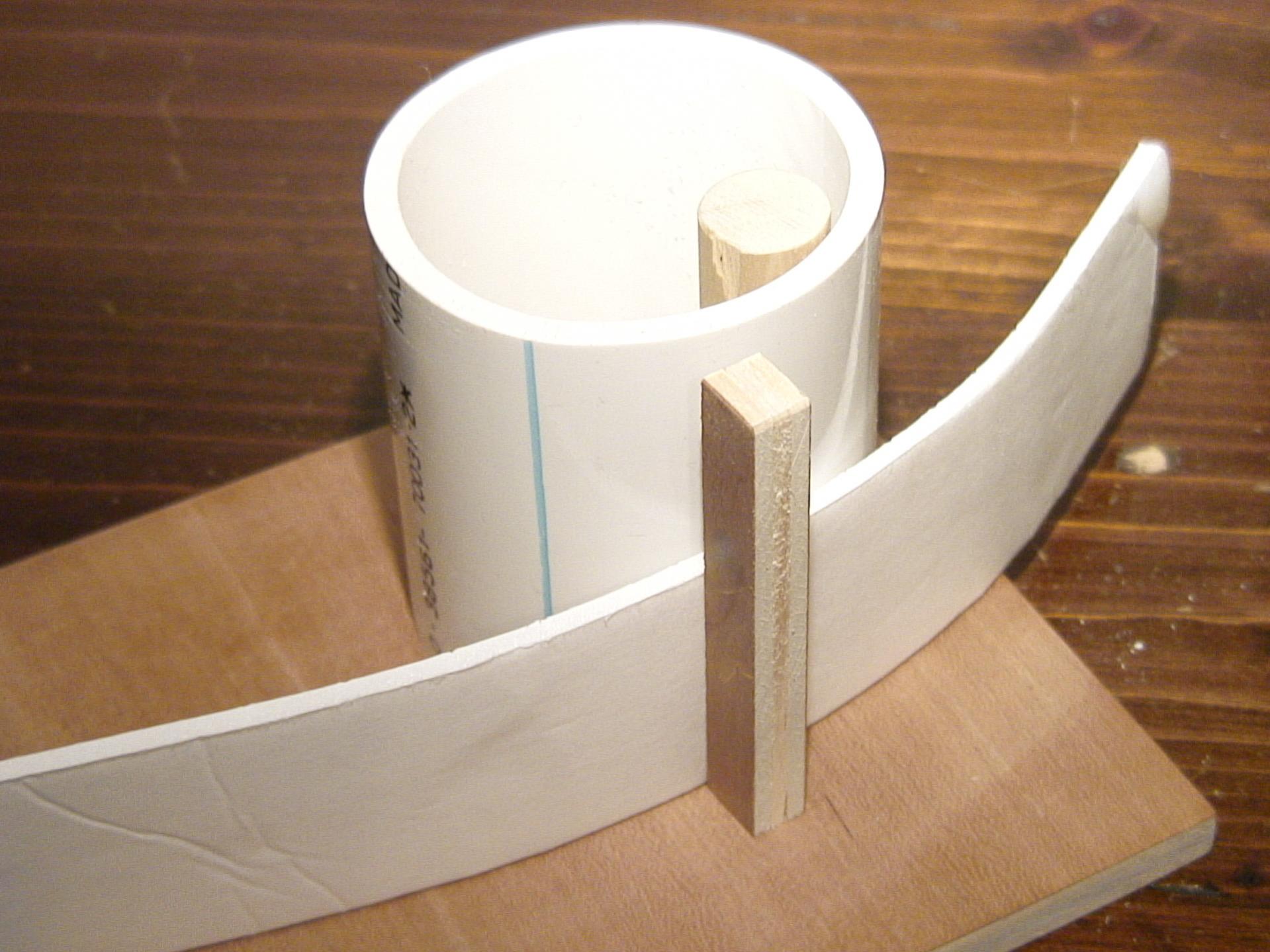

This is the rig I came up with. The three roller idea was just to complicated for possible/probable one time use. In the spirit of "K.I.S.S." I tried to think of materials many might have in the basement or garage.
1. A piece of 1/2' plywood - cut to any size that feels good. This one is ~ 6.5" x 8.5".
2. A 1" dowel glued, countersunk and screwed from the bottom. Could be an old broomstick.
3. Various diameter PVC pipe segments. These are 2" and 3" but there are a lot of choices available all the way up to 6". A trip to the waste bin at your local Home Depot plumbing department might provide what you need free or at little cost.
4. An optional second dowel can be added for stabilization. I say optional because the pipe segments wrap or crawl around the dowel as you shape. Whatever feel best for the user.
The smallest curves can be made using the dowel only. As with all diameters, can be formed by using your hand and/or the use of a flat of wood. In combination with the scores a very accurate and uniform curve is produced.
As a bonus - either cutting the dowel or making a mark to match the width of the desired segments. you have a built-in gauge to verify your cuts.

Nice work with the channel curvy bendy contraption. If this works well, you can try other materials for the channels. I have thought about using the large blades from a shutter/blind made of thin wood. I think a 3 inch blade is available. I know people return incorrect lengths to HD, maybe they will sell at good deal? You would have to steam the wood with a steam iron or something first, then run through rollers.
Hi Bob, Nice work on your bender but I can't help wonder if that's not overkill. Are you scoring the facer before bending? I found that multiple scores with the box cutter blade set at just the nib showing was so fast, so easy and all it took was rubbing it over the rounded edge of my kitchen counter to end up with a very tight curve.

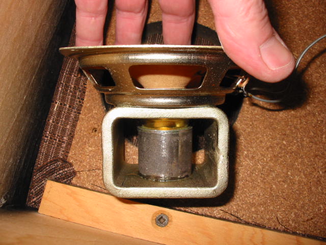

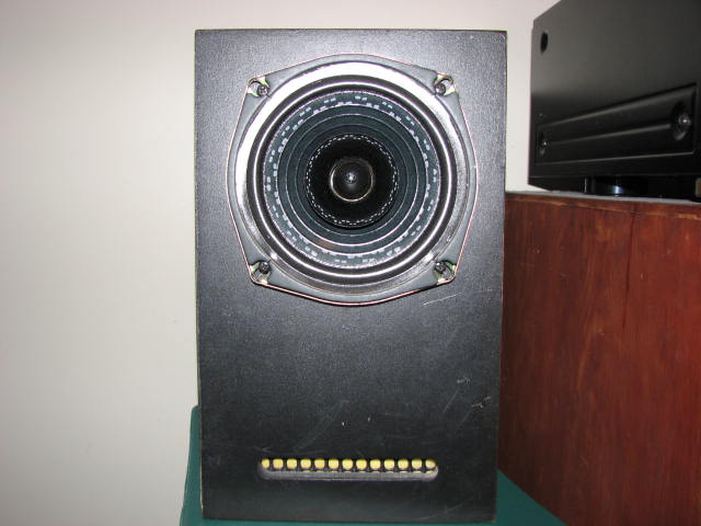

Cal,
So that BLH cabinet does not sound as nice as the Cornu? 🙂 The cabinet actually looks very nice, good thick, heavy birch plywood I can see. That's an interesting magnet yoke, I have never seen one that looks like that. I am thinking of trying the little TB 3 inch aluminum/magnesium driver (315e I think). Has a lower Qts which may help with too much mid bass problem, which I don't actually have a problem with on my build. Might be fact that I made my internal spirals with sharp corners?
