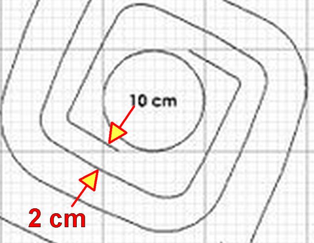

The measurement is correct, the points in the pic are in the wrong place. Sorry.😱
Fantastic, I should learn to not try multitasking at my age. Working on two amps and these speakers at the same time.

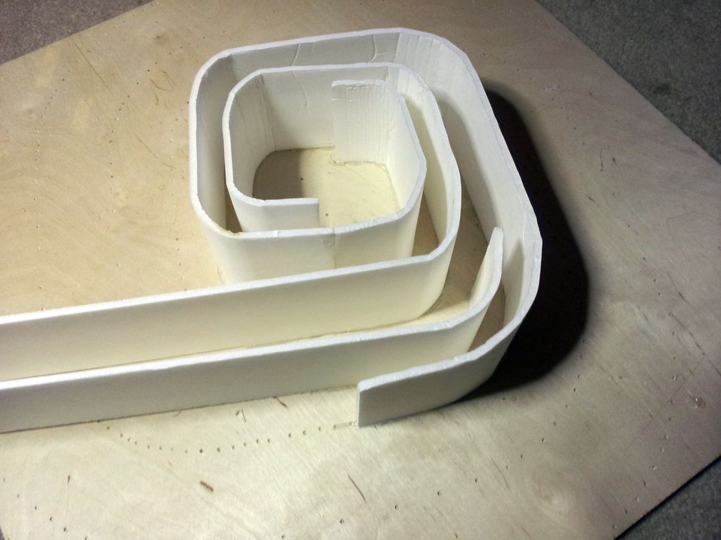

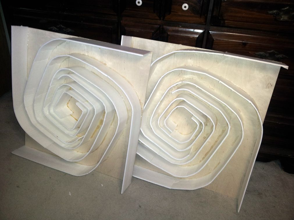

I think I did good. Waited till this morning and had both done in a couple hours. For the curves near the throat I scored the board and rolled it around the metal leg of a card table. As I worked outward only in-place scoring was necessary. I used clear thin packaging tape on the joints that were a little ugly.
I tried to always allow for a thin bead of hot glue on the outside of each piece as I worked so there is a continuous seal. There is a piece of tape on one throat to keep the 2 cm opening consistent but will probably be replaced with cotton thread at a couple spots.
The whole process was enjoyable and as stated often, the tricks of the trade come easy and fast. I was very surprised just how sturdy the build is. Word is both Kliscpsh and B&W have been watching this thread.😉

Great progress Bob! I am very interested to see how yours sound since you are doing the Vifa but with a deeper 3.5 inch channel depth. How did you hear that both Klipsch and B&W are watching this thread? Maybe they will realize that good sounding speakers don't need to weigh 200 lbs. 🙂 and cost as much as a small car.

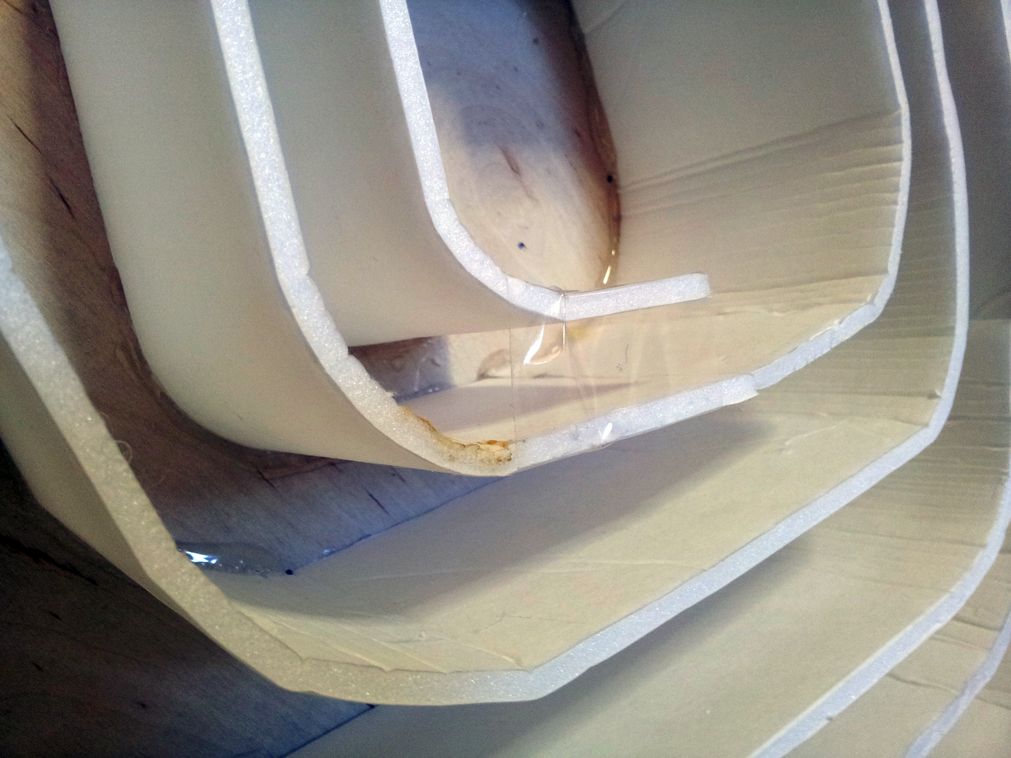

EDIT: Looking more closely at your photos I will strongly suggest that you remove the packing tape from the top edge of the foamcore - you will not get any glue to adhere to the packing tape and you will then have a leak in the horn.

...suggest that you remove the packing tape from the top edge of the foamcore - you will not get any glue to adhere to the packing tape and you will then have a leak in the horn.

Another thought (for a subsequent build) is rounding off the leading edges at the head of each throat. That may have been mentioned earlier but I don't remember seeing it. I'm considering using some of the small gauge Radio Shack magnet wire for the leads. I've made experimental 7' speaker cables from a single strand with surprisingly good results. I read it was very popular in Britain a few years ago.

Yes, please remove the clear tape, not sure why you need it. It will also buzz and make noise if left there. Upon looking carefully at your photos, it looks like you achieved the bends by indenting the foam core paper and not scoring it with a razor. It kind of buckles and does not bend smoothly when you do not pierce the paper when scoring it. Too late now but no big deal - just a clarification for other folks who have not started yet. With the cut scoring, you can literally get a perfect bend that will transition to tangent smoothly at the point where the horn mouth goes from curved to straight. 6L6 is being extra cautious by adding glue to the cut score lines to make it strong but probably not necessary. I also did not find it necessary to patch with paper and pva either - just a bead of hot glue on the butt joint is fine. Once both faces are glued on the structure will be very strong, I would almost bet you could stand on it and it will support your weight. I did not use plywood and my all foam ones could support between 70 and 80 pounds of clamping weight from dumbells and books.

The hot melt glue gun is CRITICAL for this project as it is the tack or clamp that holds curves in place while longer drying pva or caulking or whatever you use to dry. You can get a glue gun at Walmart, etc for $4. The glue costs more than the gun $6/bag of 100 sticks. I use the mini size.
You need quite evenly sized strips (+/- 2 mm deviation max) or you will have hard time with sealing face on in last step. Use a ruler to mark out lines carefully, a metal straight edge and a good razor to cut it. I lay it on carpet to cut and stroke the razor multiple times to go through paper, if you do it in one push, it will be jagged.
