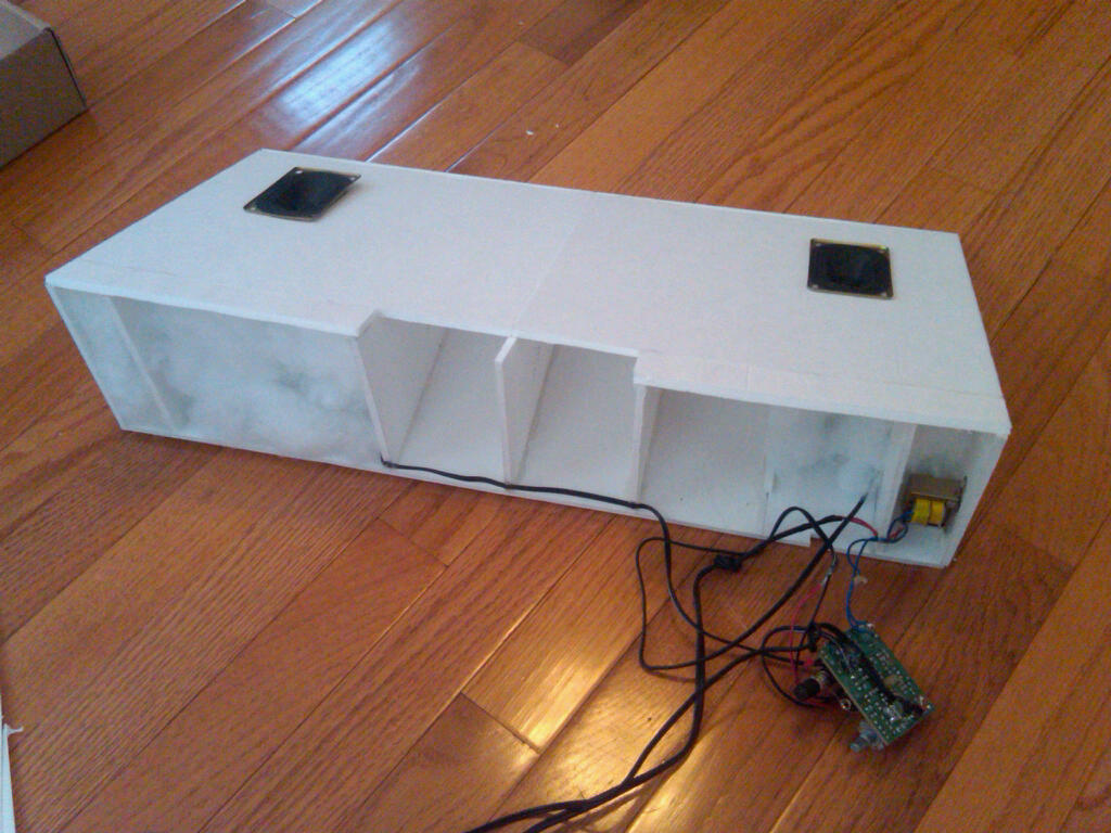

Based on comments that a pleated paper surround isn't necessarily bad, I went ahead with those cheap drivers into my 'Wedge' mp3 player stereo foam core build. Here is the box getting stuffed with pillow fill. The amp and transformer go into the right TL.

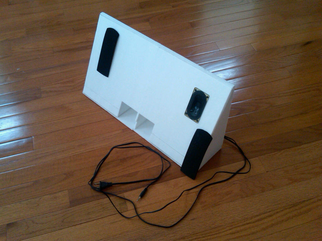

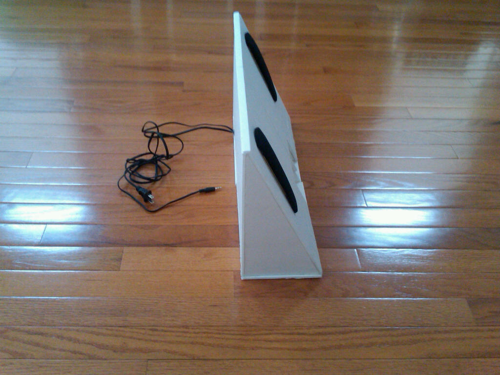

I finished the build of the Wedge TL mp3 stereo player using the cheap Microcenter drivers and amp. I put some magnets on the original grill covers to hide the ugly drivers. First listening impressions: not so good, I think I have to play with the stuffing but it sounds tinny, maybe worse than original plastic cabinets (which I modded with pillow stuffing so they weren't too bad). This also might be a case of the odd triangle shape of the TL contracting and expanding. Usually, a basic TL sounds better than tiny box. The form factor is convenient though and it sits nicely flush against wall on the back of a desk if your desk backs against a wall. I will post before / after sound once I finish tweaking stuffing - good or bad. I am hoping to make it the norm that folks share the sounds of their creations as well as photos. 🙂
