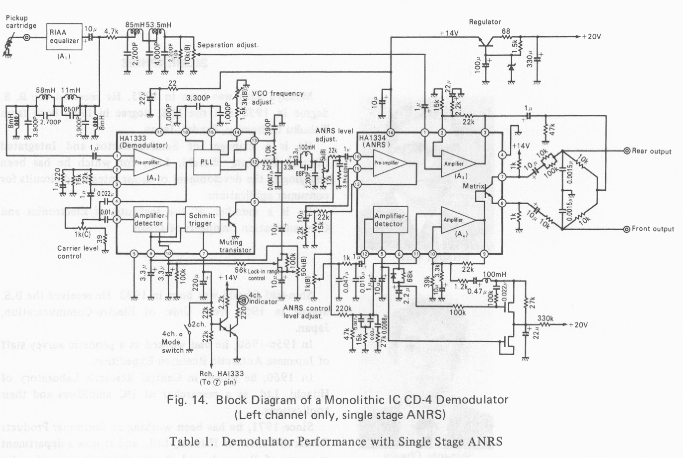

Toko uses tapped inductors in the mpx filter
