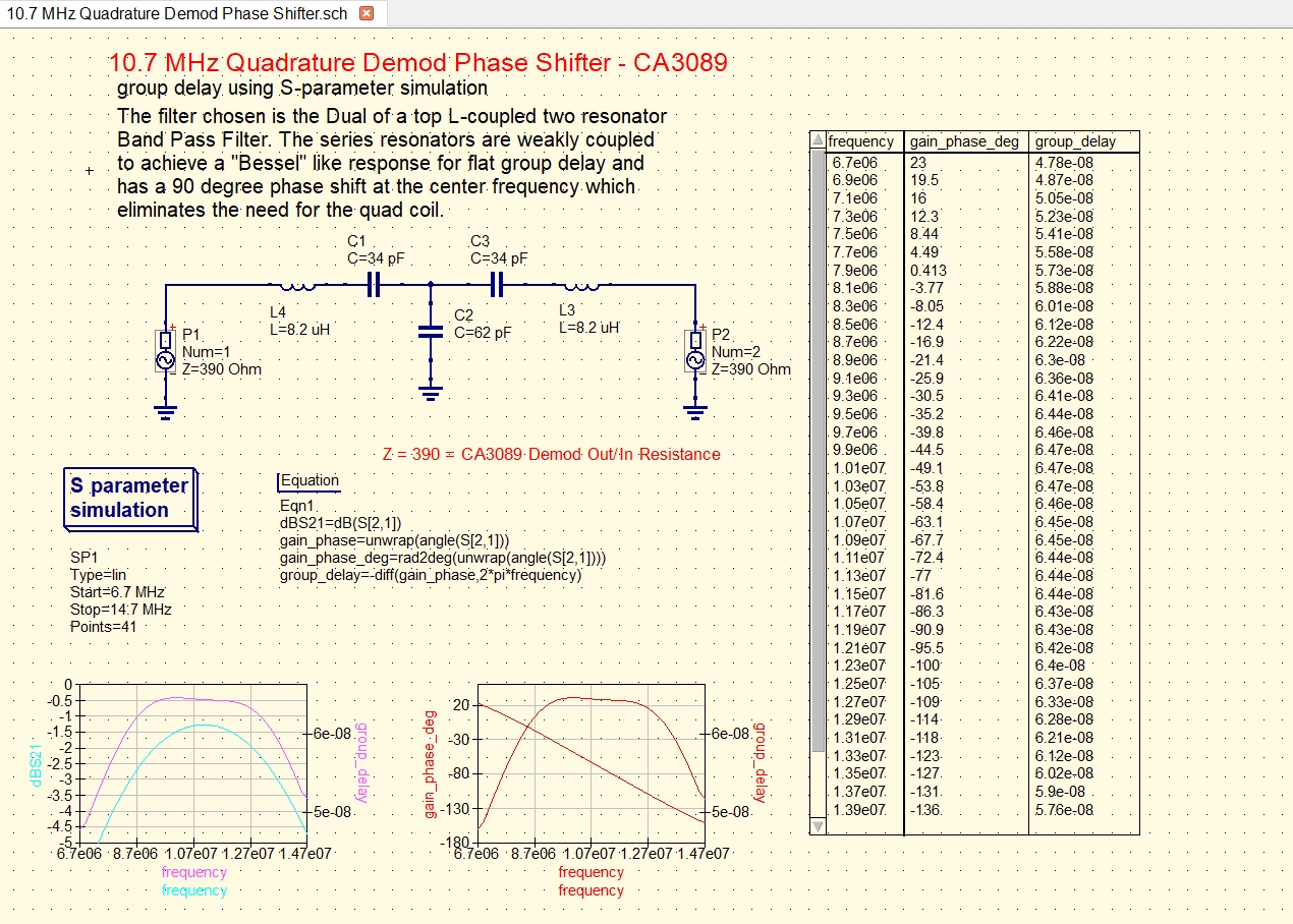

The key to good FM demodulator performance is preferably flat or as a compromise, symmetrical group delay of the IF filters and a very linear demodulator.

I published a Design Idea in the early 90's for a CA3089 based 10.7 MHz quadrature demodulator Phase Shift network. It had wider BW versus the standard "quad coil" circuit. Attached is a simulation done in QUCS.

The 5 pole Butterworth in the design uses all top-coupled capacitors. This guarantees the Group Delay (GD) will not be symmetrical thus making equalization much more difficult. I realize it was designed a long time ago and he was a grad student and text books at the time were lacking and computer time expensive.
In the 80's one would alter the design of the filter to make the Group Delay symmetrical thus improving distortion without GD equalization or even better with GD equalization. The goal is to have the number of zeros at zero equal to number of zeros at infinity. You need both capacitive and inductive coupling.
A Butterworth will also have crappy selectivity so it is not a good choice for urban environments. High end receivers in the old days would have 2 IF sections, wide and narrow. Any "new" design will only use ceramic filters. They have sold linear phase ceramics for a long time.
In the old days you would have LC Bessel designs for the wide and ceramic for the narrow. A commercial design for the wide LC BPF might use a Chebyshev design with GD equalization. The narrow would be ceramic.
