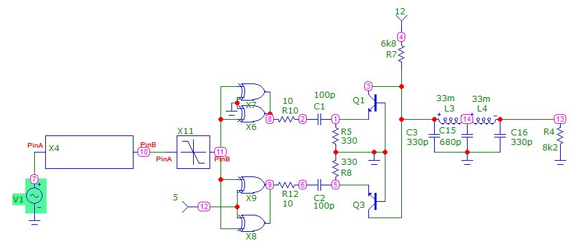

Anyone have a link to a better description of this FM discriminator?
HI if we try to get back to your original question, I was able to find this text which clarifies.
"This detection process can also be accomplished by combining, in an exclusive-OR (XOR) logic gate, the original FM signal and a square wave whose frequency equals the FM signal's center frequency. The XOR gate produces an output pulse whose duration equals the difference between the times at which the square wave and the received FM signal pass through zero volts. As the FM signal's frequency varies from its unmodulated center frequency (which is also the frequency of the square wave), the output pulses from the XOR gate become longer or shorter. (In essence, this quadrature detector converts an FM signal into a pulse-width modulated (PWM) signal.) When these pulses are filtered, the filter's output rises as the pulses grow longer and its output falls as the pulses grow shorter. In this way, one recovers the original signal that was used to modulate the FM carrier."

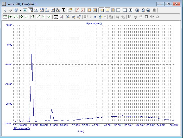

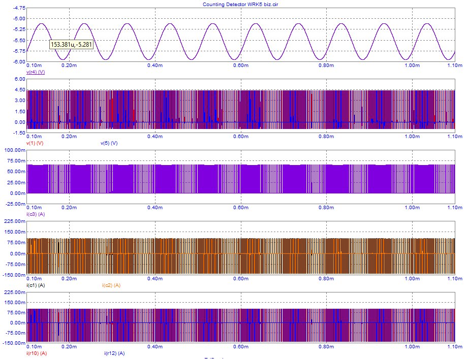

As far as I can tell, neither my colleagues' measurements nor your standard noise measurements say anything about whether the noise density at the multiplex signal falls off above half the IF bandwidth. Maybe your IBOC test does, directly or indirectly?
I probably mixed up the SMA100 and SMB100A. The SMB100A has a maximum FM distortion of 0.2 %, see page 20 of https://scdn.rohde-schwarz.com/ur/p...t_30/SMB100A_dat-sw_en_5213-8396-22_v0900.pdf , but somehow my colleagues manage to measure distortion levels well below 0.1 %. I don't know if they use the internal or an external generator (like the UPV's generator) for the modulating tone.
I’m not going to go into noise density vs IF bandwidth, it is obvious that you didn’t even checked the link I gave and look at the FFT plots taken from a low noise and distortion FM stereo generator and an FM stereo tuner that can take advantage of it. I have the same real measurements taken from actual FM stereo tuners that employ pulse count and PLL detectors. Not simulations and no speculations.
An FM generator has its own internal VCO linearity limit. Using an external modulation source with low THD like the R&S UPV doesn’t change this VCO linearity limit.
The likely reason your old colleagues can get lower than the 0.1% distortion limit of R&S SMB100A FM generator from the DUT discriminator is distortion cancellation.
You talk about colleagues measuring again, so you have very limited or no hands on experience to what you are talking about.
I did look at the link, but I didn't see a single plot of the multiplex spectrum in the 50 kHz...200 kHz range, only audio plots. Of course audio plots are all you need when you just want to determine the performance of the receiver, but it doesn't help much for the discussion about noise around the fifth harmonic of 38 kHz.
