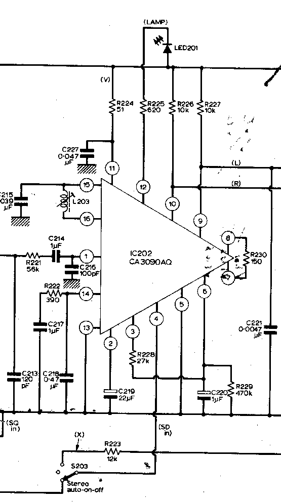

schematic attached
Schematic attached for decoder.
R226 and R227 do not go to 13v. They go from L/R to pin 11 of IC 202, the CA 3090AQ.
C227 is a 22 uF tantalum
R217 is 50K (and not 10K)
NTE equivalents of these ICs are NTE 788 and 789.

small schematic
I don't think this is going to be much use ....

Hi´Modder
Pls. send me your postal adress by email, and I send you a new Chip you can add to your tuner, a superb one 🙂, with the necessary diagram, the one you are using, the CA 3090, is a old RCA version, not the best 🙁,
If you want to use the old RCA type, then check the values of c213,c214,c216, if these values vary just a few percent, you will get a phase error, resulting in bad stereo, you can also try to add a trimming capacitor in parallel with R221, (philips green type 2-22pF), and then adjust slightly to get best channel separation.
In one of my earlier designs (For NAD S-400) this was added, and this improved channel separation.
Before change: L>R = 25 dB R>L = 42 dB
After change and adjust: L>R = 54 dB R>L = 56 dB
See example on att. file. for NAD S400

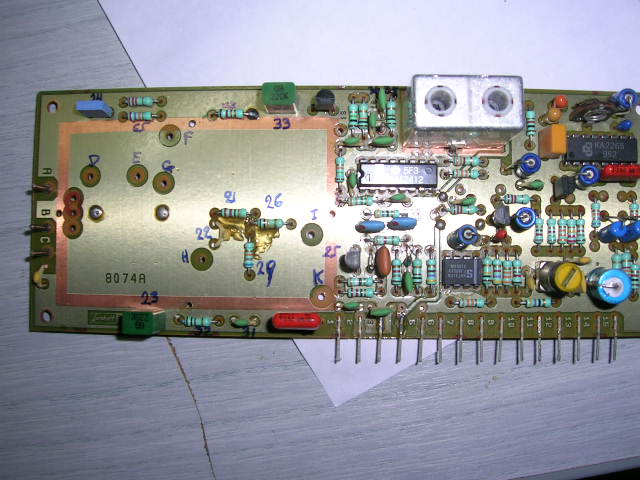

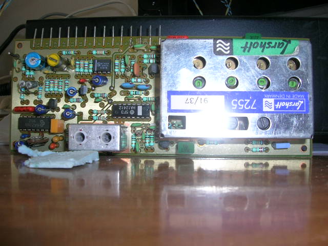

Hellow Forr and all
Tamas (Kiralyfalvy) did produce a kit with the KA2265. This was the kit LH7255. He was able to ship me the last completed kit he had.
