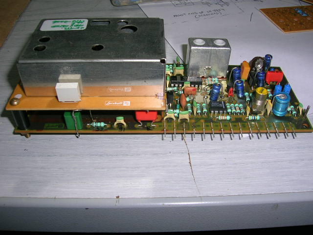

The "operation" is quite simple.
The "combo" provides the best of both kits: The overload-insensitive RF front end of the LH7254 and the better IF and AF-Stereo section of the LH7255. I enjoy it for a few months now.
If anyone is interested, you may contact Tamas for avaliability and price. He is a very helpful person, and although a keen proffessional designer, he does not hesitate to discuss in detail with amateurs (like me).
I can supply details for the interconnections if needed.
