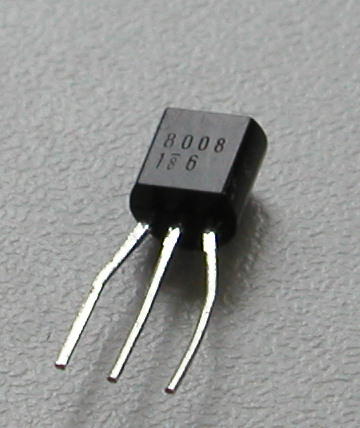

It was AN80xx regulator, when I tried it, that made me to prefer IC regulators over discreet regulator proposed by Elso, for instance.
I noticed them used by Kusunoki first, in his DAC, but for some reason he's using 78xx type of regulator on a DAC. But he's also using large cap as bypass on a DAC, and I prefer the smaller one😉
The AN8008 is from D-K and is made by Panasonic.
