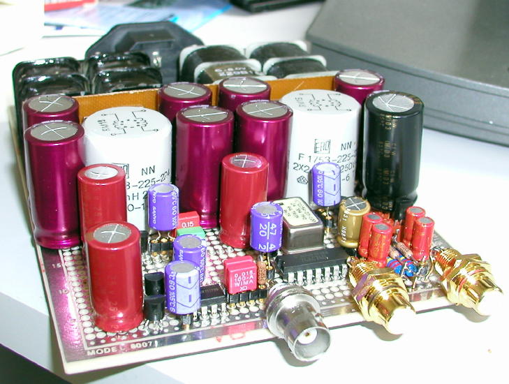

Peter Daniel said:Presently I'm using AN8008 (Panasonic, used by Kusunoki in his 3rd DAC) and I'm surprised with a good sound. I will also try LM7808, as Fedde reports it sounds good too.
I'm using 3K for I/V and 1k58 for reference.
Hi Peter,
Did you ever compare 8 versus 8.5 Volt? Or is the 8V merely caused by the use of a fixed voltage regulator?
What type and value BG do you currently use at the output?
Did you try different types?
Why do you use 3K for I/V? I saw that Fedde too uses this value. Doede however states that the optimum lies with 2.2K (for 1 piece of TDA1543). That is why I use 274 Ohm with 8 TDA's.
If 3K would be the optimum, I should try 375 Ohm...

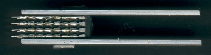

BTW, Soldering a DAC-Tower of 8 pieces TDA isn't that difficult.😀
Here is a picture of mine:
8V choice is made by use of fix regulator. Fedde suggested that voltage and I really like it now. Comparing to 5V, I had previously, it is more forward, detailed with better soundstage. 5V is more laidback, relaxed, smooth and toned down, but somehow less involving and colorfull. You could listen for hours to 5V version without getting tired, but it doesn't present anything that makes it stand out either. It's almost like comparing inverted and NI GC amp 😉
I made my choice for 8V supply and I'm trying to improve it further. BTW, if I'm not mistaken, 8V and 3K I/V resistors are close to what 47Labs using.
However I'm not opting for a simple supply, like most others do, but using 2 separate transformers with extensive CLRC filtering, and triplets bypassing. Maybe that's the key to good sound I'm getting from that DAC?
The output caps are 4.7 BG N, but I made an arrangement for super pair as well to see how it works.
Also, most other major parts are installed on sockets, so I can easily switch them and choose the ones that sound the best (all bypass electrolytics are done in that way).

After some trouble with proper voltage adjustment (it's not that easy in CLRC filter), I got this DAC running http://www.diyaudio.com/forums/attachment.php?s=&postid=327626
As you noticed I mounted most of the caps on sockets, so I can easily swap components and experiment with the sound. Although this is not Doede Dac, it is still TDA1543 based and my observations are as valid to other, similar DACs.
On classical and jazz recordings the first impression was quite positive, but when I switched to contemporary rock and country, it didn't perform that well. Comparing to my other DAC it was very muffled and sounded almost distorted. Well, I decided first to get rid of OsCons. I tried them before, and didn't like them that much, so here they go. The sound opened up a bit, but still not to the point that I'm used to. Another thing that I decided to let go is that famous super-e configuration of output 4.7 BG N. I tried to parallel those BG caps before, and they always sounded better in singles. So now, when super-e setup is gone, the DAC started to sound pretty decent. The fine detail and acoustics of the recordings are back and vocals opend up to the point that thay actually sound real.
I'm using 10u Gold Nichicons on all digital chips and 33u on the DAC. I will be getting type N 33u BG or maybe even Hi Q type (they are better, right? ).
Next thing to try out is different regulators on the DAC and finally reclocking and input buffering effects. Will keep you updated.
