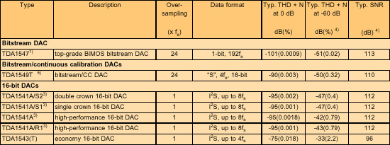

jean-paul said:Using a 1:2 transformer like the Minicircuits type has its benefits because of that, Fedde.
Well, yes and no. You can't raise the SNR ratio with the transformer (well, apart from some HF removal). So, still it is better to send out the S/P-DIF with a higher amplitude. But for the CS8412, the higher amplitude will be better. Still, it would be an interesting comparison to try 5V PP with no transformers and 0.5V PP with
BTW: I think the transformer is 1:4.
Yesterday, I was looking into this issue. I already realised that it will not work to send out S/P-DIF TTL signal and then also amplify it 4x!
