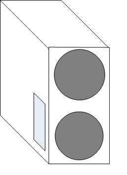

Hello John,
A while ago you wrote the following in a very interesting post:
The longer you listen however, the more natural this CD sounds. I am now quite convinced (2 months of listening) this is the way to go.
I would really like to hear your nao note, because it also maintains directivity in the bass mid region, something my system does not, and it keeps me wondering how much more improvement this will bring…
I have been fantasizing if it would be possible to cut large rectangular openings in the side panels of my speakers near the woofers, while leaving the rest of the enclosure intact (filled completely with damping material) As the enclosure are quite deep, my hope would be the back wave is sufficiently damped not to create problems and that the openings would create the acoustic shortcut at the lower frequencies, needed to control the directivity, in the region where the 12” speaker does not bundle on its own…
Could this ever work? What would be the best shape and size for the openings?
